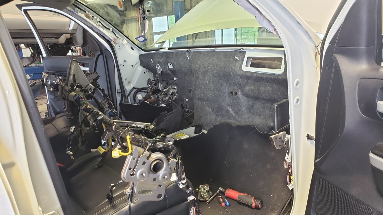

    It's quite a project to pull a dash if it's your first time, make sure you take lots of pictures and keep track of where connectors and grounds go.

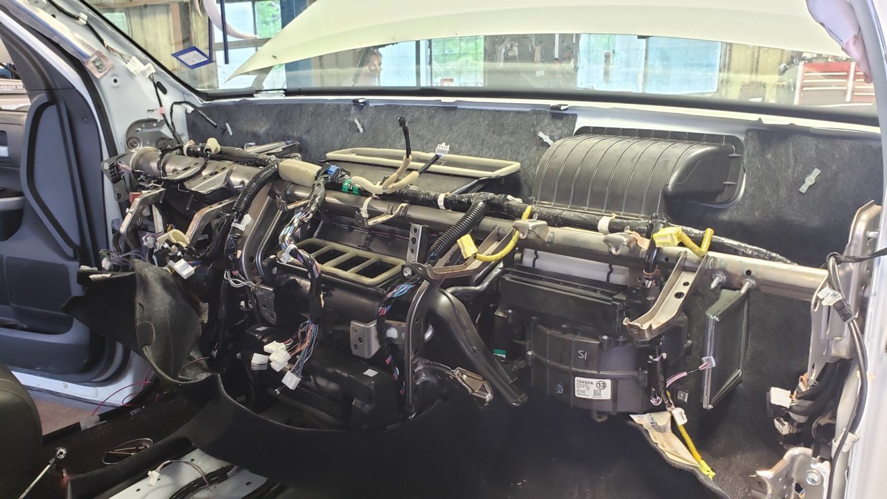

    To give you an idea here's a few pics from a 2nd gen Tundra I did a couple years ago, Tacoma looks to be similar.

    That one took me 7 hrs and I've done quite a few dash jobs although that was my first Toyota. I like doing dash jobs as long as they aren't toilets and/or the plastic isn't all brittle.
    If I ever get to do a Tacoma I'll be sure and document it for everyone.

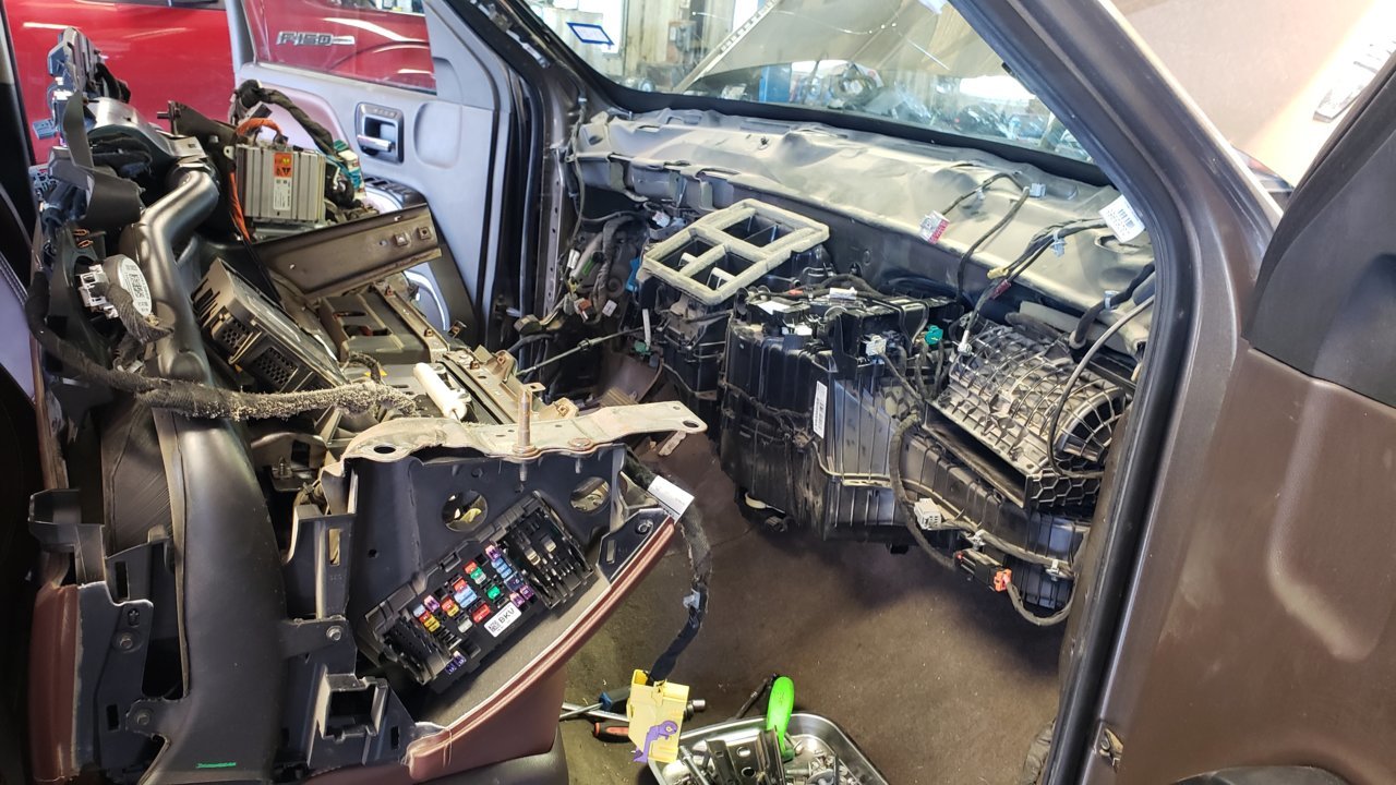

    Yea that looks pretty much like how that Tundra came apart.

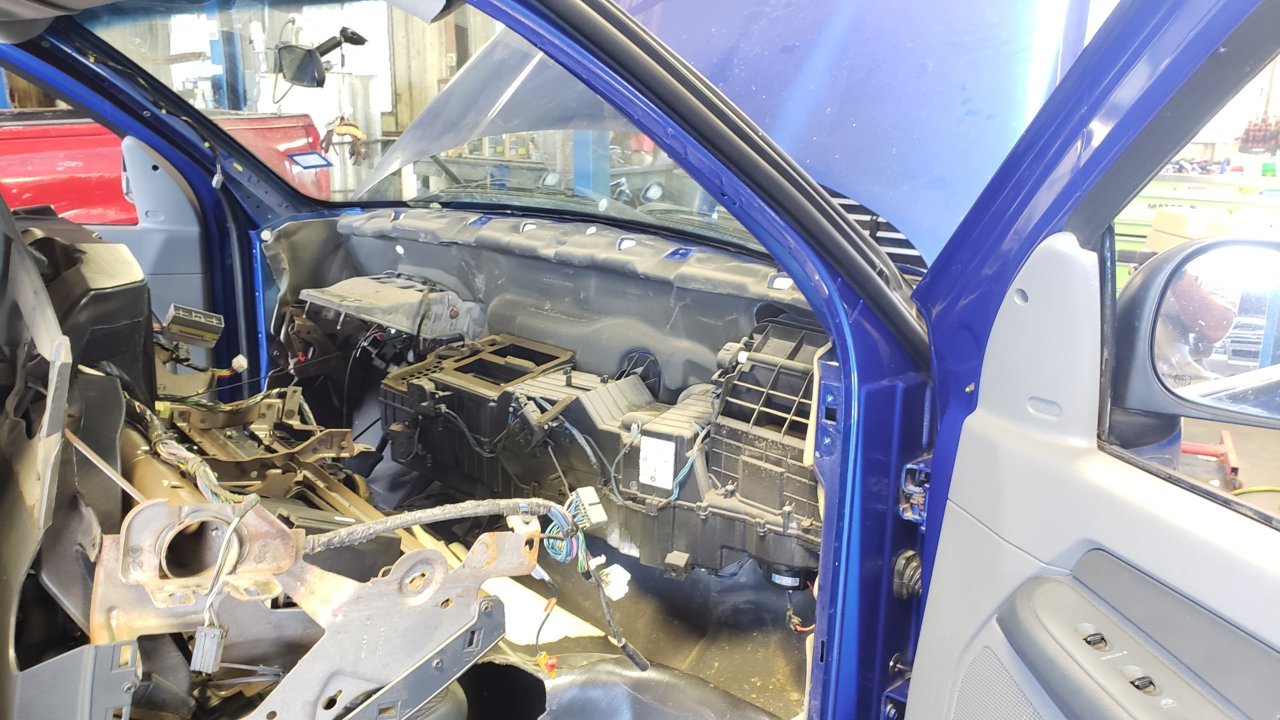

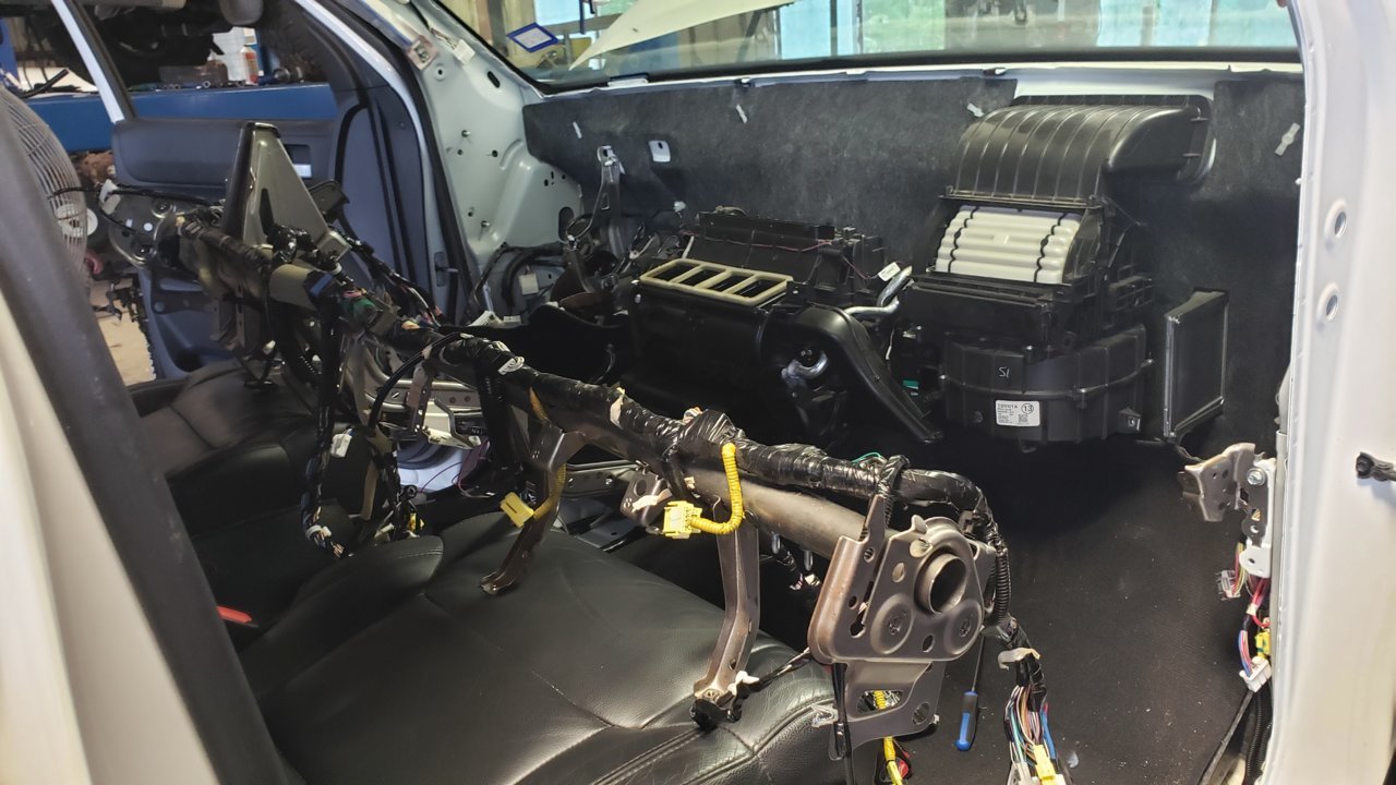

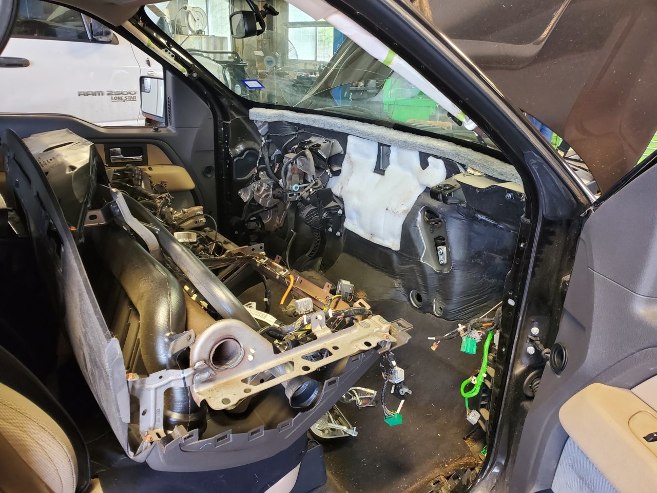

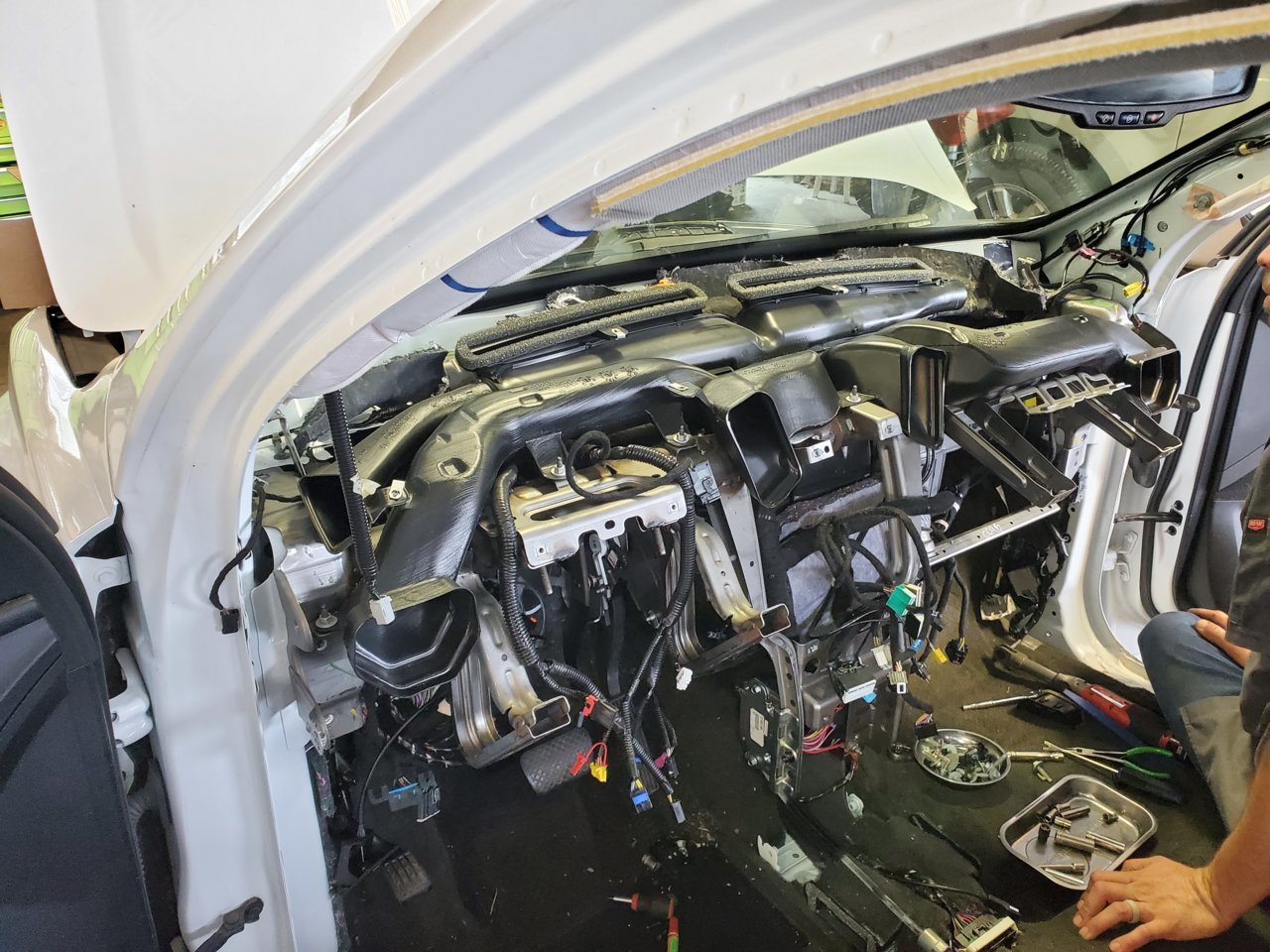

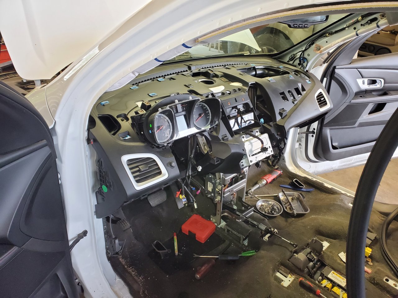

    It's kinda crazy on Ford, Dodge, and Chevrolet trucks you can remove the steering column and pull the dash as an assembly and lay it on the seat to get to the HVAC housing, on Toyota's you have to disassemble the dash to remove it.
    2013 F150
    2014 Silverado 1500

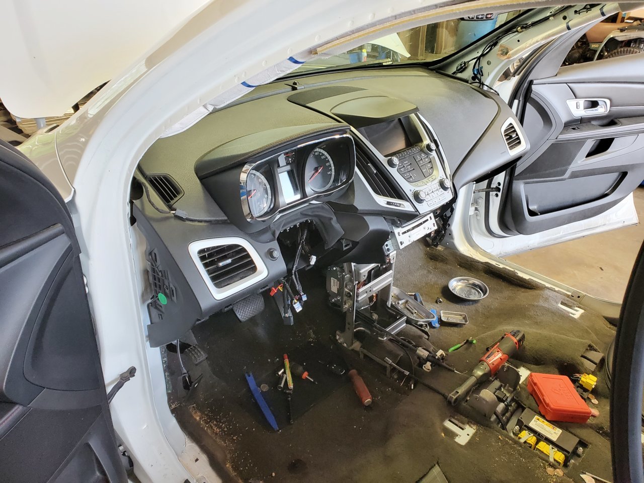

    The most complex one I've done to date is a GMC Terrain, literally had to disassemble everything.
