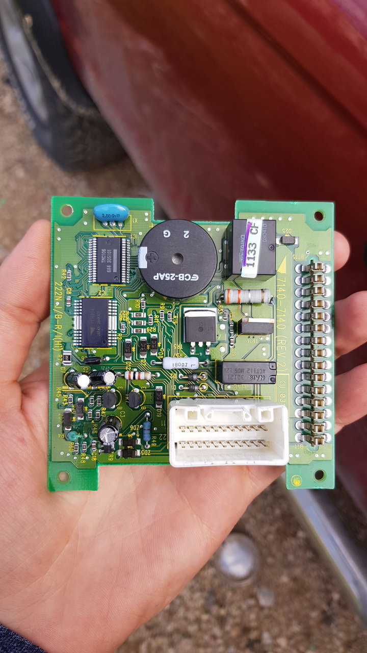

    Original issue is that my dome light doesn't work when the switch is in the "DOOR" position. Voltmeter at light shows zero power when doors are open. I read on a different thread Hajjar had the same problem and found a fried resistor on the circuit board. I've gotten to the point of removing (trying to) the board but there is a bank of 15 "connectors" seen here on Hajjar's pic on the right side (left side when board is in place). Is there a harness connection on those that could be keeping the board from popping right out? It seems that is the only place it's hanging up.
