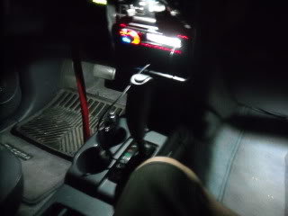

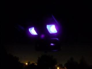

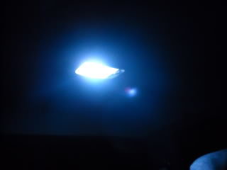

    i replaced my dome light with a bright white led and my map lights with 2 uv purple leds and they look great also i ha 4 streetglow micro strobes 2 under dash on each side one to light up headunit and one to light up back seats. its very cool and not too ricey leds off ebay and strobes off streetglow.com

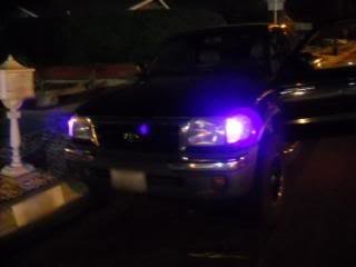

    ok here they are :)
    parking lights^
    dome^
    map lights^
    strobes (mid flash) ^

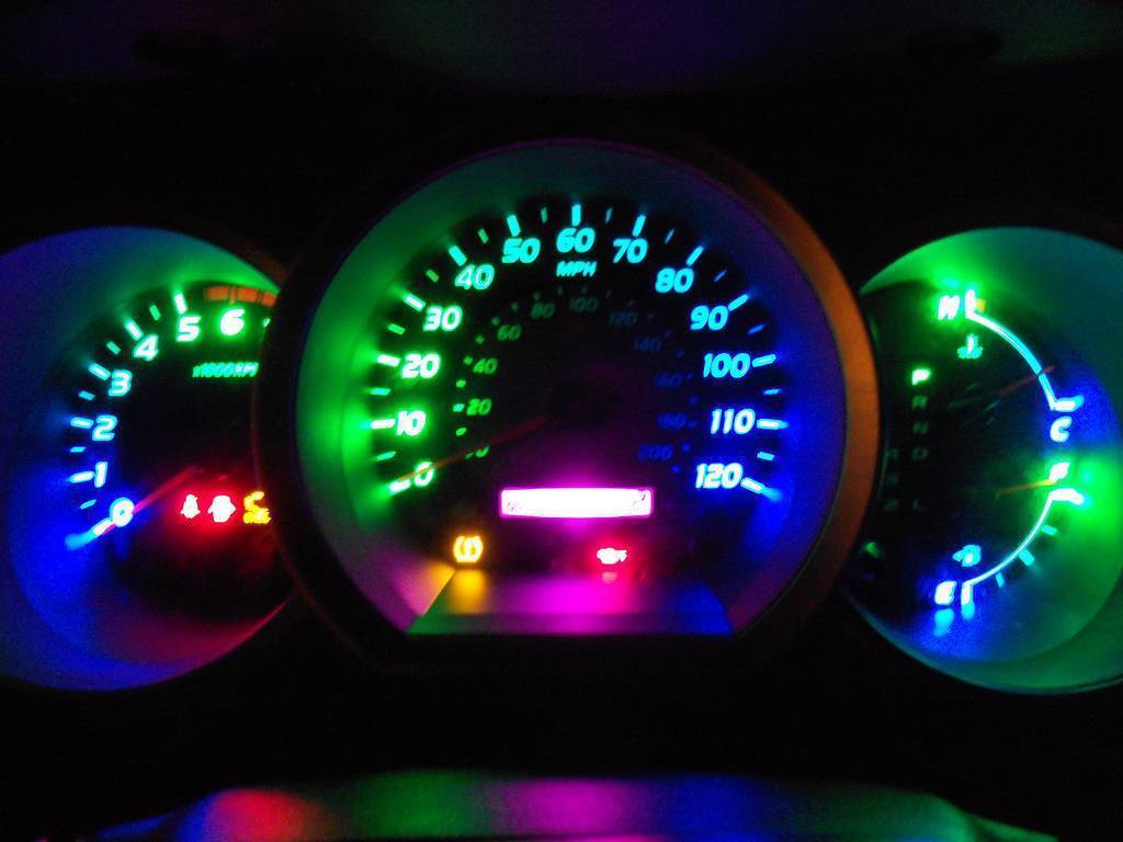

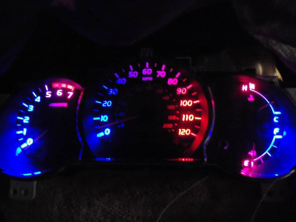

    you can use two led's per individual gauge on your dashboard and that will really add color to your truck. Instead of re soldering the small led's on the board, you can run fit two leds in each compartment behind your faceplate and the run them with a resister for every 2 l'eds. then group them in parallel and power them using one tap splitter off a (+)positive line from your fuse box
