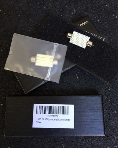

    First off here are the bulb sizes and quantities that I replaced:
    Map Lights: #168 x2
    Dome Light: #578 x1
    Visor/Vanity: #6641 x2
    License Plate: #168 x2
    The whole job takes maybe 30 minutes.
    I would highly recommend a phone repair tool kit. Luckily I had one and it made the job much easier. They are about $10 on Amazon. Hint: save the money on expensive bulbs and get the right tools!
    Parts List:

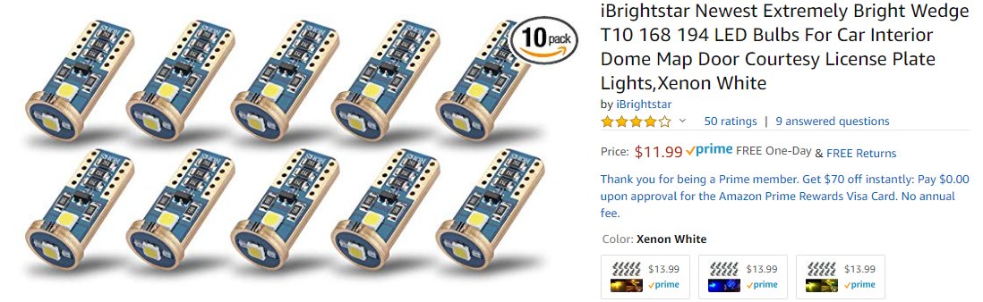

    Map/License plate bulbs
    (pack of 10, only need 4)
    These are by far the best out of all the lights I got! They are bright, white, and cheap. Get these. You'll have some spares.
    Dome Light:

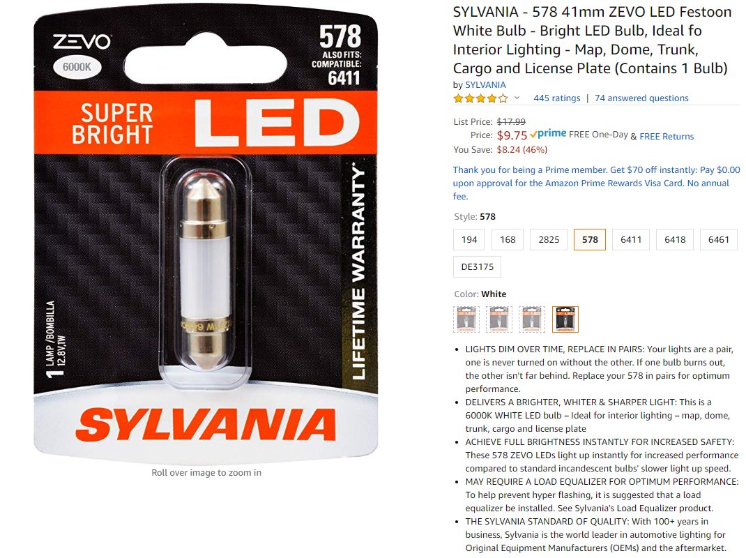

    These are garbage. DO NOT get these. At first, I had all Sylvania ZEVO bulbs in my cart but glad I didn't go that route. They are about $10 each. I thought with the brand name they would be good but that is not the case. Although, they do have a lifetime warranty, not sure I would even mess with that. Go with a cheaper #578 LED bulb. I will be replacing this one with something similar to the others with "non-covered" LEDs. This light is probably the most important because it is what lights the vehicle when doors are opened.

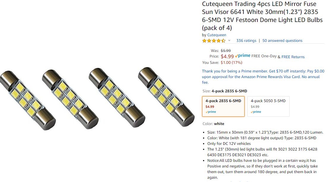

    Visor/Vanity:
    These are good but they are bright. I got the 6 panel LED option. I would recommend going with the 3 panel LED option

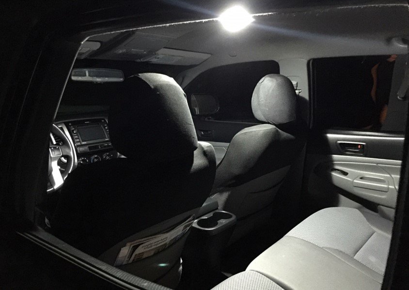

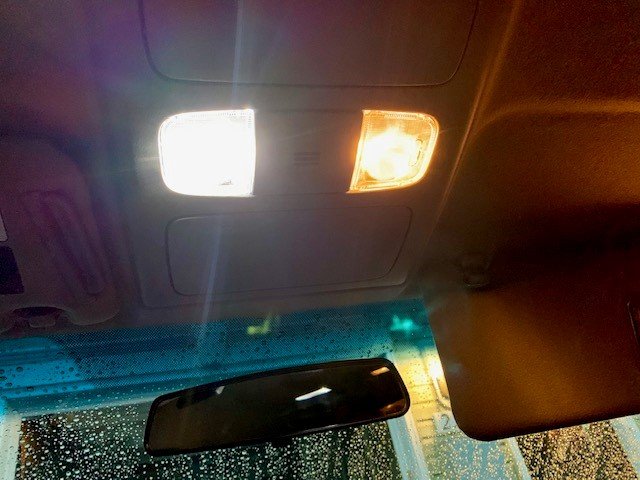

    Map lights - use plastic pry tool to remove plastic cover between the two map lights. Let it hang there. Remove lens cover by prying from the inside out. Then pull down. Use the tweezers to remove the bulb. The tweezers were the ticket. If not I would've had to think of something else. I couldn't get the bulb out with just my fingers.
    Before and after. As you can see they were a hell of an upgrade. Much cleaner and brighter light now.

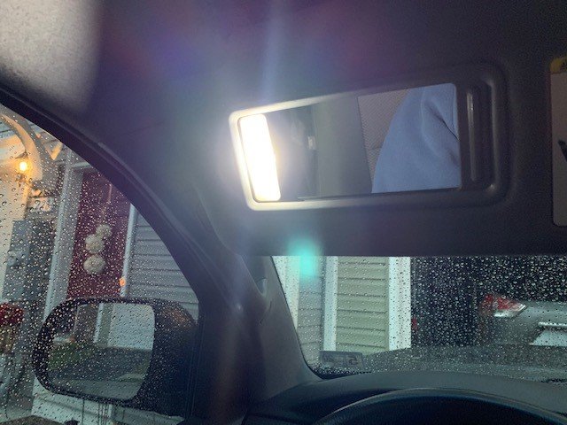

    Vanity/Visor - Easy. Pry the little cover off with the pry tool from the small slot. Replace bulb.
    Before
    After
    pretty darn bright. Go with the 3 panel LED instead

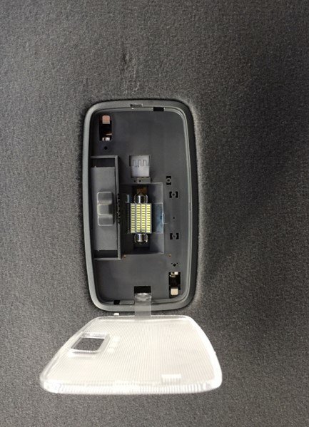

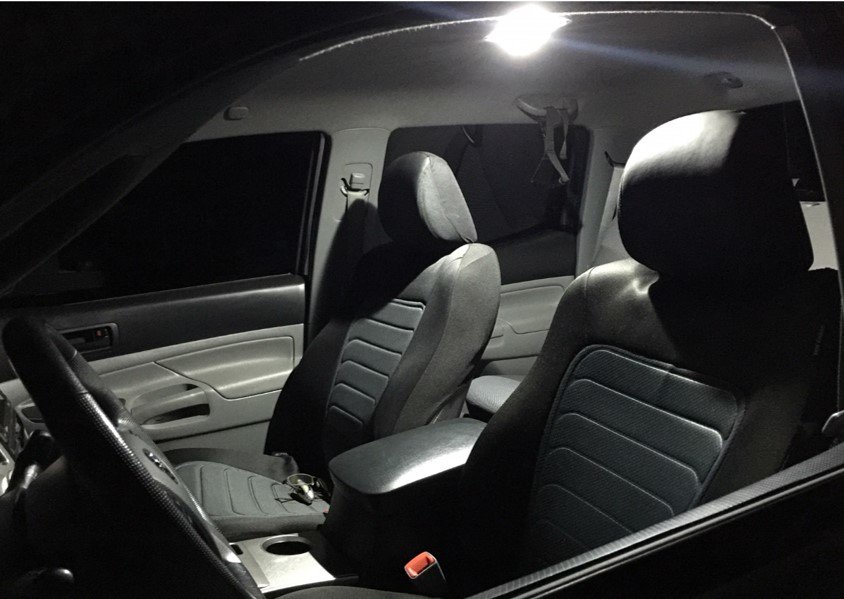

    Dome Light - Easy as well. Pry the dome light lens cover off from the little slot. It will just hang there. Replace bulb.
    No picture but you get the point. Just don't go with Sylvania bulbs (or any other expensive bulbs)

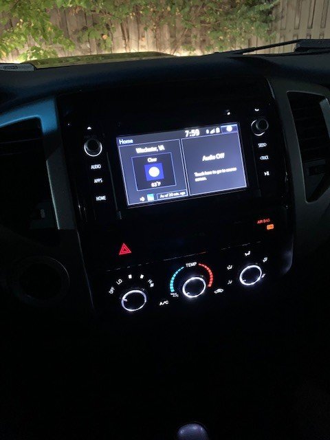

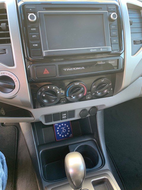

    Here is another cheap mod I've done for $10 that was worth mentioning. Climate control knobs. Got them on Amazon as well. See pictures below.
    Now on to the real upgrades!
    Before
    After
