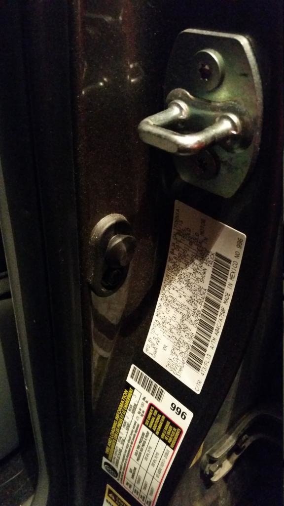

    ok. ive been trying but still cant get light to go off. Is this the door switch your talking about. I have a picture posted.
    Is the switch on the left or right in the pic?
    I tried pushing it all holding it down and light still on.

    On my truck, it's the switch on the left. Once you push it it takes about 30 seconds for the light to fade out. I tested it to see if that was it.

    Try unbolting it, and short the wires together. Wait 30 seconds for light to fade.

    I unbolted it and the wire was attached to a plastic clip. how do I remove the plastic clip to short the wires together.

    You could use a paperclip shaped into a U and plug that into it. It's just 2 wires, correct. I would definitely verify so as not to short out anything that shouldn't be.

    its hard to see but kind of looks like only 1 wire.
    is there only 2 door sensors on the front doors? any sensors on the back?

    Double cabs have switches at each door.... access cabs do not have then at the small doors.
