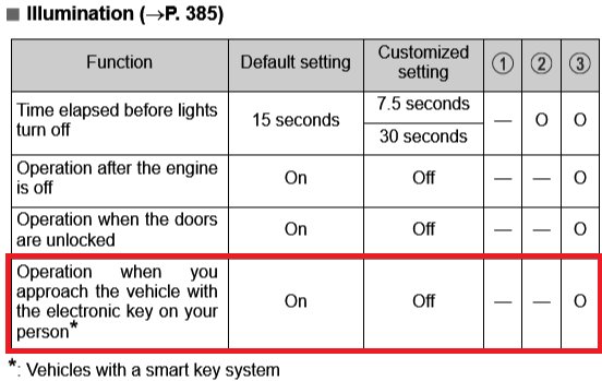

    Ok just to clarify. The lights automatically come on as you approach the vehicle (If you have smart key). That is a feature. Just want to make sure your not confusing a feature to a problem

    yup. Default is set to on and has to be changed by the dealer.

    Yes, the lights come on as they are set to "door". But i'm talking about after The truck is locked or after I'm inside the truck and start the ignition.

    The courtesy lights will turn on when you enter the vehicle. Once you start it they will turn off. After you turn the vehicle off the courtesy lights will turn on.
    If that bothers you. Go to setup. Vehicle. Vehicle customization. Lights settings. Interior lights off timer and switch it off.
