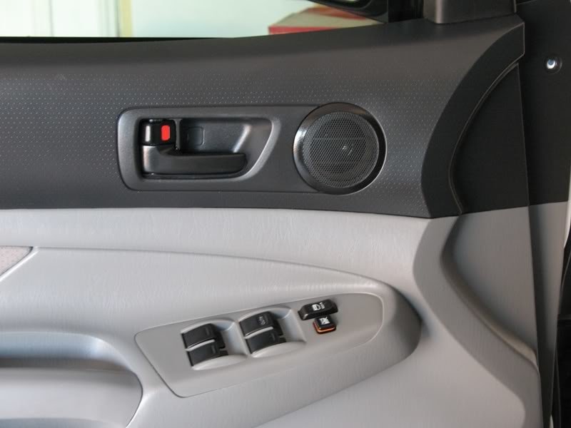

    Does anyone have a response to this? I'd like to know the same...can the tweeter covers be removed. Also what is the best paint to use on the interior?

    Need to take off door panel and remove plastic weld from back of bezel .When putting back need to glue back on. Duplicolor trim paint (black) works good.

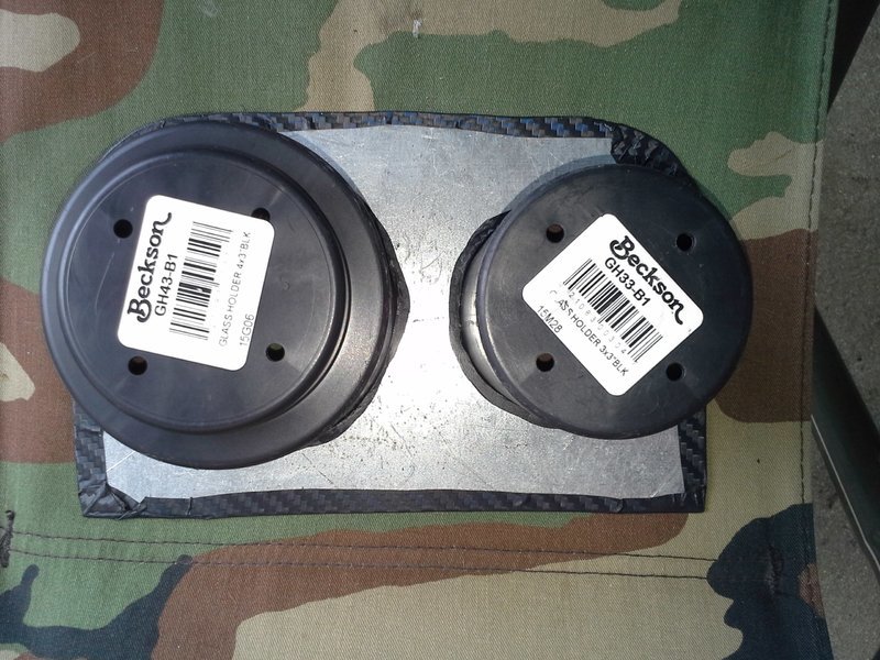

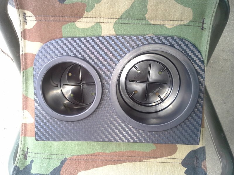

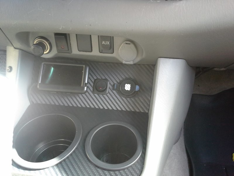

    Just re did cup holder . Because wanted to do something.... :D
    Added another panel .Will put couple switches I need to move

    Very nice ... clean look ...

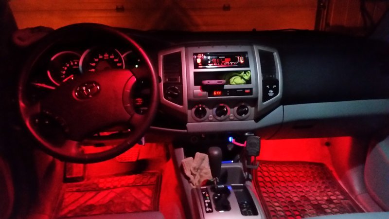

    Red led foot wells

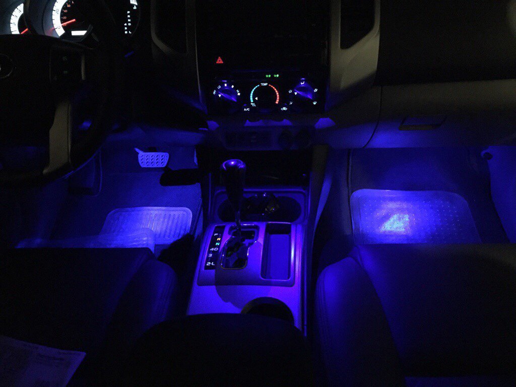

    Same mod to match with my Flyzeye

    Where did you buy the LEDs to use in the foot wells? Want to do this mod but not sure what LEDs to use.
  12. Feb 12, 2016 at 10:15 PM
    #212
    Siblue
    Siblue Well-Known Member
    Dec 2, 2014
    #143489
    3,159
    So Cal
    25 Tundra TRD pro
    After many blue LED purchases(all failed) I contacted Flyzeye and was kind enough to send me some.
    I soldered my own 1k ohm resistor to each LED.
