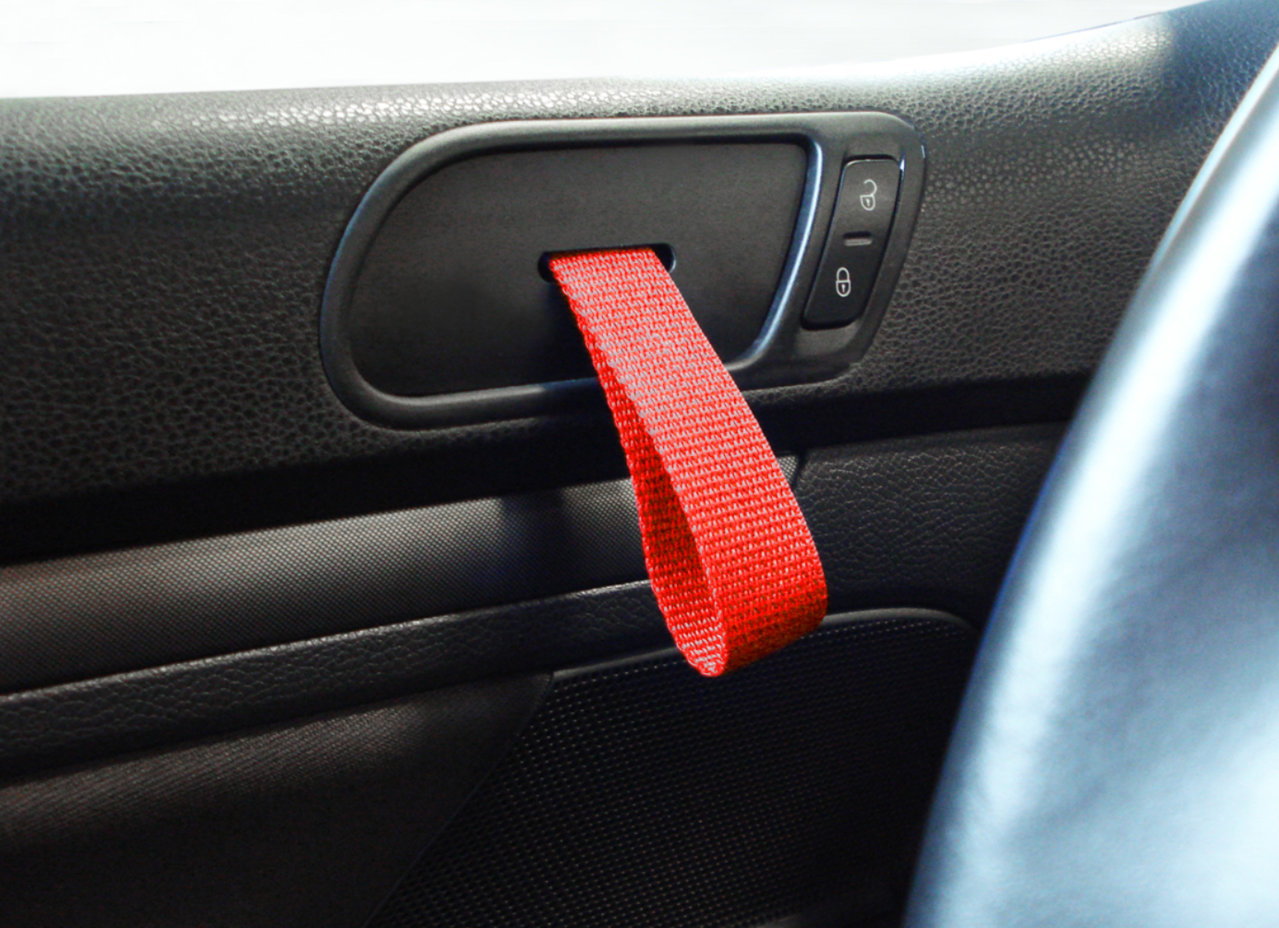

    I’m 99% sure I saw a build thread where someone added an interior handle that was made from nylon webbing. It was a simple slot and pull strap. I looked around and for the life of me I can’t remember where I saw it.
    Picture this, but on the inside of the tailgate skin.

    I’m still liking my flat nylon webbing pull release idea since it’s basically flat and I won’t bang anything off of it sliding stuff in and out of the truck

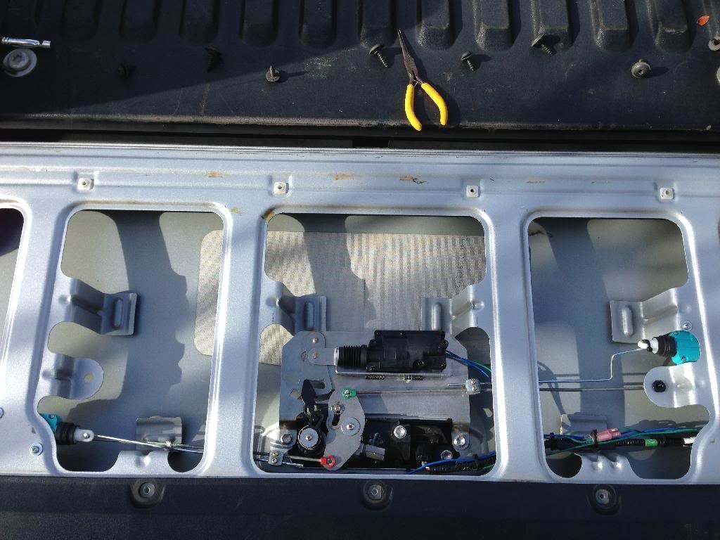

    Did some searching. Found this thread the other day.
    https://www.tacomaworld.com/threads...e-tailgate-release-from-key-fob.311848/page-2
    I have ideas now.
    I have 2 power door lock motors from a previous project I never did. And I just installed an EZ-Down tailgate assist on the truck today.
    If my idea works, I’ll use the lock motors to push the rods “open” and use the return spring in the handle to “close” the motors.
    Instead of going off the remote, I’m just going to add a momentary switch for now. If it all works out, I’ll add the brain to connect it to the OEM keyfob.

    I got the releases all designed, installed, and hooked up and working 100%
    I’ll post some pics and info at some point.

    Any chance you have a picture of your tailgate?
