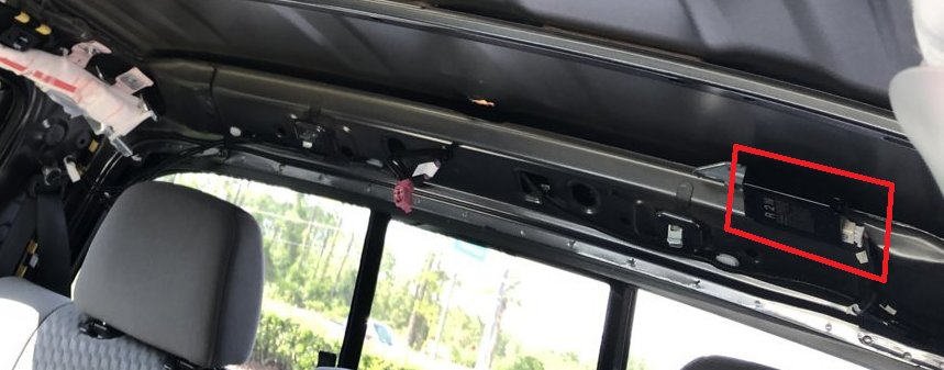

    Appreciate the help. Truck battery tests out fine. The only LEDs I have on the truck are aftermarket ditch lights and an aftermarket reverse light flush in the bumper. Neither of those are on when I'm trying to lock or unlock so I don't think its those.
    Is the receiver module high in the headliner somewhere, under the roof cubby maybe? If its easy enough to get to ill pull it and see how it looks.
  4. Dec 6, 2022 at 12:03 AM
    caribe makaira
    caribe makaira Well-Known Member
    Feb 13, 2011
    #51121
    11,714
    Caribbean, Puerto Rico
    05 PreRunner TRD Offroad AutoTrans
    Hood Struts, My version Fogs always ON, Map & Overhead Light Mod,
  5. Dec 6, 2022 at 4:08 AM
    Deacon Blues
    Deacon Blues [OP] Well-Known Member
    Sep 7, 2017
    #229363
    1,468
    Colorado
    2017 SR5
    Well shit. So much for easy to get to.

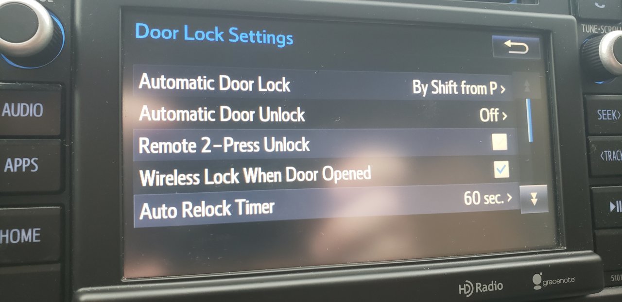

  6. Apr 13, 2023 at 7:12 PM
    Deacon Blues
    Sep 7, 2017
    #229363
    1,468
    Colorado
    2017 SR5
    Update for those with similar issues...
    Toggled the "Remote 2-press Unlock" to off and it seems to have fixed the problem.

  8. Apr 14, 2023 at 11:31 AM
    Deacon Blues
    Sep 7, 2017
    #229363
    1,468
    Colorado
    2017 SR5
    Nope, I can be standing right in front of the truck. I've tried to isolate all the variables, weather, batteries, obstructions, etc...
    So far changing that setting in the lock menu is the only thing that's made a difference.
