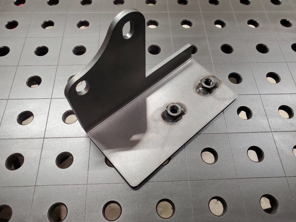

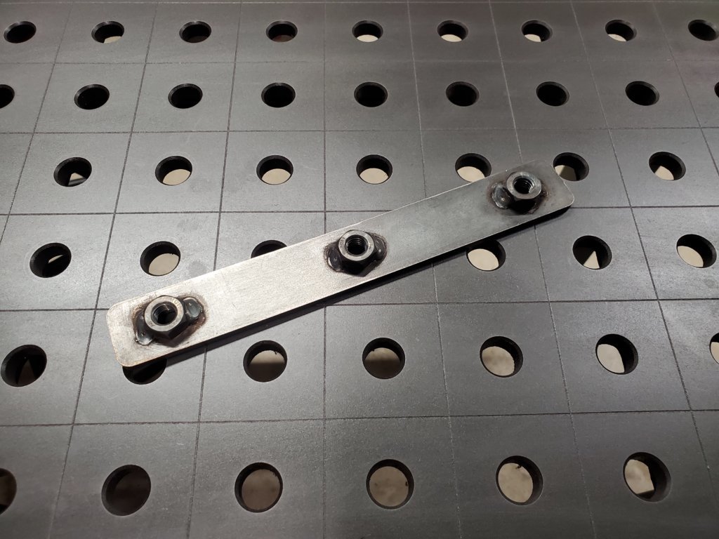

    The Kit -
    After several weeks of mocking up in 16 gauge, followed by measuring, cutting, and prototypes in 3/16" the kit is finally complete!
    Hardware -
    You will need to provide your own M10 x 1.50 x 30mm of your choice. The hardware welded on these parts are M10 x 1.50 nuts all around.
    If you are unsure of what hardware you should get, I'll leave these few points along with several links.

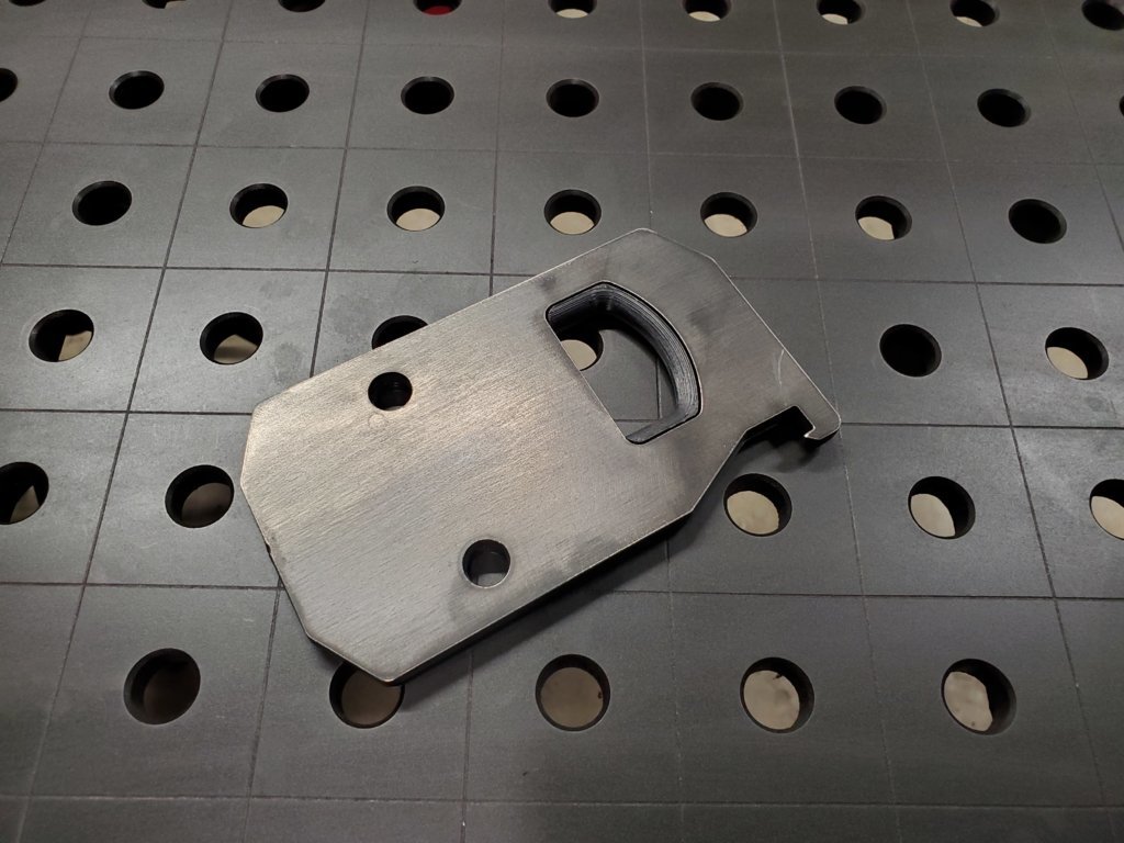

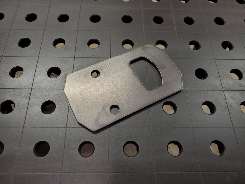

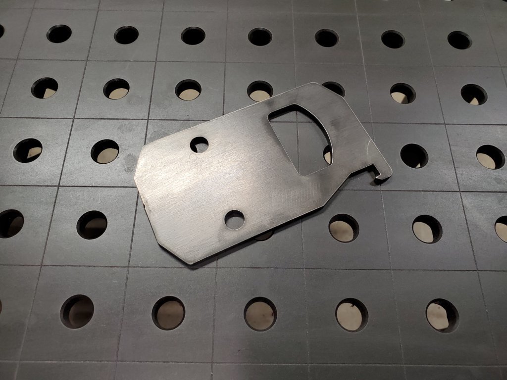

    To offer a bit of something for everyone, I've opted to offer buyers a variety of exterior brackets shown below.
    Tie down bracket -
    Tie down bracket with bottle opener -

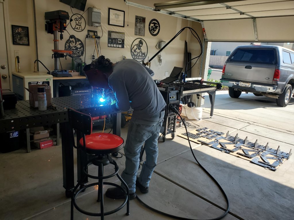

    Because everything is measured and welded by hand, I will require a lead time of up to 2 weeks per set.

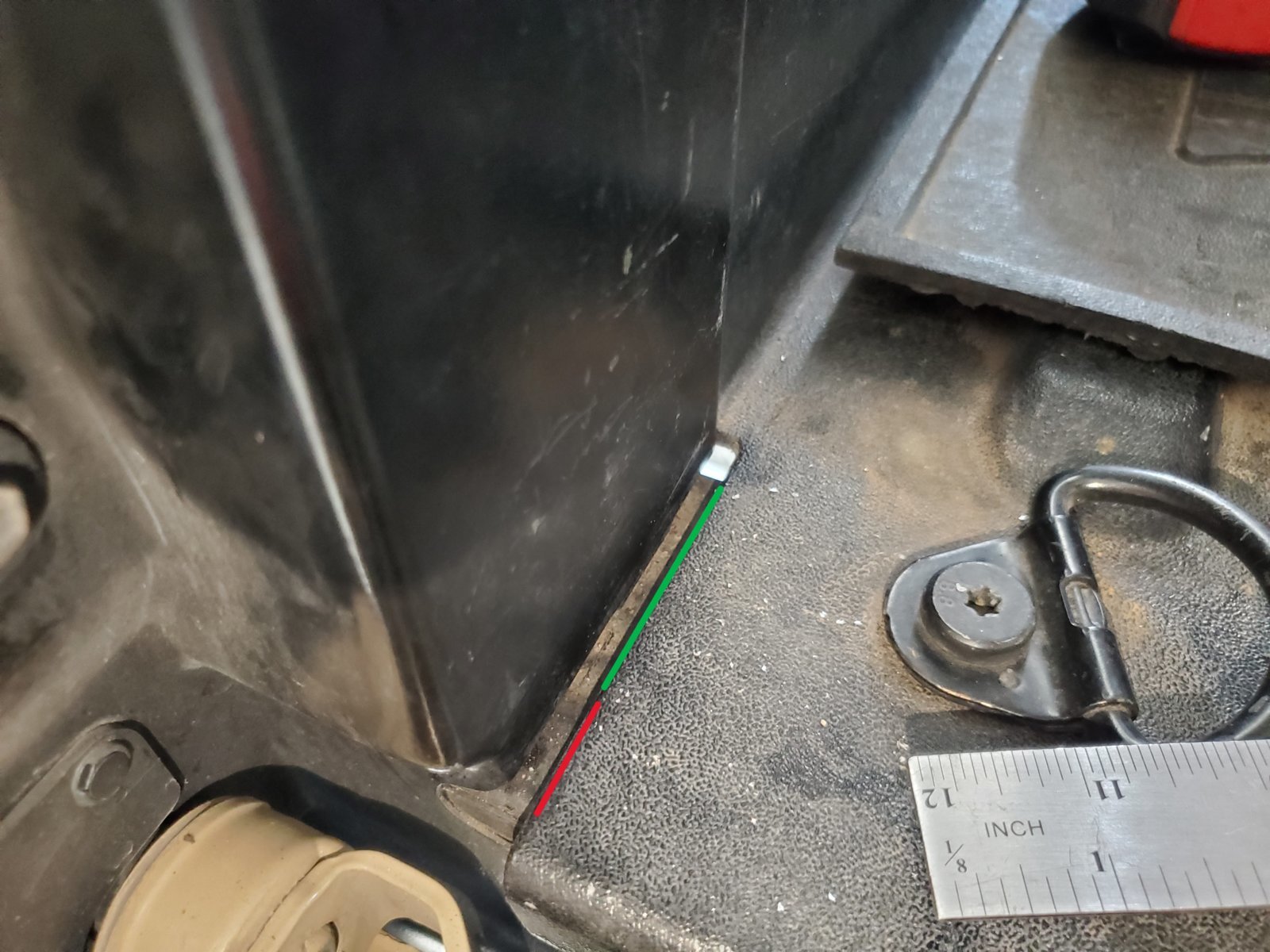

    Also for ease of installation, I will emphasize on points that can cause one install to differ from another.
    When measuring the bed surface, it is important to note that the floor has a "hump".
    The picture below is that of the driver's side.
    Towards the tailgate, the bed floor is slightly raised and so the part towards the cab sits a hair lower. It is imperative that you measure from the lower portion as shown below in green.

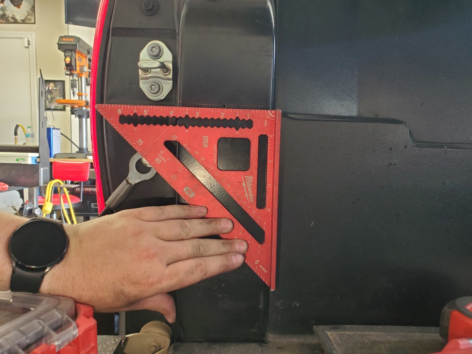

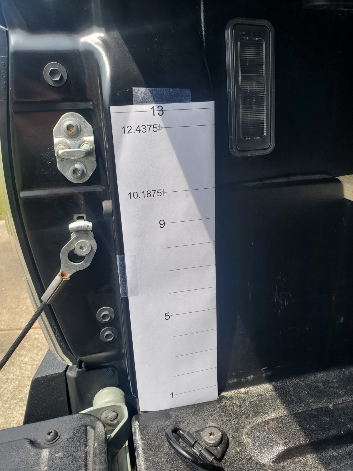

    The bottom hole center measures 10 3/16" from the bottom up. Place your mark, and scribe a line straight across. The top hole center measures 2 1/4" above your bottom hole.
    Next part is also important. You need to measure 2" from the leading edge meaning, 0 will start from the edge closer to the cab.
    This is how we measured 2" over. The edges are curved and this was the best method for measuring as accurately as possible.

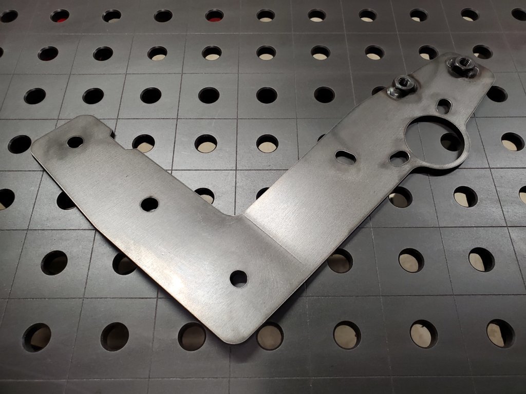

    Lastly, the bent bracket is slotted for ease of aligning everything which is something I noticed was not done on the massively produced set.
    For those that have the ability to print 11" x 17", @MagicToolbox was kind enough to provide a PDF print out to be used as shown.
    It is imperative that you use a known scale to ensure your print out is accurate before using.

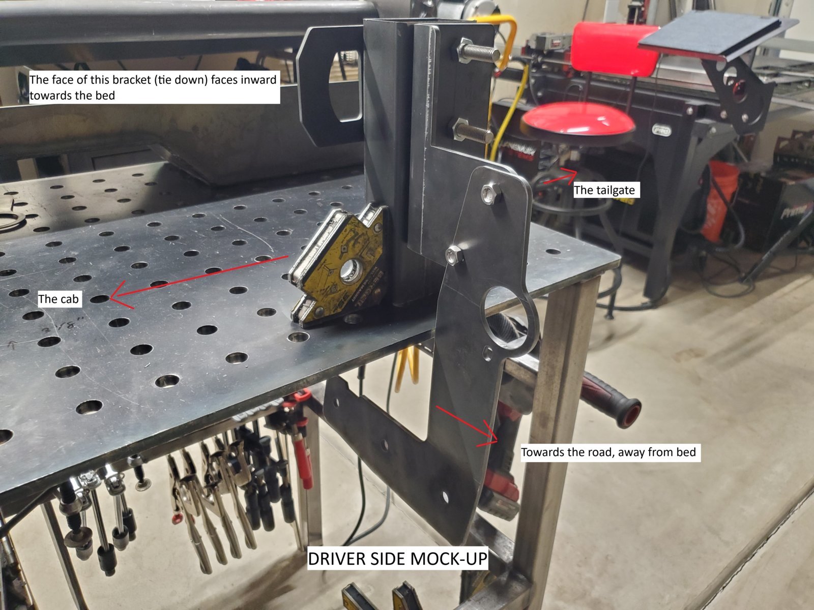

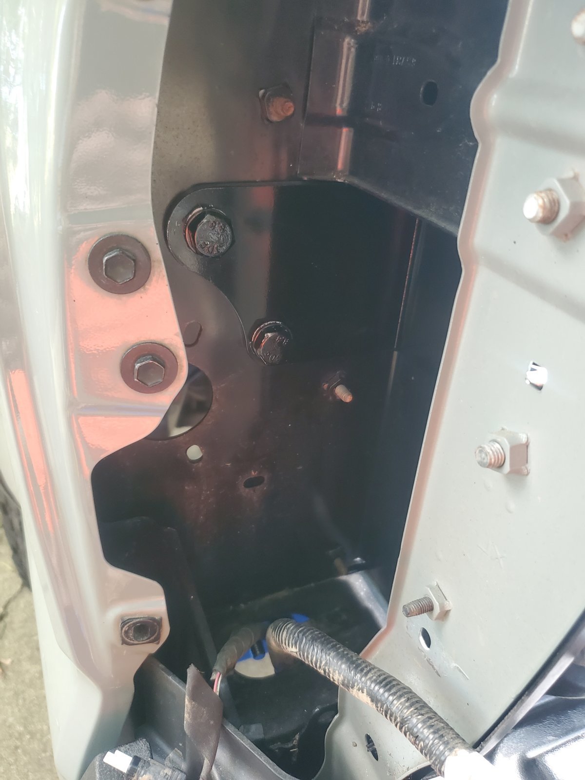

    Mock up Install -
    Below is the orientation of all components as if installed on the driver side.

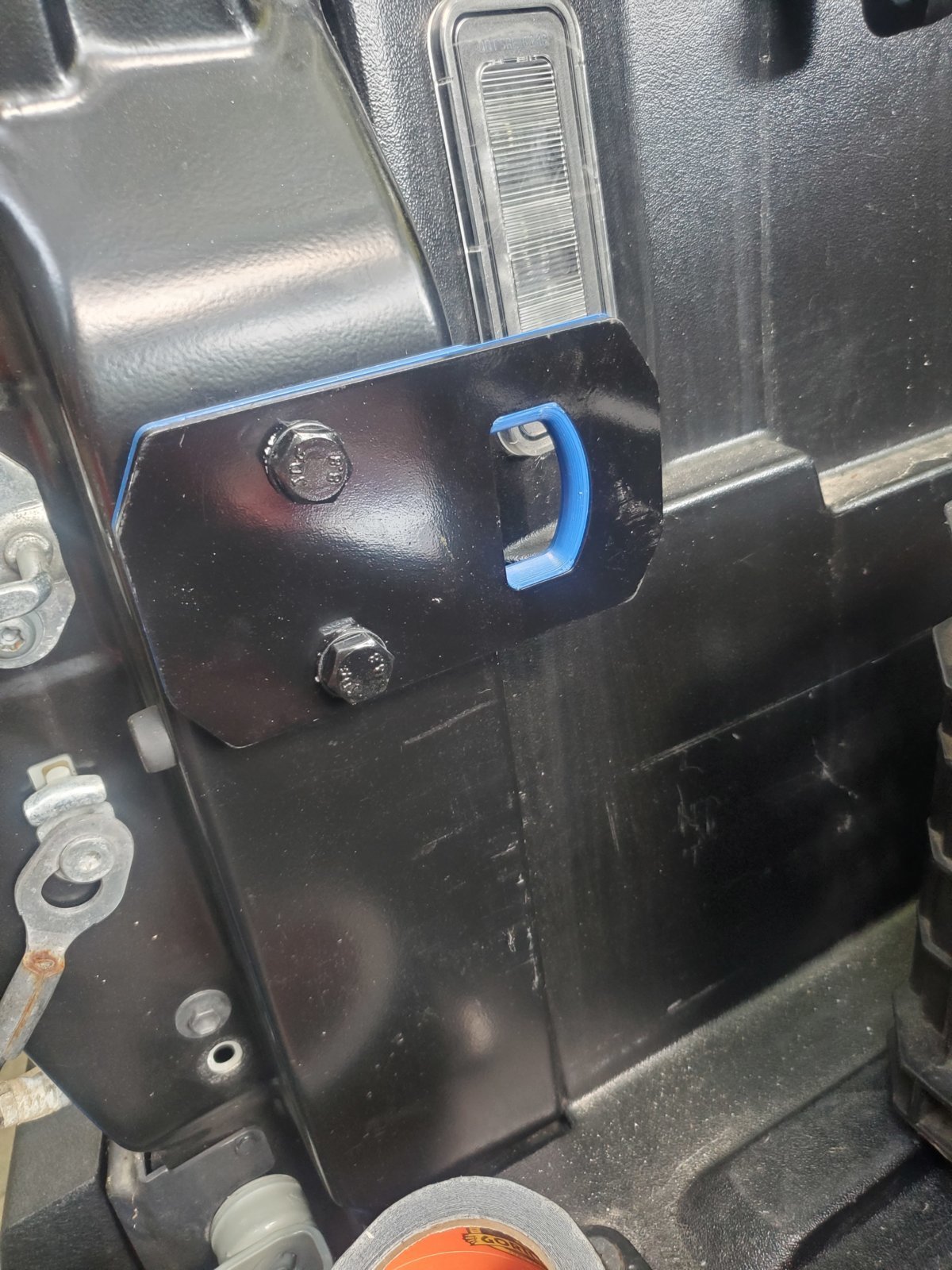

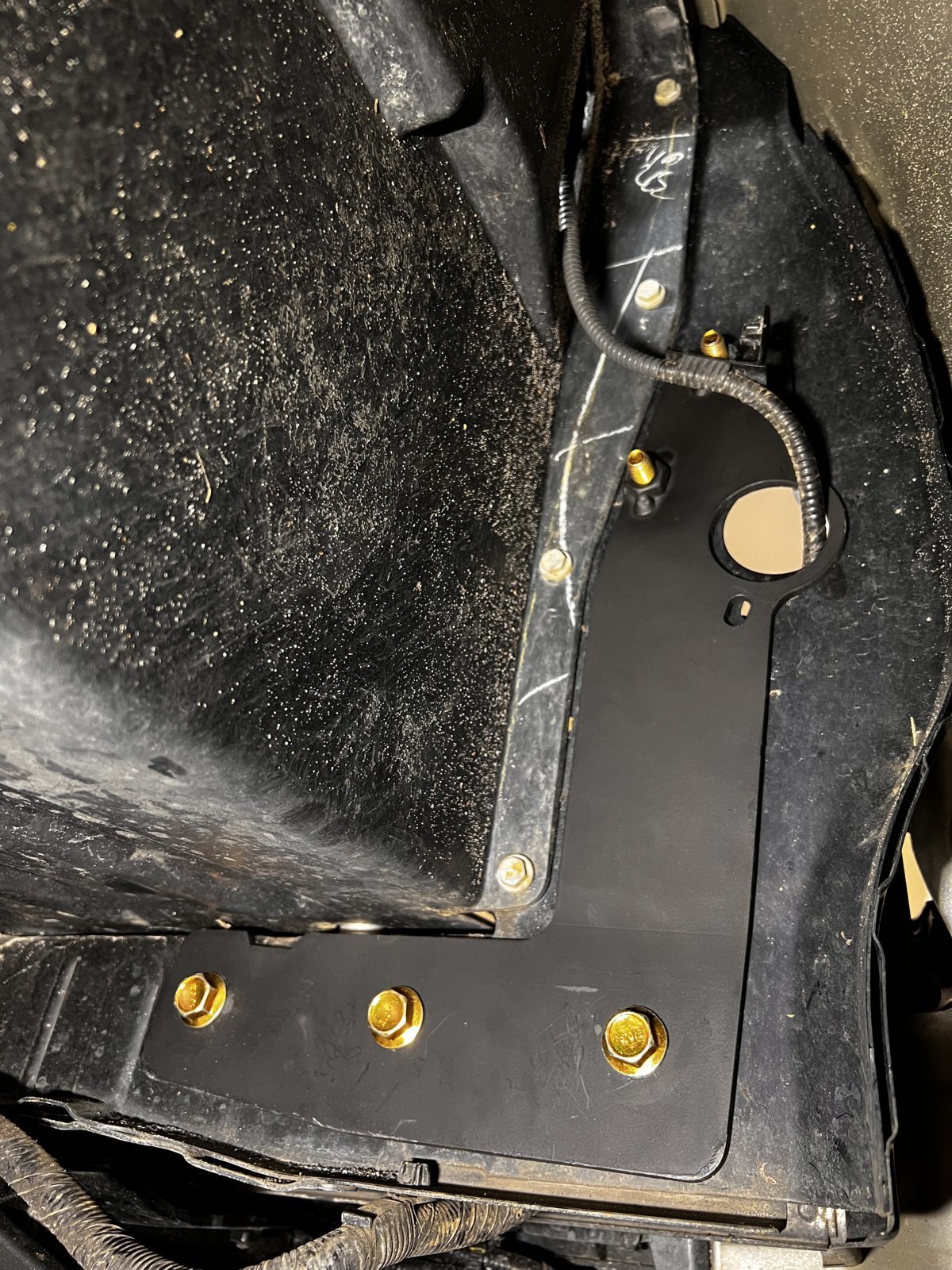

    Customer installs -

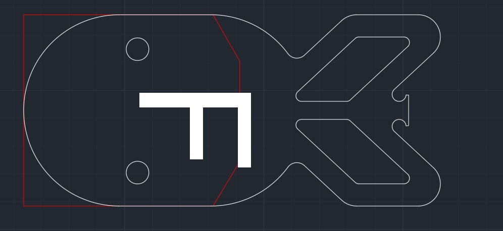

    Bare plate, tie down, bottle opener, F-bomb, eggplant…
    I’m not picky.
    The mocked up tie down looks a little on the large side imho
    NoOne and Kwikvette[OP] like this.
  13. Jul 10, 2024 at 1:04 PM
    Kwikvette
    Kwikvette [OP] Well-Known Member Vendor
    Feb 27, 2019
    #284735
    80,958
    Fresno County
    4 run, 2 don't
    This is what I need to hear
    Majority here I assume use tie downs
    Some use ratchet straps, others use bailing wire, maybe bungee cords, rope, I want to know what the majority would like to see
    I can also apply a radius to the inner and outer edges if the concern for gouging is a possibility instead of the square look you see now
  14. Jul 10, 2024 at 1:06 PM
    nevertoomanytacos
    nevertoomanytacos Taco Fan
    Jun 14, 2024
    #451479
    67
    3rd Gen
    Yes pls. Soft-tie is often first on the bed tie-down points. Sharp cuts 'em up....
    Tie down sizing looks a bit big too. Perhaps you can reference stock tie-down points for sizing?
  15. Jul 10, 2024 at 1:09 PM
    Kwikvette
    Feb 27, 2019
    #284735
    80,958
    Fresno County
    4 run, 2 don't
    It'll still have a sharp metal "lip"
    The opening will simply be rounded
    That's something I see exist on all styles in the market, but yeah I can absolutely go round for some or all

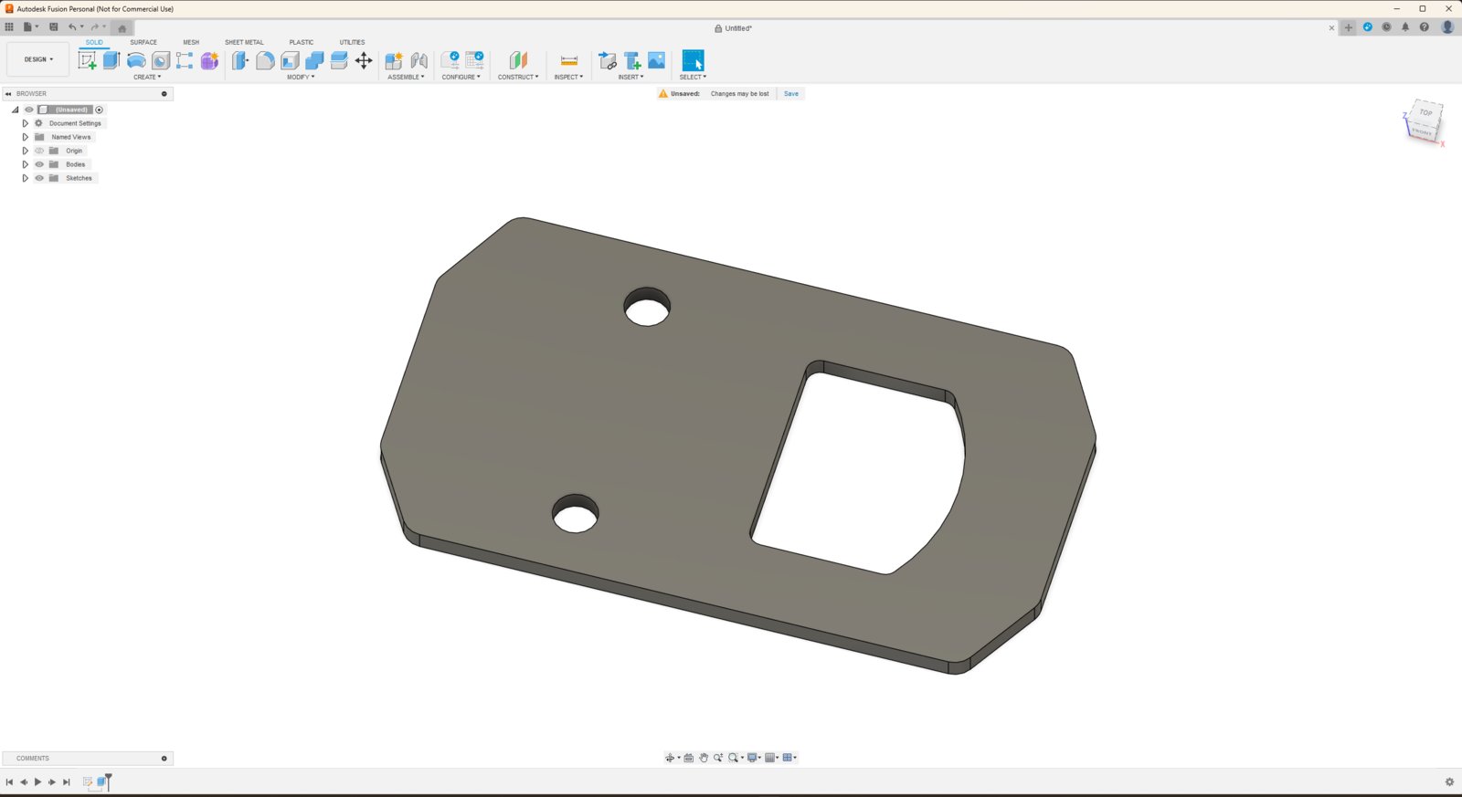

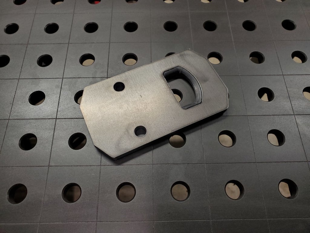

    I use mostly tie-downs, bungee cords, and ratchet straps so anything to minimize cutting/gouging would be nice.
    Maybe multiple small tie-down points like the original instead of one large point? Also, i'm not picky similar to musicisevil :)
    Kwikvette[OP] likes this.
  18. Jul 10, 2024 at 1:54 PM
    #18
    MagicToolbox
    MagicToolbox Well-Known Member
    Feb 23, 2024
    #444482
    337
    2022DCSB MT TRD OffRoad in Lunar Rock
    Purchased Toyota Certified, with Vijay bumpers, additional lights, and Falken Wildpeaks on Fuel rims. Prev owner apparently painted the grill.
    Yeah, like two tie points, with a bottle opener included... :rofl::rofl:
  19. Jul 10, 2024 at 1:55 PM
    #19
    Kwikvette
    Feb 27, 2019
    #284735
    80,958
    Fresno County
    4 run, 2 don't
    I'll get on that shortly :rofl:
    Just put a radius and shortened the length of the opening
