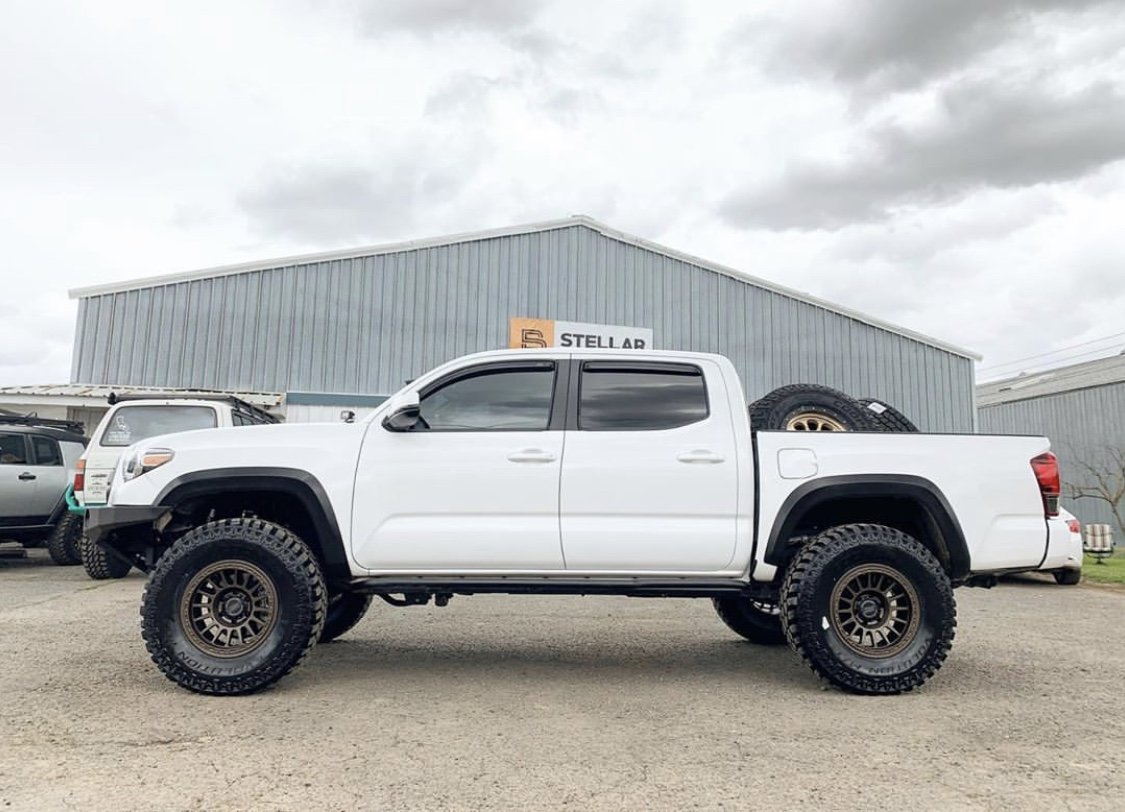

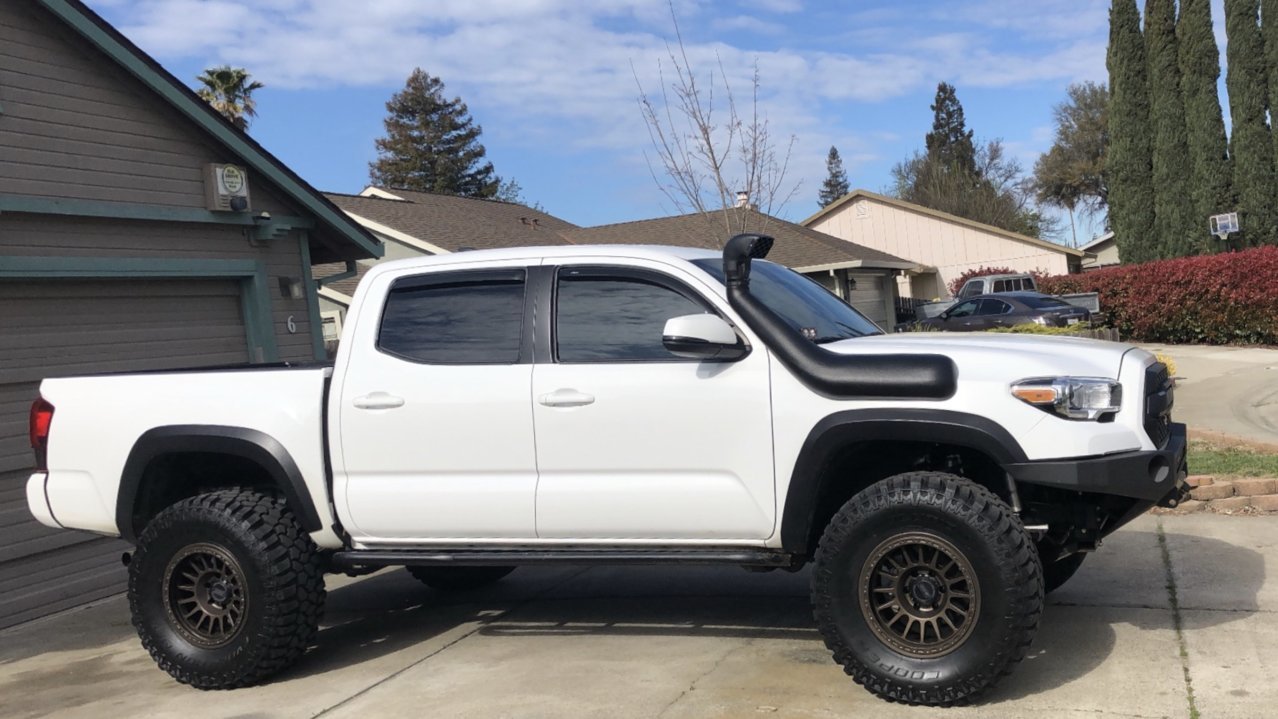

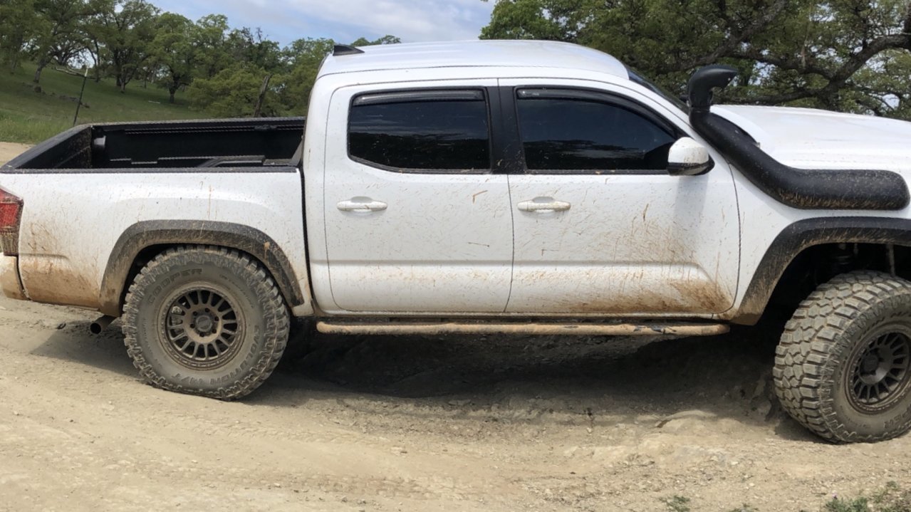

    For those who want to fit 35's but want less of the rubbing issues, check out 35x10.50x17's. I'm running the Kenda Klever's and fit them with much less than 3" of front lift.
    I'm running King 2.5's at maybe 2" of lift, CMC, pinch weld beat, and a little trimming up front. I'm sure I'll have to heat of the fender liners and push them in just a tad more, but that's really all I have to do. The SPC control arms I have are in position E with the lowers maxed forward. Very easy alignment and didn't have to touch the lower arm much.

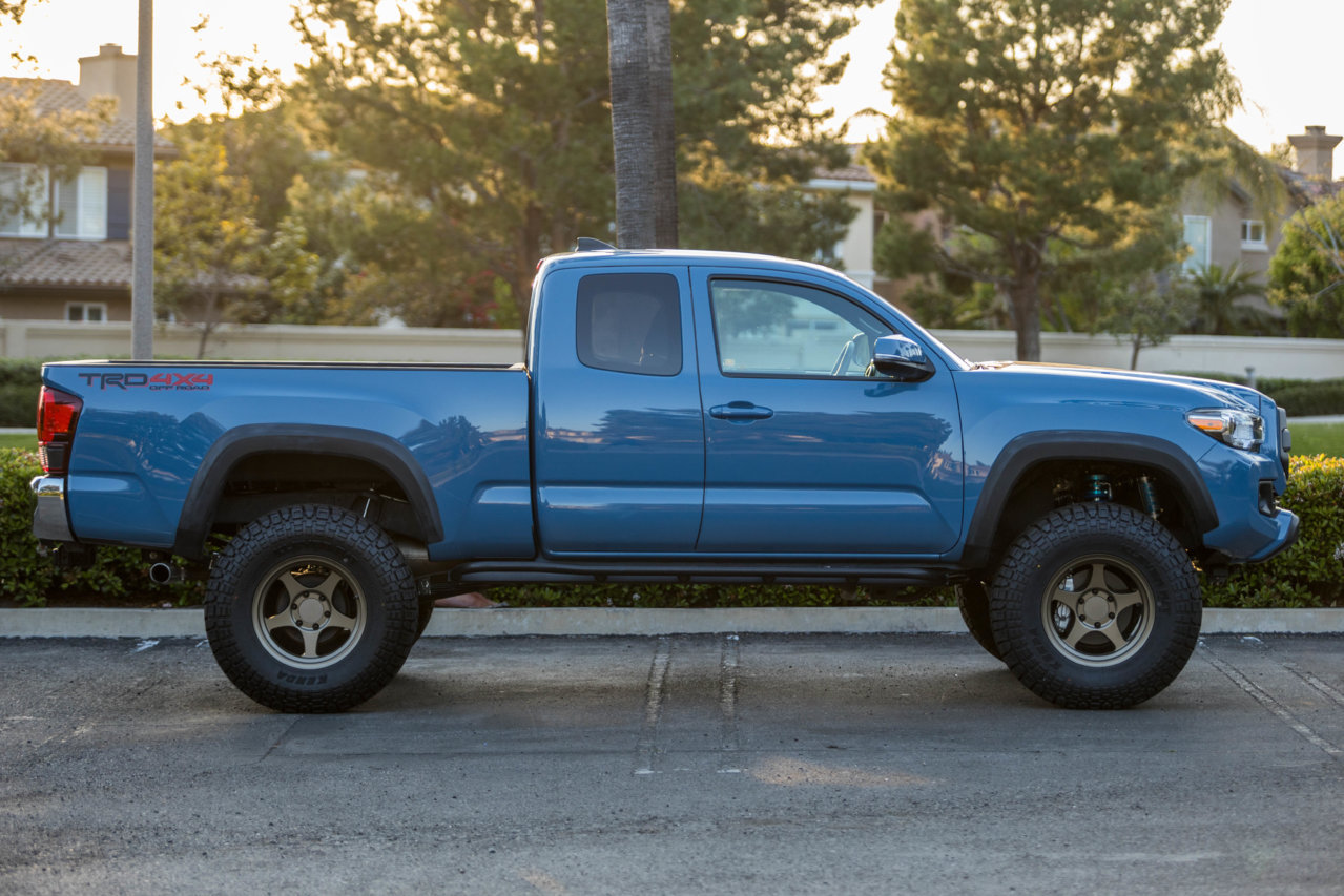

    17x8.5 -25 rrw rr6-h on 35x12.50r 17 cooper evolution mt
