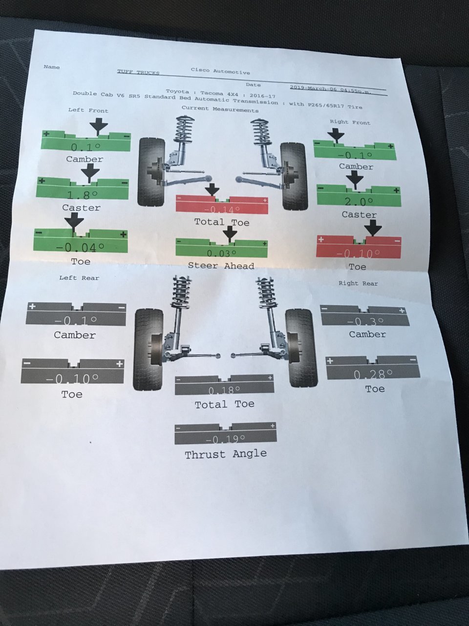

  20. Mar 12, 2019 at 12:12 PM
    #80
    Hookedup
    Hookedup Well-Known Member
    Jun 27, 2014
    #132830
    773
    SOFLO
    2012 DCSB SPORT/ 2019 OR DCSB
    FOX 2.5 DSC/ICON RXT/SPC UCA
    Anyway you can elaborate on this? I guess I’m chasing numbers.. total newb at this. I’ve had two alignments and both shops put me in factory specs. Even though i told them to maximize my LCA eccentrics and adjust accordingly from ball joint on SPC. From what I’ve read here on TW somewhere between 3° and 4° Caster is the desired setting to minimize rubbing on cab mount and lower fender. Am i missing something? I’m going for my 3rd alignment tomorrow (a shop that has worked w SPCs regularly) just so i know what to look for.
    This is from the second shop (first was unable to provide specs) all they did was say ‘you need smaller tires’ and did nothing to tweak my alignment..
    Thoughts?
