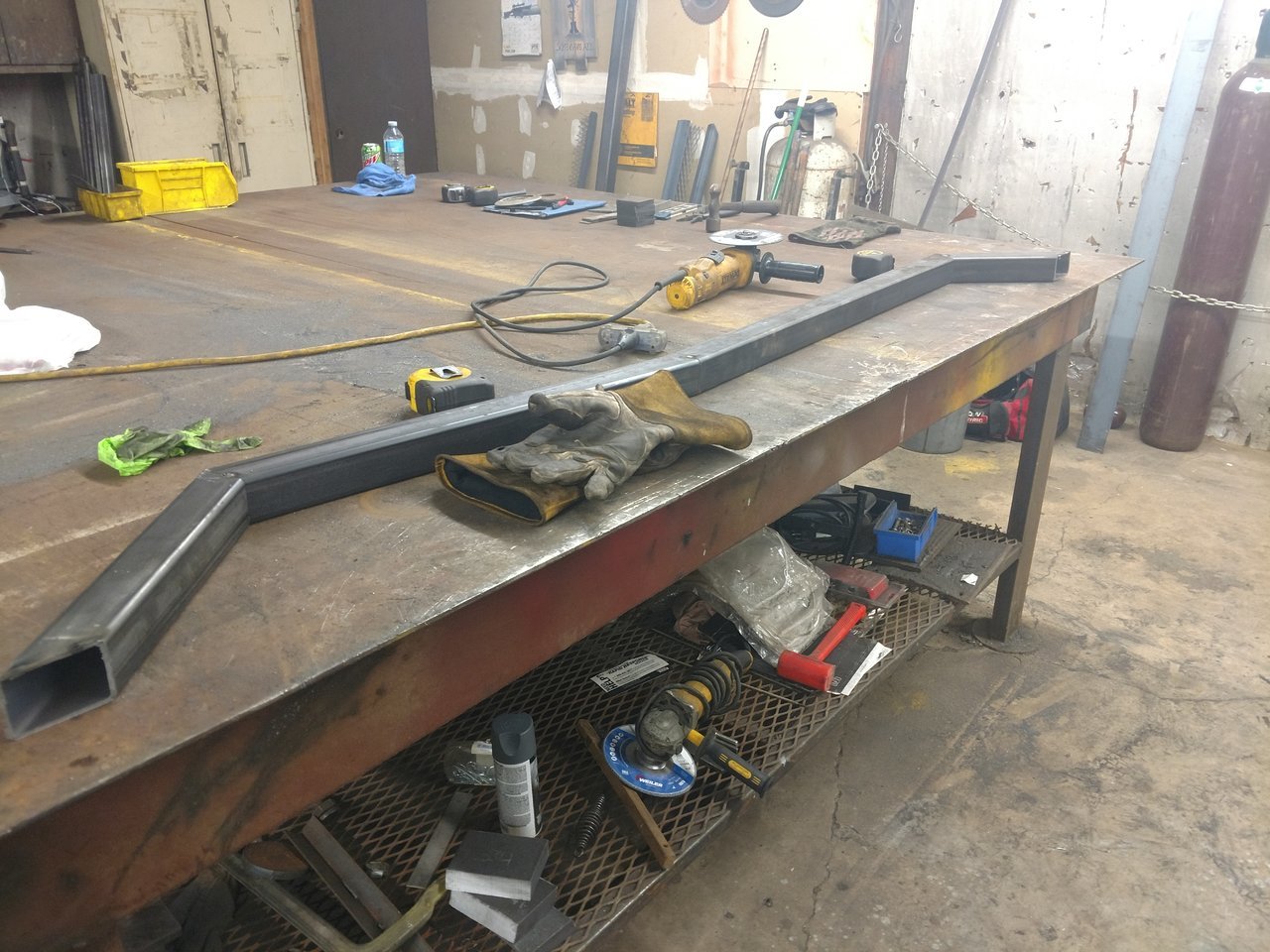

    The first thing I made was a set of sliders because I was deathly afraid of bashing in my rocker panel!
    Some pictures mid fabrication and test fit.

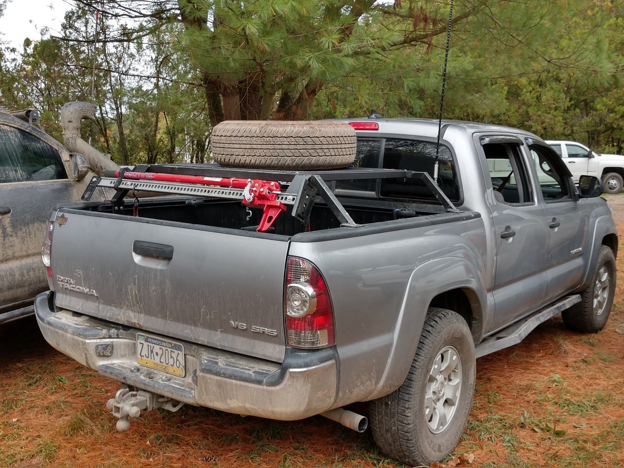

    My next endeavor was a set of bed bars to keep my hilift jack secure and get my spare tire out from under my truck. I also thought to mount my CB antenna to it.

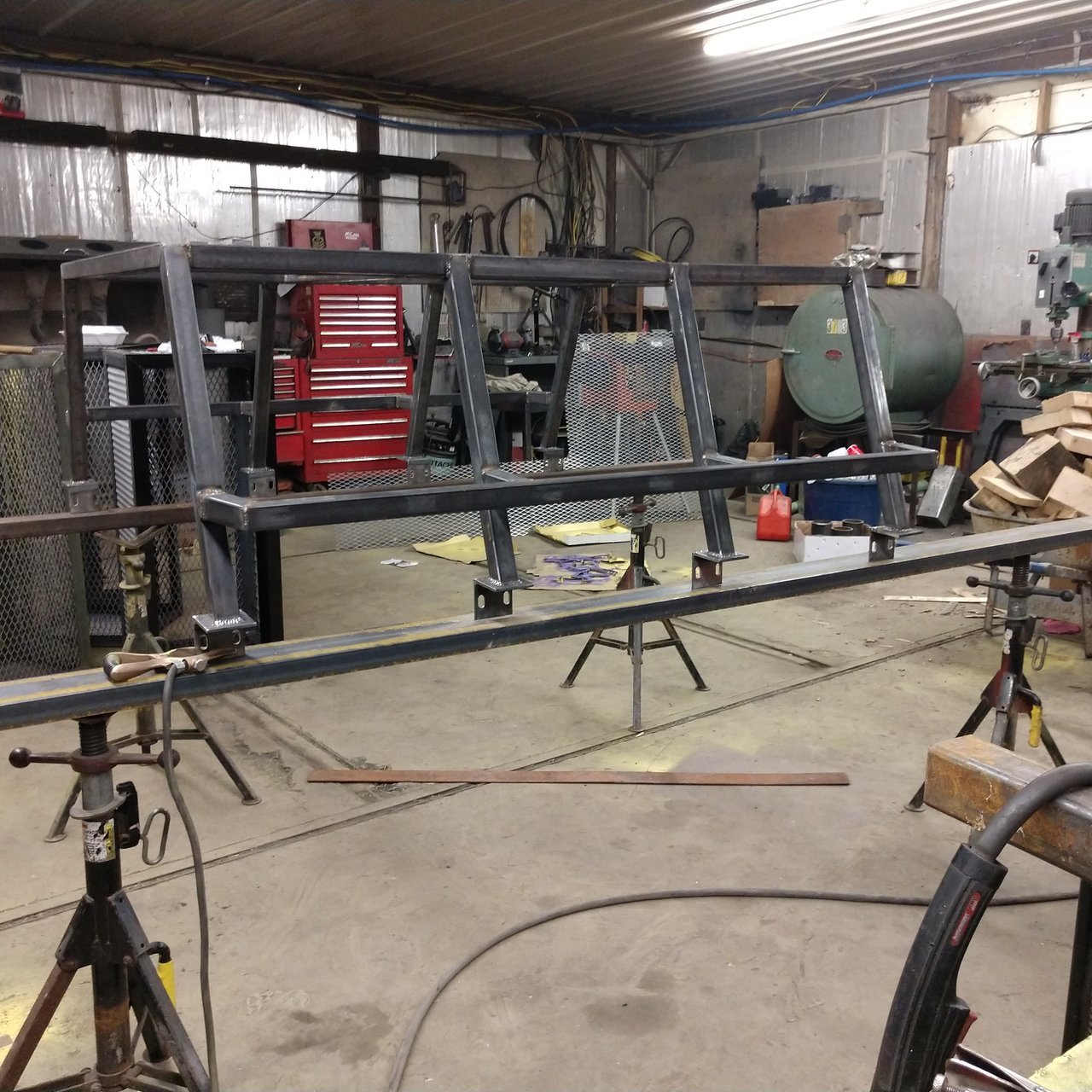

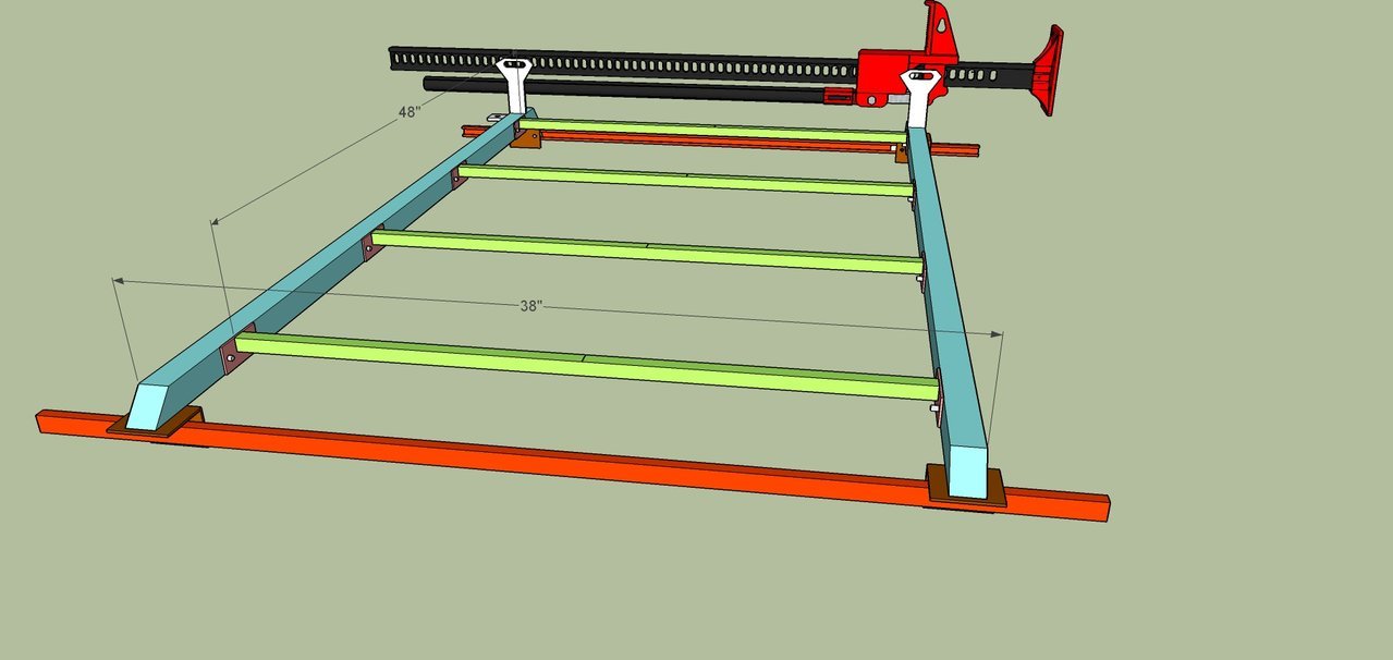

    I touched briefly about being able to custom design products and I wanted to expand on this and explain in a little more detail.
    Recently a customer saw my bed racks and wanted to have them modified to fit a long bed truck, he also wanted them taller to accommodate kayaks.
    In a very short timeframe, less than an hour, I was able to show him a conceptual design.
    From there we were able to tweak the design even further to come up with exactly what he wanted.
    I'm happy to work with you to modify any of our existing products or come up with something completely new to suit your needs. I can show you your ideas in 3D, on your truck and take all guesswork out of the process. You will be able to SEE and KNOW that what you are getting is exactly what you want.
    I love being able to interact with customers and involve them in the design of their products. I take great pride in being able to see something from go from just an idea to finished product on someones truck.

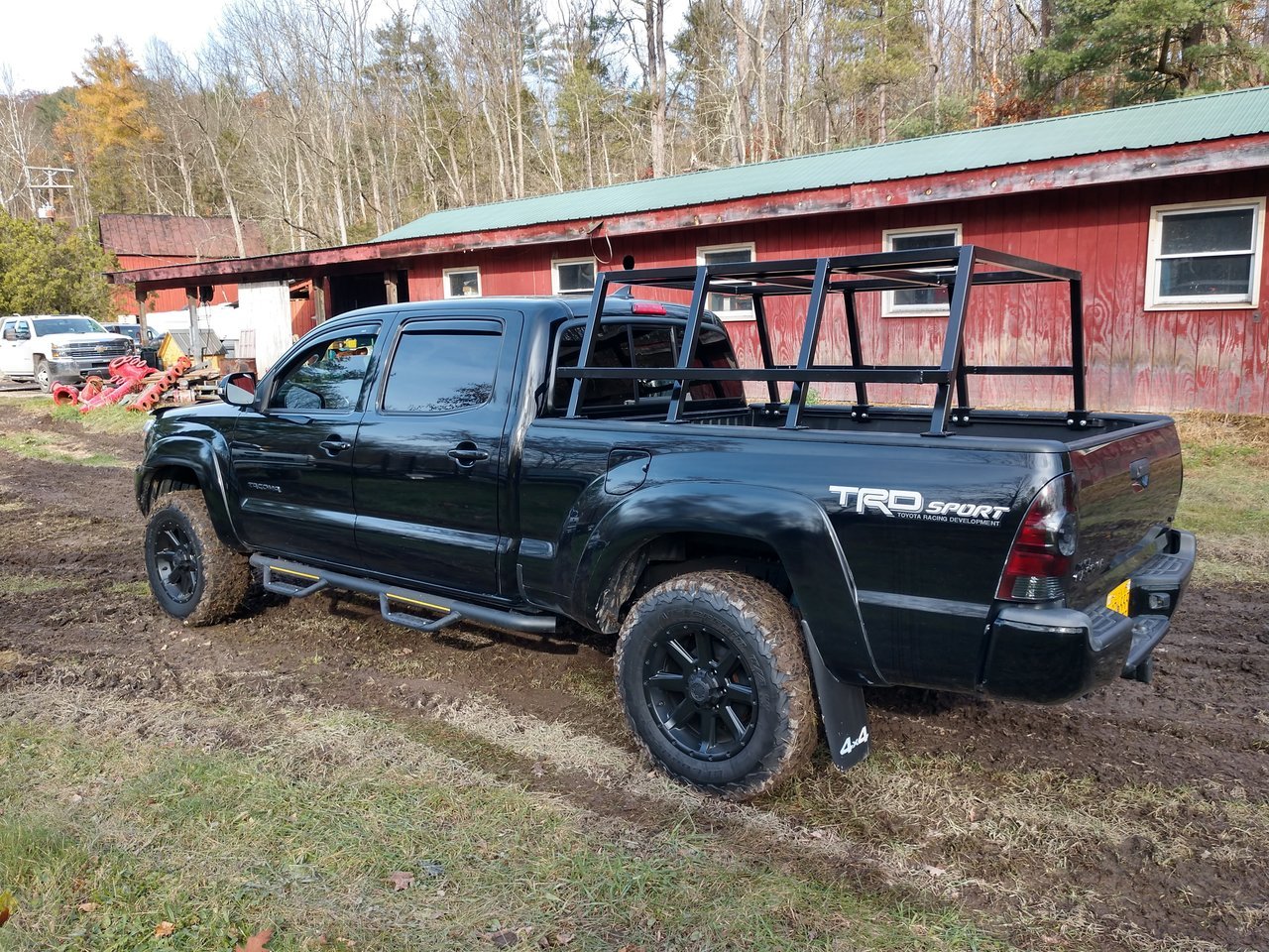

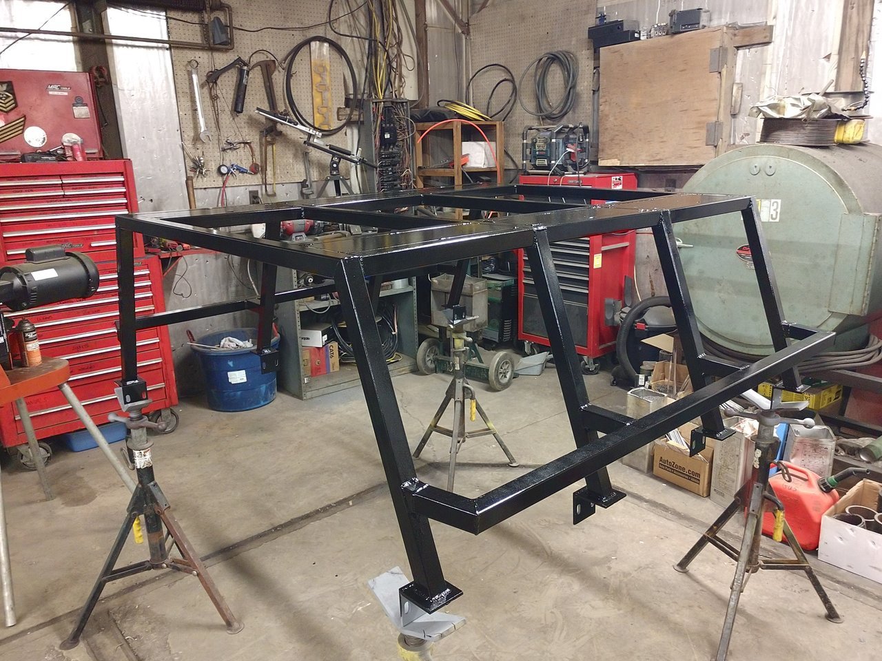

    UPDATE:
    Here is the finished product created for @MHARMS. From inception to completion less than a week!
    Ill update tomorrow with pictures after installing this sexy beast on the truck!
    UPDATE 2:

    The bed bars are all made from 1 1/2"x1 1/2"x1/8" square tubing and are full penetration welded at all seams. A single bed bar will handle in excess of a #425 point load.
    The RTT rack design has 4 cross bars, 4 transverse bars at the top and an additional bar at each bedside for a step. The whole assembly is bolted to the stock tacoma rail system via supplied 3/8" grade 8 hardware. The weight of the rack does not bear on the bed rail system however, bearing plates sit on the bed sides. The bolts are there into the rail system just to ensure nothing slides front to back.

    Fruits of the weekends labor, RTT bed rack. All of 1 1/2x1 1/2x1/8 square tubing. This is for a long bed, so bars are 60" long and 20.5 inches tall.

    Updated OP with pictures of the final RTT bed rack!
