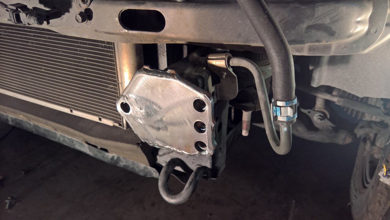

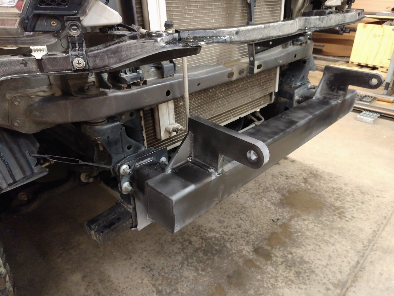

    Got some paint on @Redmann bumper! Plus the 1" solid bar soft shackle mounts, front outriggers, safety chain plate. Ran into some technical difficulties with the licence plate mounting / lighting.

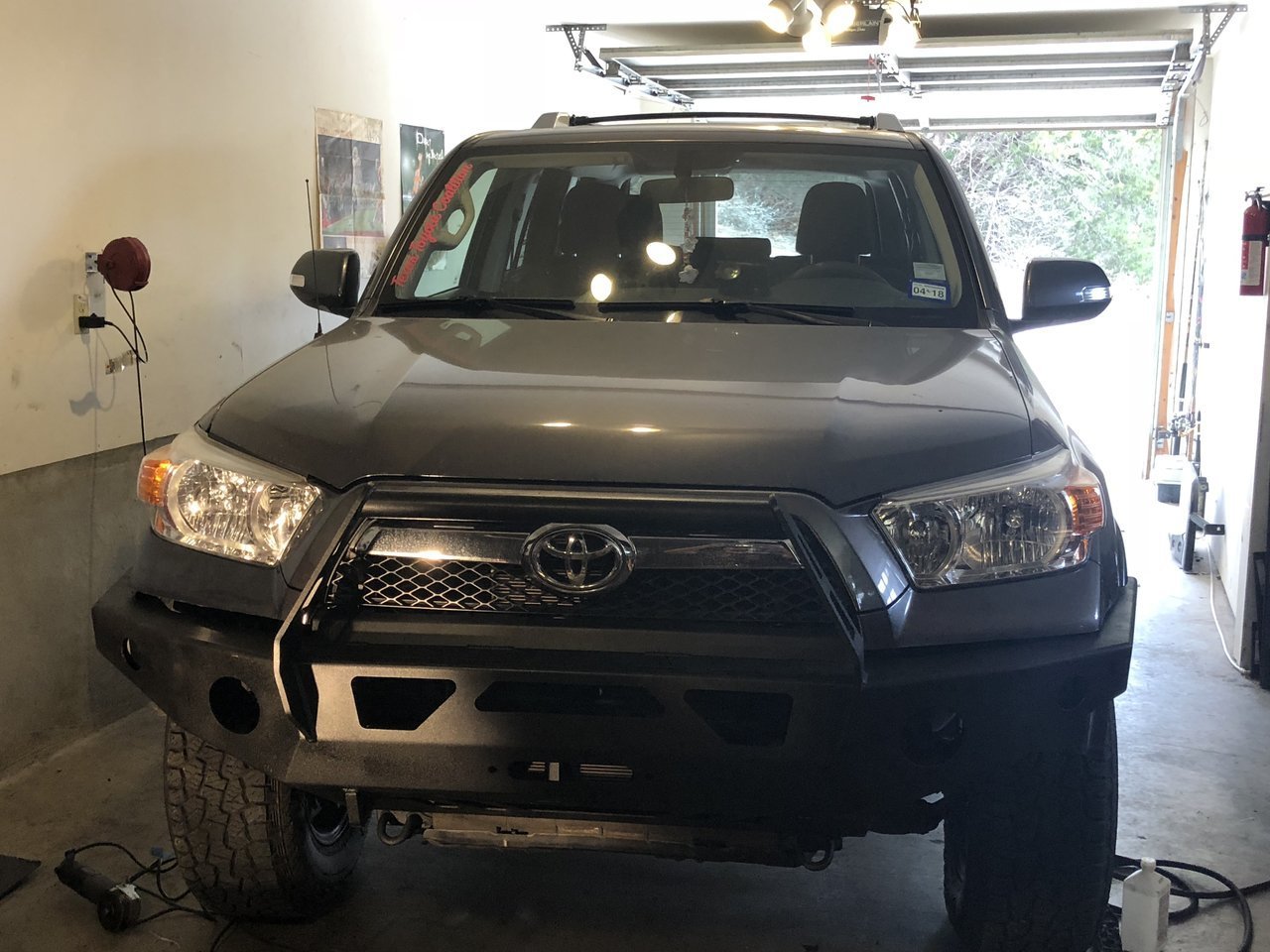

    A bunch a cool stickers, a bada ass MetalMiller Tx Longhorns grill emblem painted Hemi Orange, JBA long tube headers with o2 sims, Diff breather mod, Red LED interior lights, Fancy head unit that plays ipod n movies, Also DIY install factory stuff like, factory cruise control, factory intermittent wipers, OME nitro struts with 886x springs and toy tec top plate, JBA high caster UCA's for better alignmnet and dey beefier too, Old Man Emu Dakar leaf springs in da rear with the gear, U bolt flipper, Ivan Stewart TRD rims with 33" K Bro 2's, some bad ass weather tech floor liners so I don't muck up my interior, an ATO shackle flipper for mo travel in da rear wit the gear, also super shiny Fox 2.0 shocks back there too, all sorts of steal armor for bouncing off of the rocks like demello sliders, AP front skid, trans skid, n transfer skid, demello gas tank skid, and a tough as nails ARB bumper with warn 8k winch, I'm sure there's more
    Got these installed yesterday prior to installing the CBI bumper on my wife's 2013 T4R. I drilled the holes out to 1/2" rather that what the instructions say of 9/16" for a tighter fitment. I think 1/2" holes are better especially fitting aftermarket bumpers. Got nuts n plates welded in and painted, looks good n strong now.

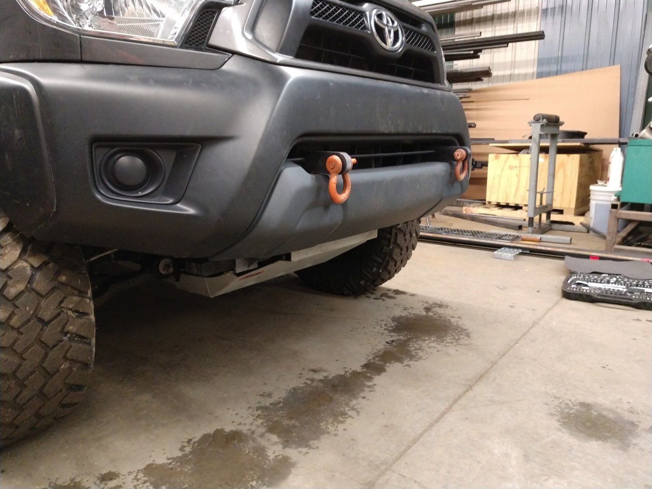

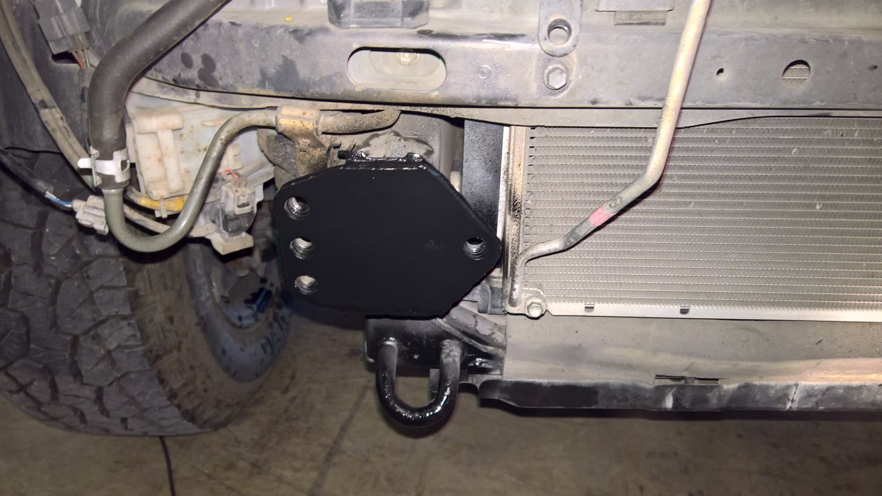

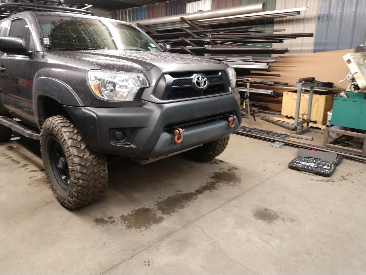

    Look what we have here!

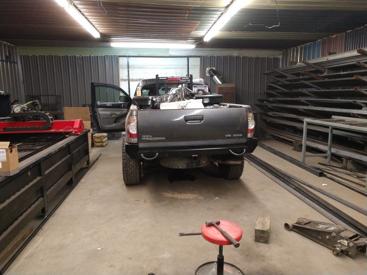

    I like it. I would definitely put those rubber DRing isolators (or whatever they're called) on them so they don't wear out the plastic.

    Bolts should break before that.
    Nice

    Ran out of time for the frame reinforcement plates and 1/2" grade 8 bolts. I need more hours in a day!
