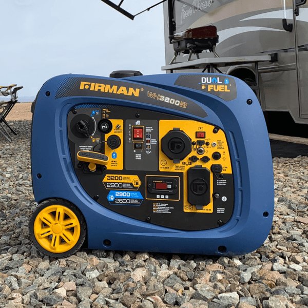

    I know you mentioned no room for a gas generator, but there are some small options available. Why not get a 3200 watt peak generator?…they aren’t that big and I have plenty of room in my short bed for other things and can have a full bed of gear with the generator. The cost will likely be less and it’s mobile. I use the dual gas (gas or propane) Firman brand from Costco and I’m impressed with how small, quiet and efficient it is (1.8 gal tank takes about 2.5-3hours to empty). Using propane it’s starting watts is 2900 vs 3200 with gas. Plus it was $599. Also, if you have other uses it can run other things like a travel trailer AC unit…just a thought

    Boss bought a firman generator to use propane. The pos battery wont hold a charge so i have to plug in the 110v so the electronic gas valve will open to start the genny. Total shit show.
