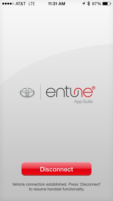

    Just making sure. Your screen is like this right when you launch the Entune App?
    E64A6D3A-0E3F-4E50-9C2D-A9C1ECC4FEDF_zps_be2c3e4f471d48096885aa28743b739e78f07c92.jpg

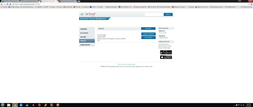

    Hi Craig, Have you gone here and set up your my en tune account? https://www.myentune.com/login.jsp
    This is where you set up Pandora and other apps. Put in your username and password for the APPS and then close and re-open the entune.jpg APP.

    Yeah I set it up when I got my phone and downloaded the app (which I've deleted twice now just in case).
    I've linked all my accounts with entune but nothing but the phone calls work. It shows the phone hooked up with BT just nothing else works. Entune shows my truck correctly on the account page
    Like I said it works fine with Android
