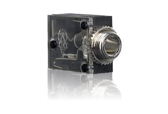

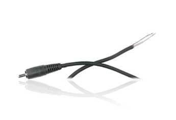

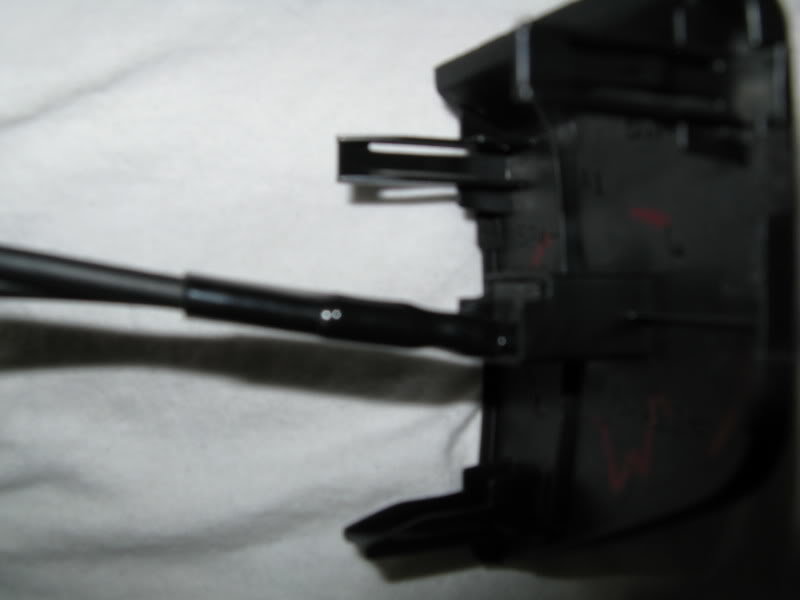

    I was a little disappointed when I found out that the 08 tacomas didn't come with an IPOD input or at least a regular 1/8" headphone jack AUX input. So after reading some reviews on this forum, I decided to buy the USA SPEC PA15-TOY. I was going to get the GROM interface but it doesn't have an AUX input. I have a shitty MP3 player so I use the AUX input, but my girl has an IPOD and it's nice to have a specific IPOD adaptor when I need. So now I can use both.
    check it out fellas.
    i basically followed directions from this guy,
    http://www.acceleroto.com/pa15toy/
    except i bought a few things from radio shack to install into the plastic cover below the air condition vent
    http://www.radioshack.com/product/index.jsp?productId=2103451&cp pRS1C-2265991w345_b026e2759c0a51581b9c40c6eaead06b074384b8.jpg
    http://www.radioshack.com/product/index.jsp?productId=2103848&cp pRS1C-2266503w345_f25c3f5143e202fa47d509653de7cf26863aa06d.jpg
    and some Superlock high temp/strength fasteners (velcro), to fasten the interface
    http://www.radioshack.com/search/index.jsp?kwCatId=&kw=6402360&origkw=6402360&sr=1

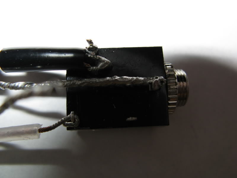

    all it took was a little solder here (btw...i wasn't finished soldering when i took that pic)
    some heat shrink tubing to cover the wires

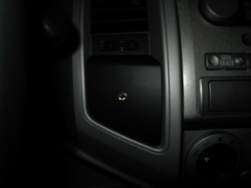

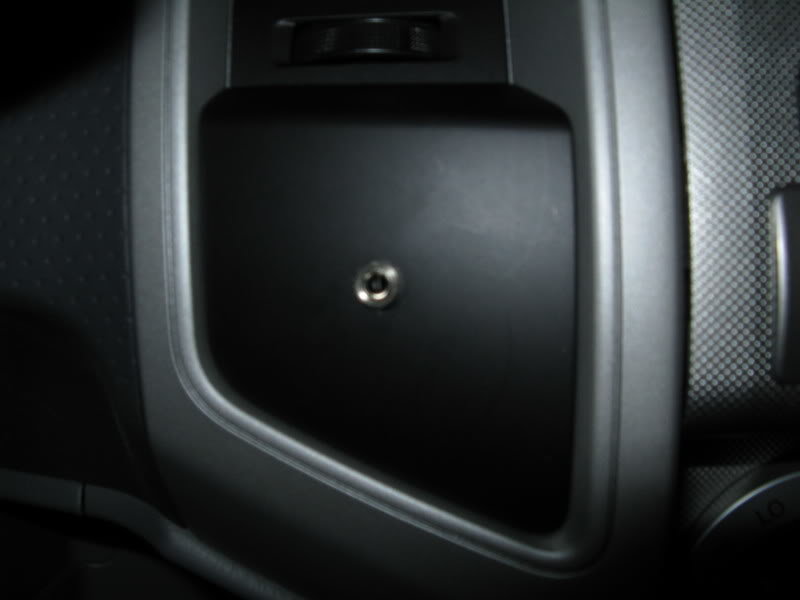

    install...and bam here it is. it looks good and better yet it works f**king great.
    also, I ran the IPOD wire out through the glovebox, didn't take a pic though.

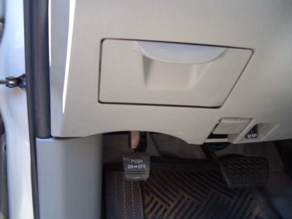

    Nice work man, but thats where my 4x4 switch is..doh

    Yea Homer, but you have a double cab now, so you should be able to do it on the other side where the passenger side airbag cut off switch was in your X since if memory serves the double cabs do not have the aurbag off switch.
    Edit: Oh yea, that is a great looking install BTW.

    Thats right there is no switch on that side in the new truck is there. :D

    thanks guys. i wanted to put the 1/8" jack on the passenger side originally, but i have that damn airbag switch there, so i had to move it.

    Nice install!

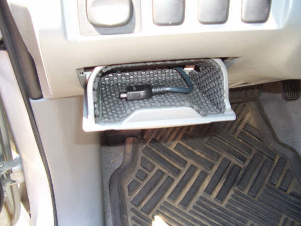

    Pics of my Ipod cable:
