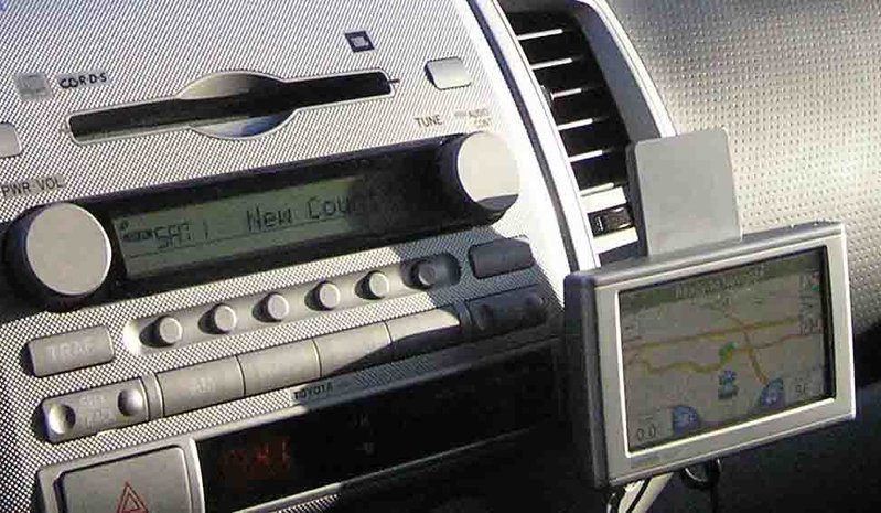

    It looks from the picture the sound linq has the extra set of aux inputs. I'll have to check to see if mine has the extra aux input also.
    If mine does have the extra aux on the sound linq, what cable would I need to buy? would it be some kind of RCA cable plug to ipod connection? or do you need to buy the usa-spec pa12-toy and plug it into the sound linq?
    Just trying to get an idea how you did yours, I don't care if mine does not display on the radio.

    wow! I'll have to look for my sound linq box this weekend. Very nice set up! Boy, it would be nice if it is that easy, just plug into the RCA jack on the sound linq and plug the other side into my iphone head set jack. Thanks for all the info! I'll keep you updated if I find my sound linq box and get it running. way cool, thanks..
