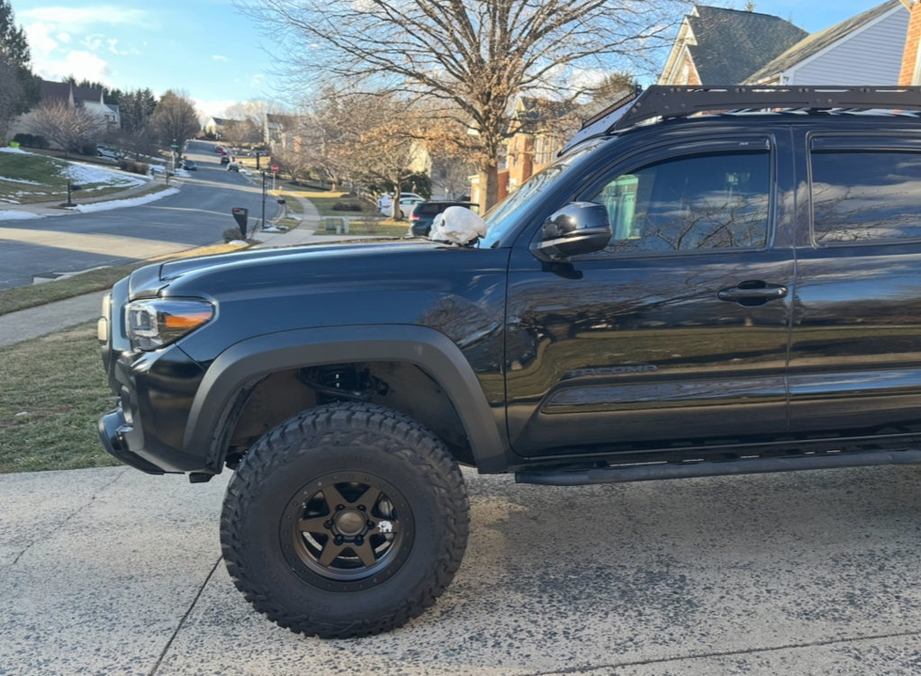

    I had those tires and ended up switching to Mickey Thompson Baja Boss A/Ts. They wore quickly and I missed a rotation or two and they needed to be changed after 25k miles. I’ve been really happy with the Baja bosses but I digress.
    Hope you like the kit when you order it! Overall it’s been a great kit for me. Just stiff with my lack of weight. Only have engine skid and sliders.

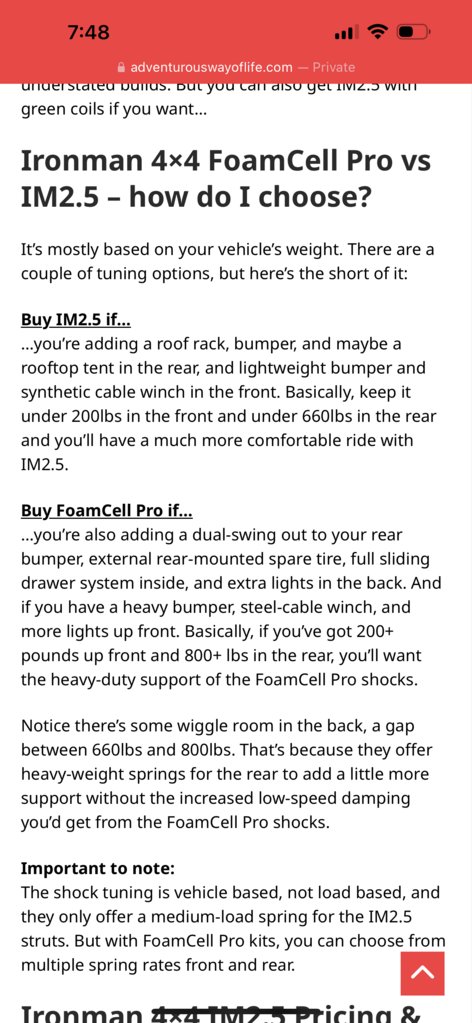

    Saw this while trying to find reviews for the new kit, might help-

    im2.5 havent been tested and being it's a monotube with pressurized gas it's going to be rebuilt.
    i always liked the reports on fcp going 100k + mi without getting rebuilt- this is the reason why i dont want kings, fox, icons- $4k with 90 days warranty and needs to be rebuilt at 30-50k miles. dont want to spend that kind of money to rebuild.
