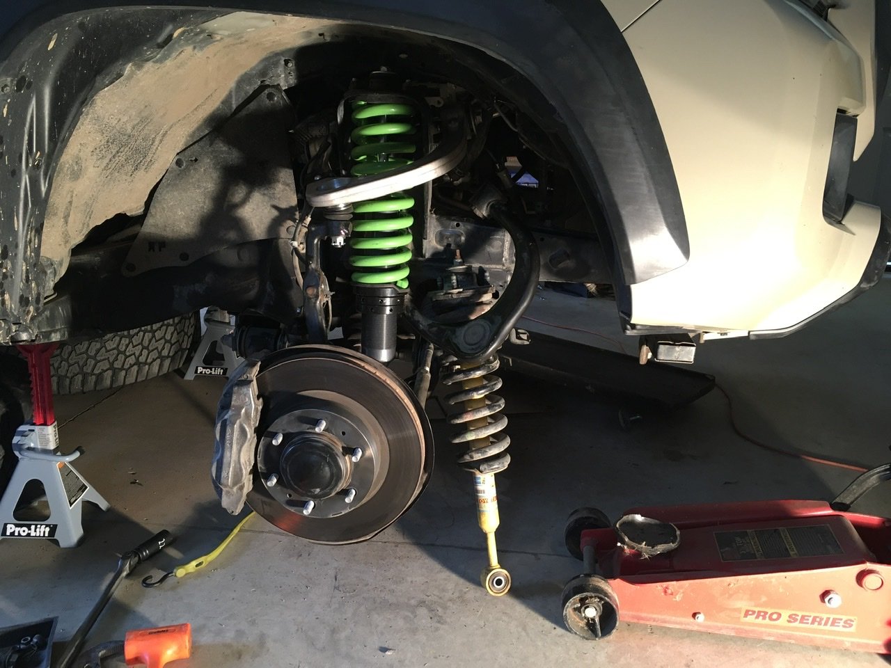

    I mean, after seeing this video from ECGS's page...
    It seemed pretty cut and dry for me. Lift the truck and the angle of the axle on that bearing changes dramatically.
    Whether people had issues with the stock needle bearing post-lift or not, time will tell, but it is worth pointing out that it got a mention in Toyota's Safety Bulletin :notsure: Also, didn't opt for the pricey one-time-use tool either as I'm going to attempt to use a free tool from Autozone (pilot bearing puller).
    If only I could find videos on youtube of people NOT having great luck with it. I'd watch a person suffer for an hour as I take breaks from my own suffering :rofl:

    I’ve the cv axle out finally and some bogus jb welded attempt at making an ECGS puller. Still not convinced I need to buy a $40 nut and bolt tool. Am I too far in just to throw the cv back in?? :D
    Needle bearings looked great..
    hyrule_trd likes this.

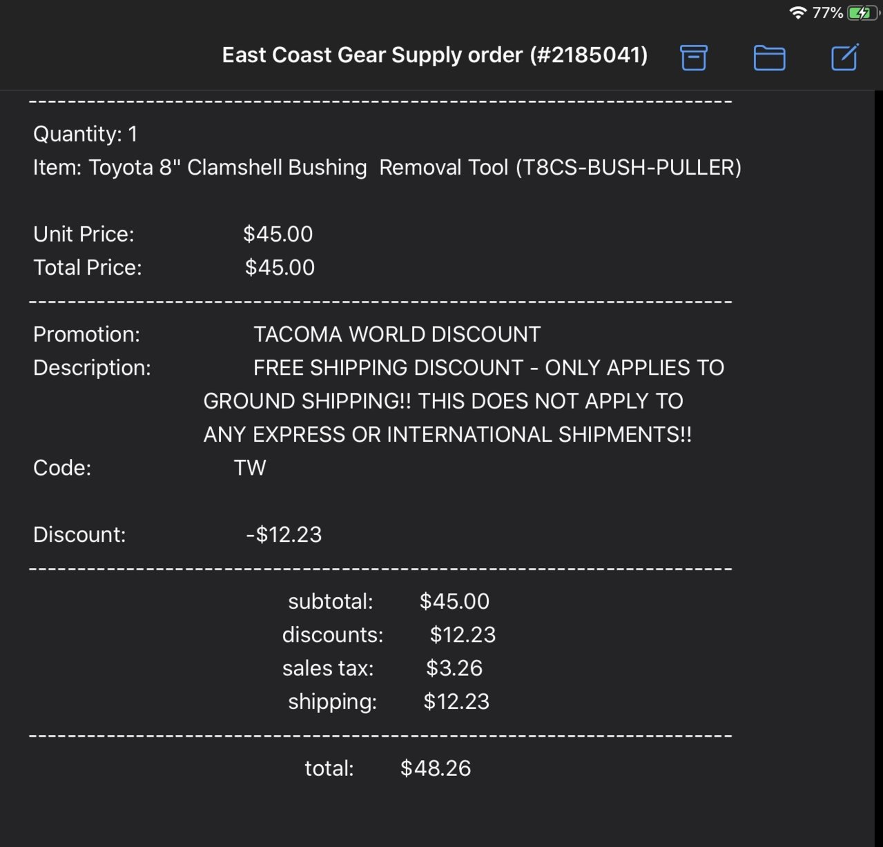

    @Devir7 I had to. And then while checking out, I was staring at the order form where it asks for any comments... lower price? be charitable and include with bushing? sell me the three pieces at cost and I’ll put the bolt through the hole?!
    Uff, hard to stomach that invoice, but I guess I’m far from the first to purchase and have that feeling.
