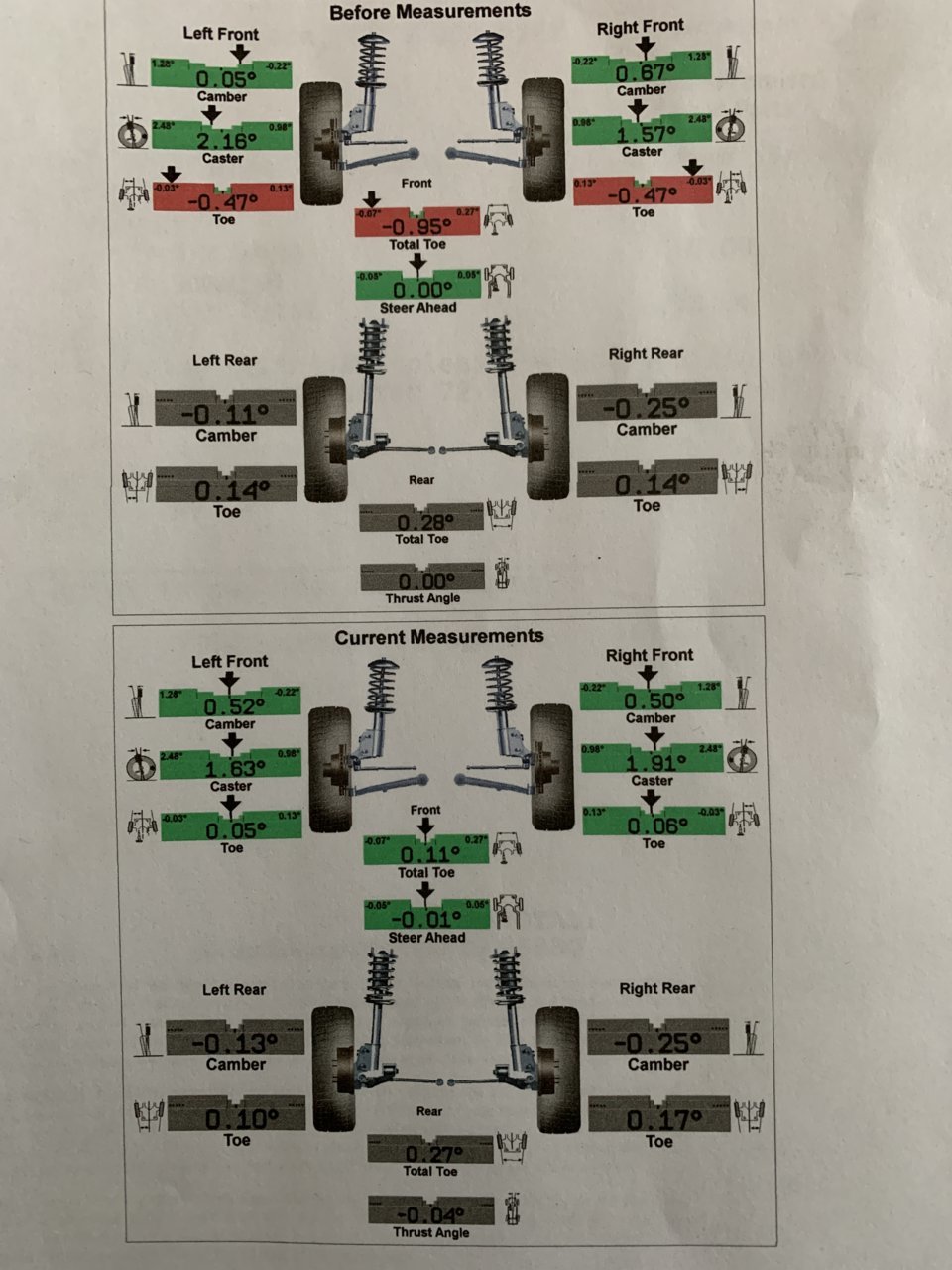

    Also, here’s my alignment specs. Went in with the ironman sheet and all figures were put inside their recommendations. Haven’t driven more than 50 miles but it feels solid so far.

    @mandog I'm a day late seeing your alignment sheet! I knew there were specs from IronMan, however somewhere along the 1,000 mile road trip and installation, I lost them and couldn't find em in this thread. (I know its here somewhere!)
    I thought it was more important to get it aligned before getting on the road again, so I ran it to 4WP who was awesome in accommodating me and getting it on the rack same day. They got everything "to spec" but the caster is lower than recommended by Ironman. And I didn't have the specs to ask them to adjust to.
    Here's how it landed:
    It does drive a bit "tighter" and I still have not experienced any rubbing, so that's a bonus. Tested full lock forward and reverse on level ground, we'll see what off road/camber brings.

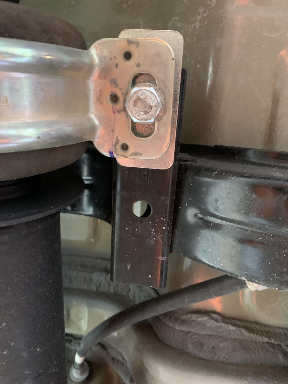

    Also added the center bearing spacers this morning.
    Washers provided were pretty small, so I threw some larger ones in. We'll see if I notice a change today.

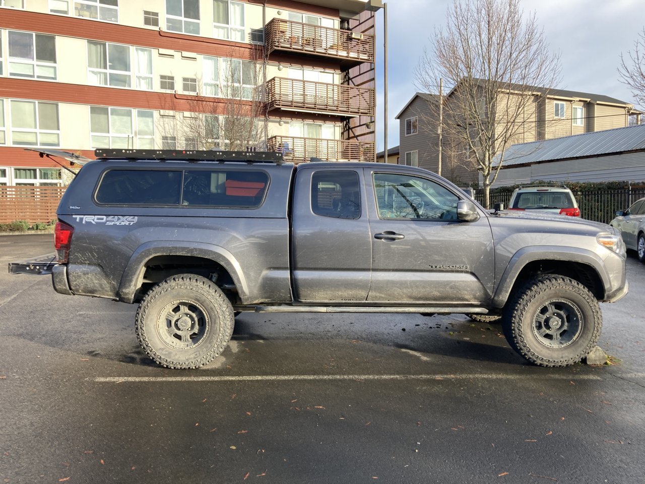

    Another data point for the Constant loads - I was completely loaded up yesterday, didn’t get to a weigh station but with my shell filled to the brim I measured and only sagged 0.5” on the Constants with 2 leaves removed.
    A651DE03-6122-4335-8933-44FAAE21E796.jpg 48B4C017-E12D-4821-923B-6647AF517609.jpg

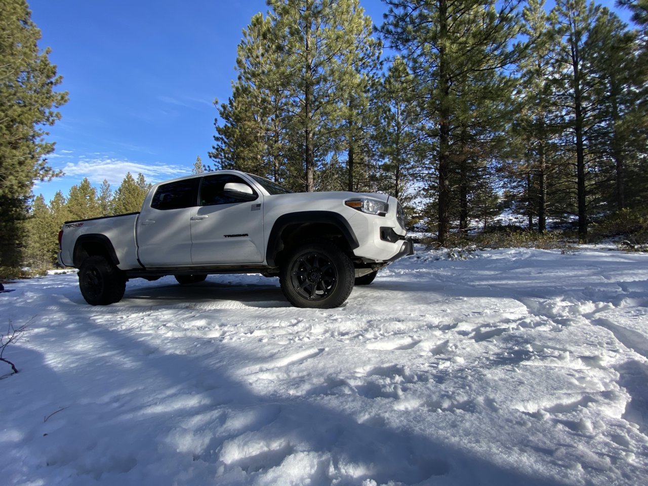

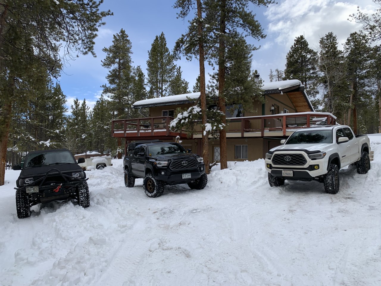

    Putting it through the paces to start out 2021! Out with a couple buddies who are conveniently also Tacoma owners @DarkYota . Nothing like testing new tires and suspension at 32psi in 10" of powder :popcorn:
    Suspension was great! Will still be pulling the front down some more and going back for another alignment with the Ironman specs to reference. Haven't had any rub or harsh feedback. Did run around today with the factory suspension in the bed just to add a little weight. Nothing earth shattering. Great afternoon and hopefully more to come tomorrow! Huge fan of IronMan, especially for the price point and if you can get it on sale and a free item (treds, air compressor), absolutely worth exploring!

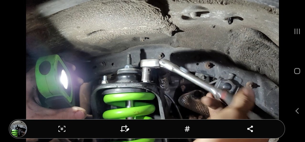

    Just installed my stage 2 foam cell lift! The stance is great and feels great! Howeverrrr... I ran into multiple issues with the install. The u-bolts provided are too short, a bolt stripped on top of the coilover, and the bolts for the brakeline support on the UCAs were not provided. Now, I get it, and the lift feels and looks amazing. But these little bits and pieces have definitely made me question the quality of this lift. I'll be getting in contact with Ironman and the reseller to try to get this resolved.
    Again though, the lift looks and feels great! Hopefully I can get these these things resolved. Will keep you guys updated

    Sounds like you had my luck going for you while doing the install. I’m sure they’ll hook you up with the right u bolts. I’m not sure about the stripped nut. Maybe they’ll send you a new top hat and cover it getting replaced but who knows on that one.
    I want to say I almost stripped one out and could feel that it was not tightening right and backed off and used a different nut. Not that it helps you now.
    Being cheap, I also bought the top hats off Amazon...

    Yup. I had same issue with the supplied U-bolts. They were too short for the constant load leaf pack. I emailed Ironman and they requested photos. I didn't have time for that so I picked up a set of longer Icon U-bolts from a local shop.

    I had the same top hat nut issue, I used my factory bolts as they are far superior to the ones supplied by Ironman. No issues with u bolts but I ordered performance and I assume you went with constants.
