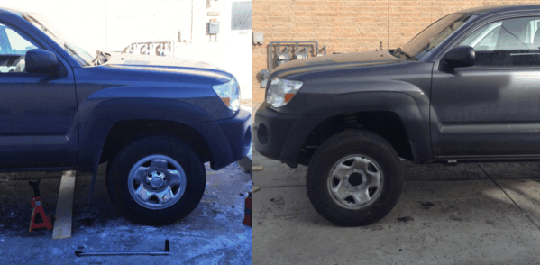

    Use an open ended wrench...17mm? Cant remember. And vice grips on top of the threads, not on the actual threads but above the threaded portion there is a flat portion you can grab with vice grips

    So the shocks and springs dont come assembled im guessing and your attempting the no spring compressor method to disassemble the stock coilover assembly?

    The rear is alot easier than the front. I was in the same boat a few months ago. I didnt have much experience with suspensions but i decided to tackle a full OME kit with dakars by myself. The front took me 3 times as long as the rear, i did UCAs also though. Although i left the stock shackle bushing in, and pressed OEM bushings into my dakars.

    is this all because you don't have a coil spring compressor?

    You really don't want to use home coil suppressors on these. They are way to beefy

    I used some cheap compressors on my 885s (590lbs) and probably longer than the ironman coils, but i do agree, it was pretty sketchy and i needed to use 24" woodworking clamps as well as the spring compressors to get the coil compressed enough. It would have been worth it to have them pre assembled or bring them to a shop.

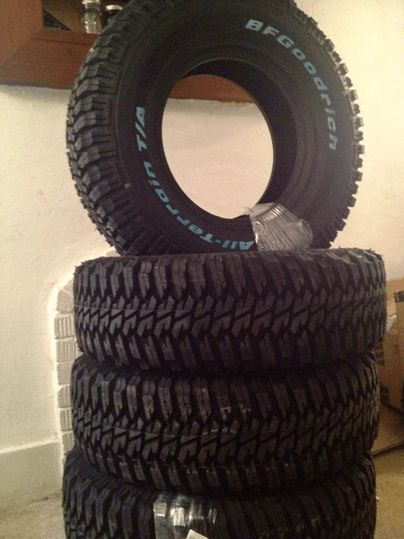

    Now time for taller tires!

    What size? I need to get my hands on some 255/85/16 or 265/75/16. My wheel well doesn't like the 265/70s.

    Do those new, bigger tires scrape at all?? It looks awesome with this lift, even with the smaller tires lol :)

    There won't be any rub at all unless you go to the 255/85 or 285/??. You don't need to trim anything. I had 275/70/17 I think on my old truck.

    Wtf, since when do bfg all-terrains look like that? :eek::confused:

    Gaurd Dog M/T's (re-treads with BFG shell): https://treadwright.com/
    Good tires if you can put up with the noise.
