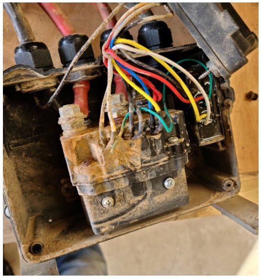

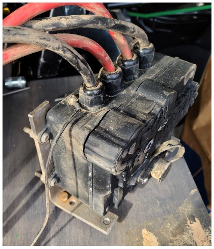

    I purchased an Ironman 4x4 9500 lb. winch with synthetic rope about three years ago. It has less than an hour of total usage, most of that clearing felled trees from a trail. I purchased it because of the features, slim profile, relocatable control box, and good review. It was also on sale, so it was a good buy.
    During the first use, the remote function ceased working. I thought it was batteries, and it was not. The one included was replaced and it still did not work. Not a huge deal as the cable still worked.
    About three weeks ago, I went to paint the rope near the barrel and respool the line as I hadn't done it after the last use. I pulled the line out manually, the plugged in the cable to start respooling, and the winch did not work.
    Trouble shooting was done with the help of Ironman support, and I ordered a new control box.

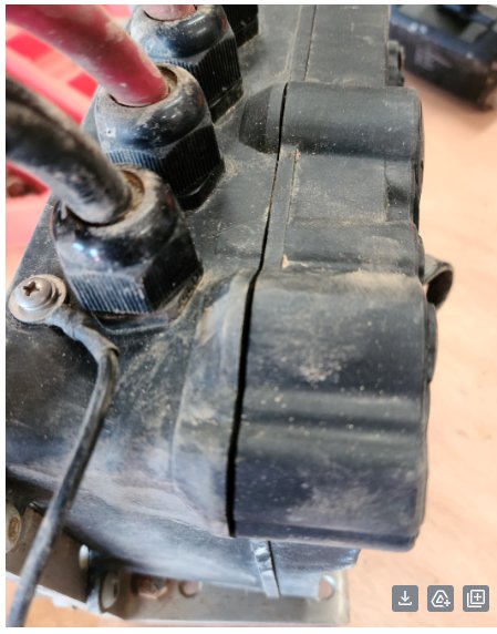

    The pics below are not edited. The cover of the control box, which is supposed to sealed and wet location mountable, was warped in the upper left corner where the Ironman logo is molded into the box cover. There is also a small lip, about 1/16" around most of the interior of box to help seal the edges. This is not present in the logo areas.
    When I removed the old box, the gap in the top of the box was immediately recognizable. I was able to easily put a reciprocating saw blade in the opening without any force. When the cover was removed, the mounting screw for that corner was still secure. Because that screw was still secure, as were the other three, I believe this is a defective design and needs to be remedied. It appears that a marketing team looking for brand recognition won out over effective design.
    If Ironman responds to my email, I will update the post appropriately.
    Pics below are not altered.
    This took no effort, the blade just slid in like it belonged there.
    Not sure what the green wire is, but it was disconnected when the cover was removed.
    The pic is a bit blurry, but note where the edge stops and is not present in the curved portion of the box.

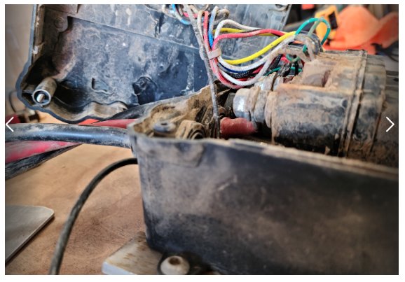

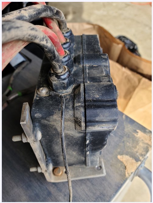

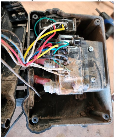

    Take Two
    First three pics show the gap on the curved portions of the cover. Box is yet to be opened.
    Demonstrating the size of the gap. That is a blade from a reciprocating saw.
    Box opened. Note the amount of dirt in the bottom corners and on top of the rusted screw next to the green wire attached to nothing. Is this the wireless connection? That stopped working the first time I used the winch.
    Note the flat edge in all of the curved corners as opposed to the lip on the rest of the box.

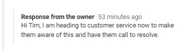

    Update.
    Two more attempts to reach Ironman. Crickets.
    I don't like public shaming, but...
    One star review, pics of the bad box, comments on the lack of response on Google reviews.
    We'll see.

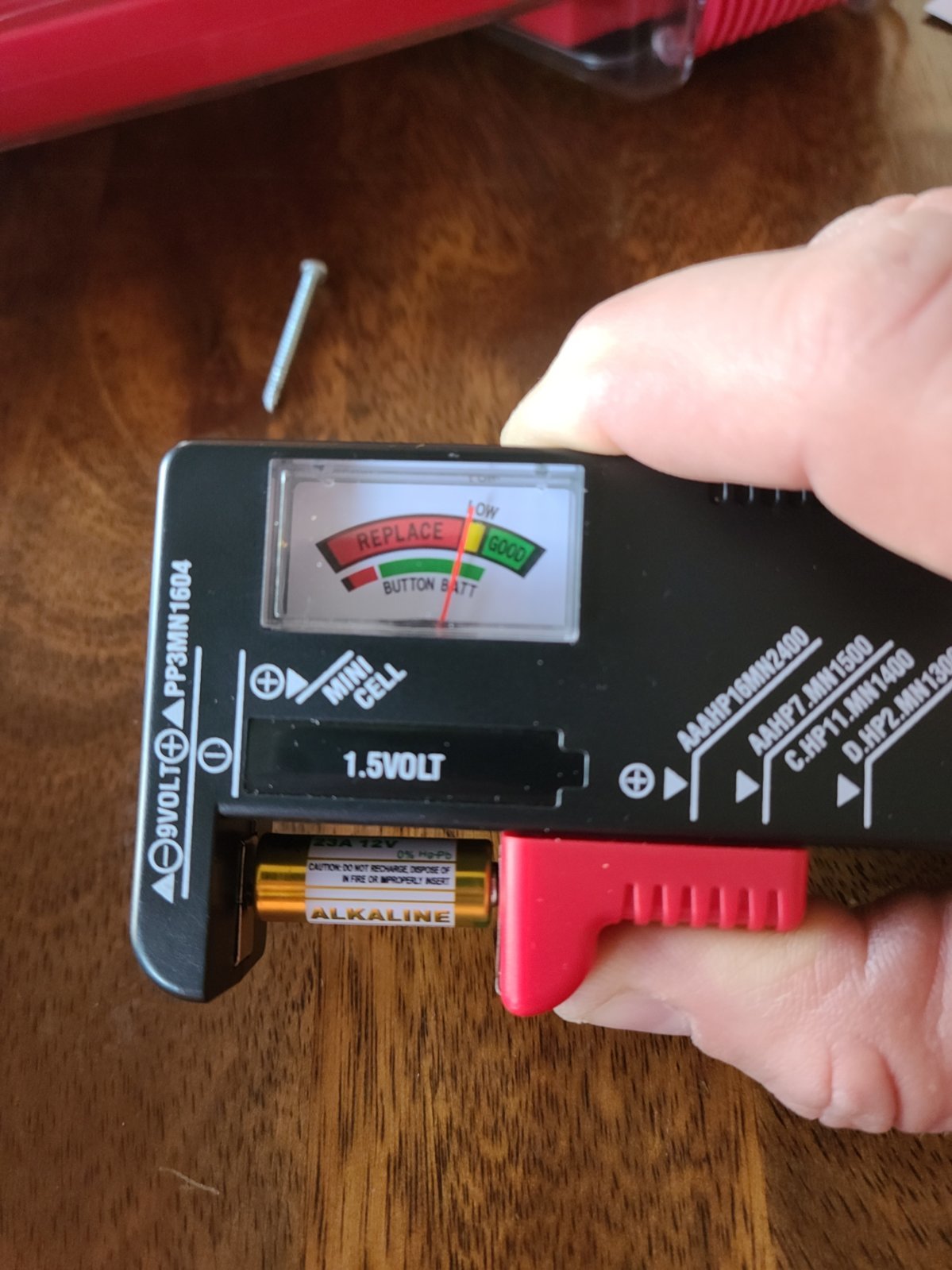

    They wanted me to test the battery. Battery was low, so instead of recharging it, I replaced it.
