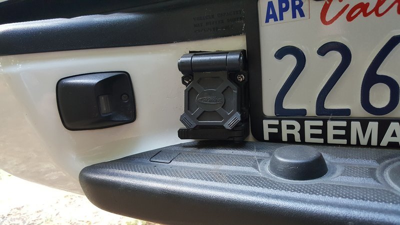

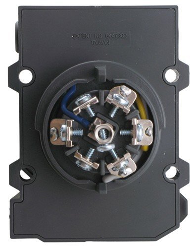

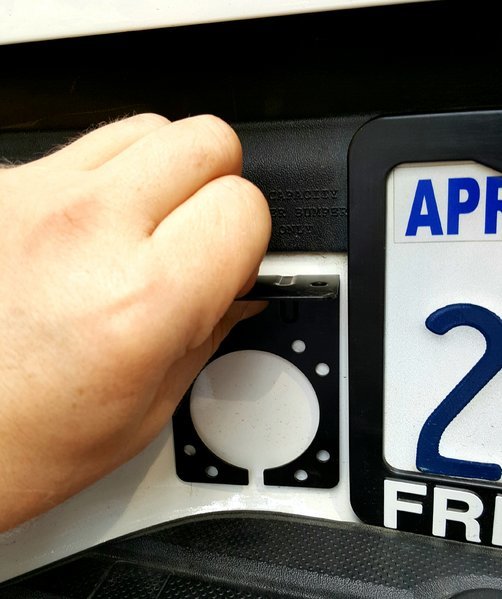

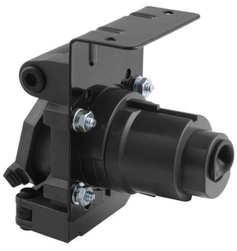

    Trailer plug relocation. after smashing my trailer plug, I decided to relocate it. the oem part is an absurd 150$+, so I found this Hopkins 7 round and 4/5 flat for 25$. take into consideration you don't need to purchase a standalone 7-4flat adapter and the price becomes negligible. if you are reading this and still have your trailer plug in the oem position, I recommend moving it, even if it means zip-tieing it up out of the way.

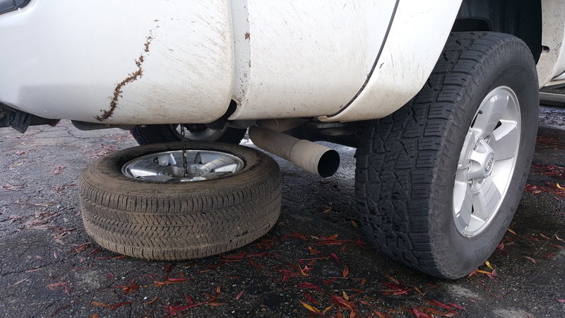

    Found a matching spare wheel, 40$ with some ok rubber on it. swapped my spare tire onto it. was looking for a cheap steelie for a 2nd spare but this popped up on CL. now I can strap my extra spare onto the roof rack for backcountry trips. I got a flat on a trip and had to be super cautious til I got to town.

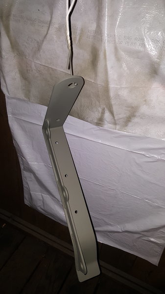

    Picked up bed supports yesterday, hope to have them installed this weekend ;)

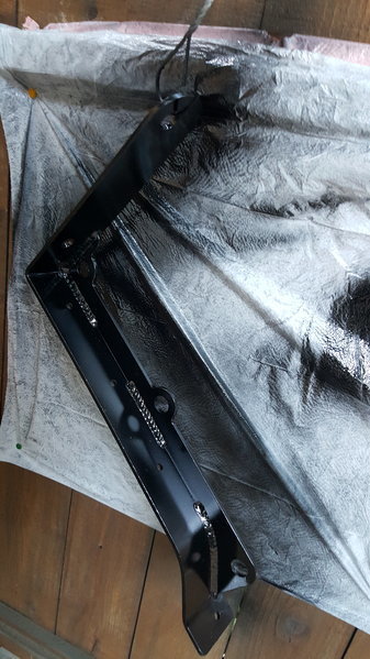

    installed bed supports today. I used washers (probably not necessary) as along with the button head bolts it matches how I bolted down my mobtown tailgate reinforcement. Used a come-along to pull the bed together before install. Left a military d-ring in place on the bed bolt. I have experience with the bed bolts from installing the d-rings, using a new bit and a breaker bar /air tool will help prevent stripping. Of course (duh!) I forgot to take a pic but Peter @Bentrodder can confirm I had visible spreading already occurring and, this looks to have solved that as shown below. thumbs up to a great product.

    Wow! Very nice. I have a severe gap difference from left to right side.
    Was wondering how these actually worked. I like the technique man!!

    First I tried a ratchet strap and it probably would have worked , but I had my come-along that I keep in my truck handy. I was lucky that it was one "click" to pull the bed slightly together.

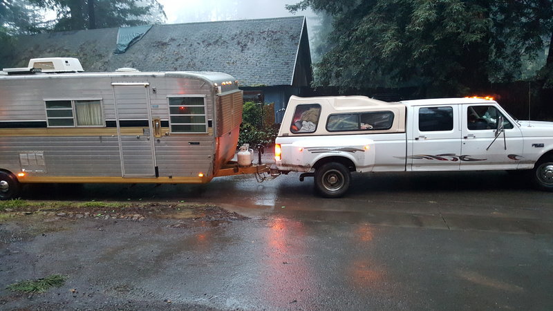

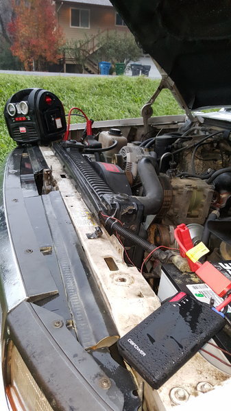

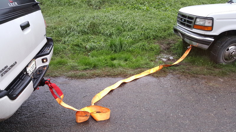

    Was able to help a friend today. His 7.3 Ford dually was dead and stuck in mud with a 30' trailer hooked up. Jumped the truck with a combination of LIPO battery pack and a traditional jumper pack. Yanked him out in 4LO with my tree saver and hitch mounted recovery point. Having all this gear really paid off today.
