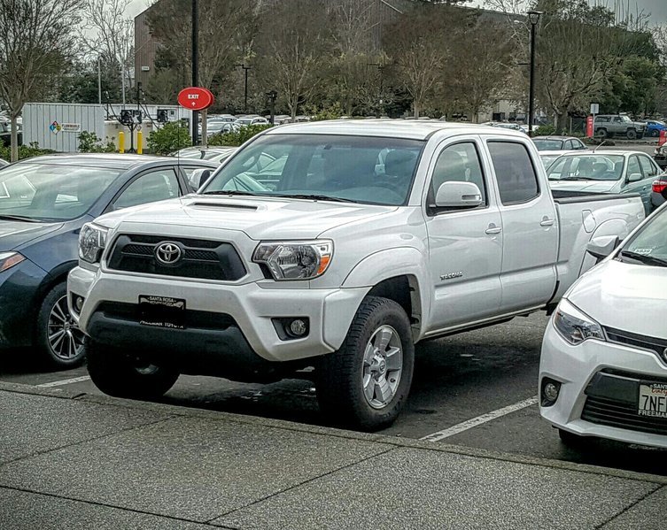

    So on to my 3rd tacoma, and what I have done to it and plan to in the future. Here she is when I bought her:
    And how she sits now:

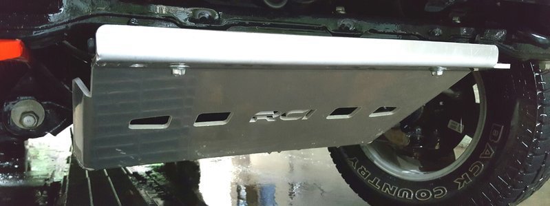

    RCI ifs skidplate (aluminum) modded to leave the factory support braces

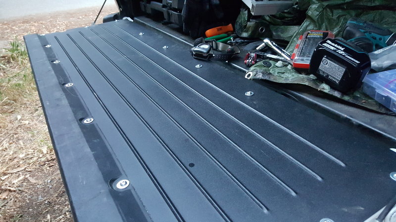

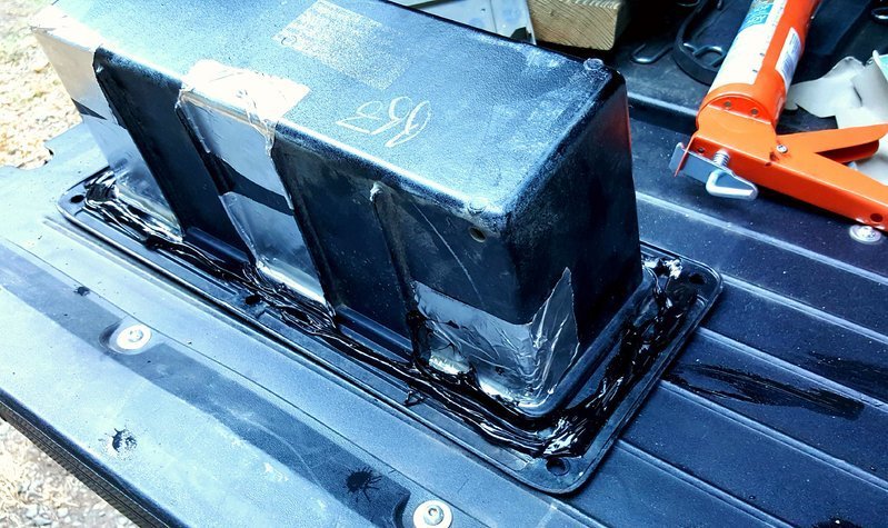

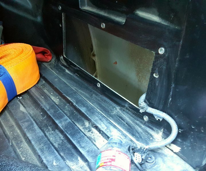

    Sealed the bed boxes
    I used metal tape and black silicon. yes that's my sweat and tears metal tape will cut you

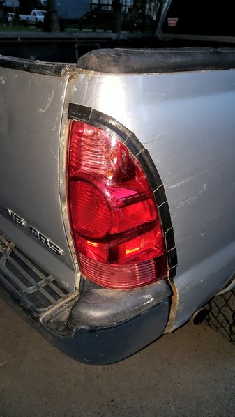

    Attempted to seal the tailgate against dust. I used these 2 things, hasn't been long enough to know if they work well/stay applied.
    edit, 3 months in , so far so good. the top portion of the seal where it "folds over" a bend has come unstuck, but that's all.

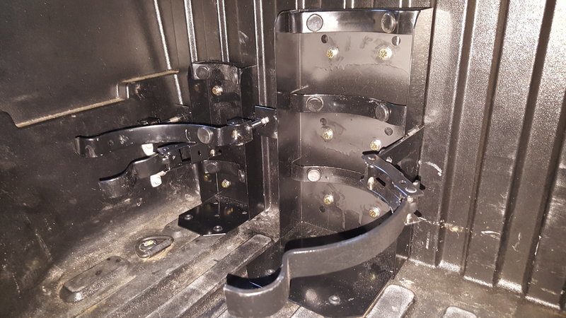

    Co2 tank and fire x mounted in bed,
    Bracket by Amerex, mounted with 6 pre bulbed rivnuts, grade 8 hardware

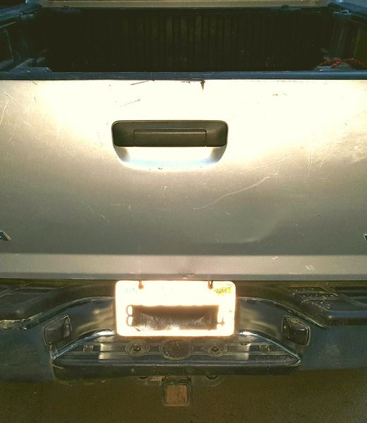

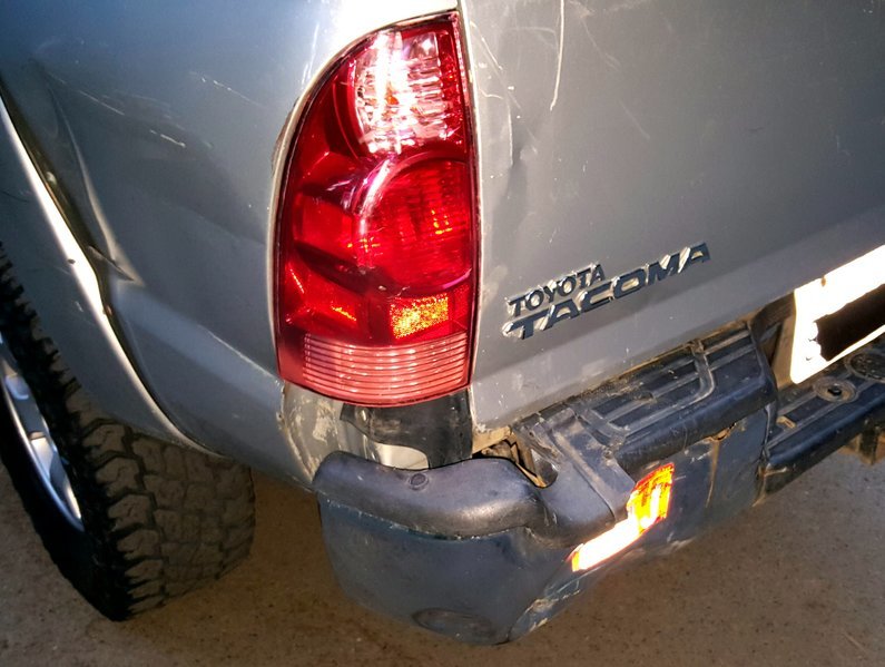

    I installed the tailgate reinforcement awhile back and I love it , thumbs up!!! You can see what happened to my unreinforced 07 tailgate below: @Mobtown Offroad

    RCI alu ifs skid, modded to leave the support braces from the oem splash plate. 20161024_164809 (1).jpg

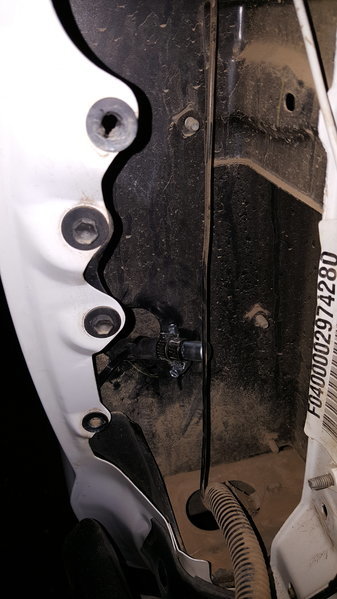

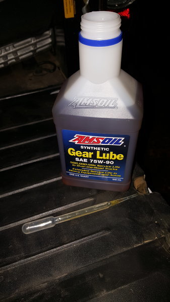

    Diff breather relocate. Because I added a two way breather and it's dusty as heck behind my taillight, added a few droppersfull of lube to the fuel line. Hopefully this catches any dust that might intrude. Prolly OCD overkill lol
    [​IMG][​IMG]

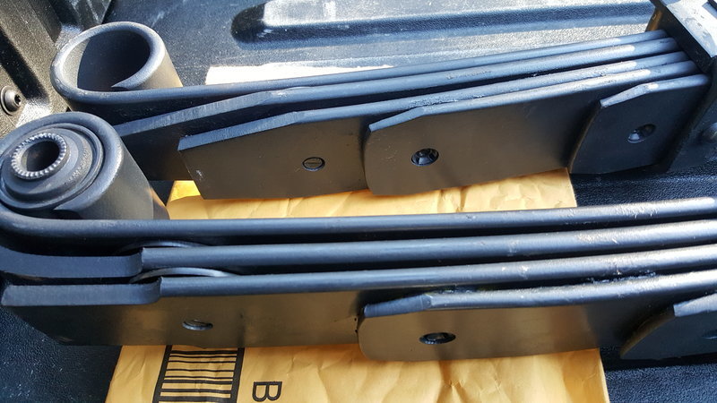

    I had my Dakar leaf springs broken down, drilled and isolators installed, before installation. Springworks Santa Rosa, 10$ a pop, 80$, . No squeaks!

    I ditched the doors when I Sealed them up. I guess there is a way to use electrical loom and glue to be able to keep the doors https://www.tacomaworld.com/threads/diy-how-to-weatherproofing-the-bed-cubbies.452381/
    but I decided against that. with the shell on everything stays dry. as for the tailgate sealing it is like 90%
