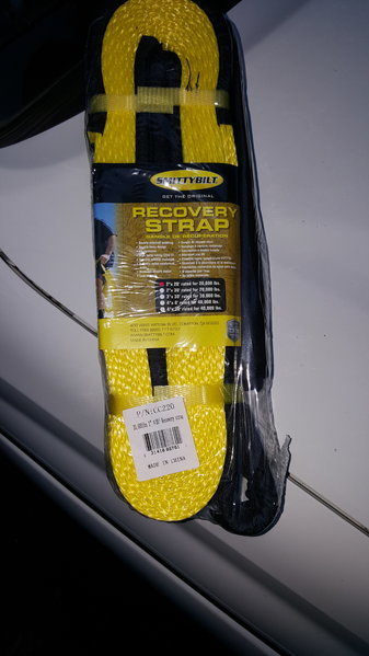

    Picked this tow strap up for 10$, found the deal on another thread. I have been using my fancy tree strap for tow duties so now I can stop dragging it thru the dirt and use this instead.

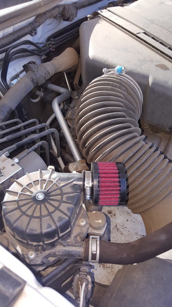

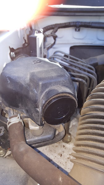

    Secondary air injection pump preventative upgrade

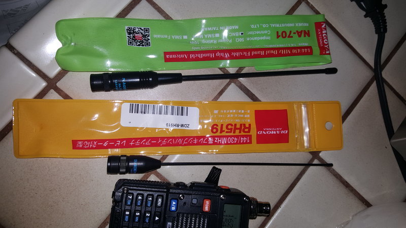

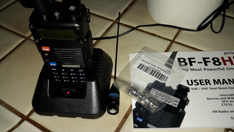

    So i decided to go with 8" aftermarket HT antennas because some studies you lose very little range/power. But what you gain is an HT that is easier to wield in the sense that it doesn't have this really long whip antenna flying around. The two I have are from diamond, and from Nagoya. Neither seem like counterfeit but who knows.the packaging was good and has a QR CODE that leads you to Nagoya.
    Note that these are both BNC connector antennas. This means that to swap from using the radio as a vehicle mounted unit with a rooftop antenna, to a HT you can walk around with only requires a quick 1/4 twist rather than having to spin the radio around and around to remove from the SMA connex. Connecting the 8 inch antenna is the same, a 1/4 twist
    So the Nagoya is noticeable beefier than the diamond, which feels very light duty. That said the diamond is super flexible and lightweight

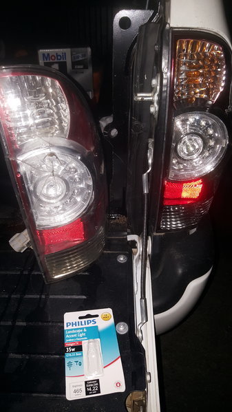

    Backed into a fence and cracked my taillight housing. It continued to work until a rainstorm in which it filled with water. When replacing the unit I installed 35w landscaping halogens in the reverse light socket. Over a 2x increase in output, and an inexpensive easy upgrade.

    How hot does it get with those bulbs?

    Not bad at all I've left them on for 10 minutes at a time and the outer lens was barely hot.

    Fixed that quote as the HIRs run cooler, draw less current/are more efficient, and put out more lumens than halogens. :) But the 35w halogens are a great upgrade if not wanting to order the HIRs internationally.

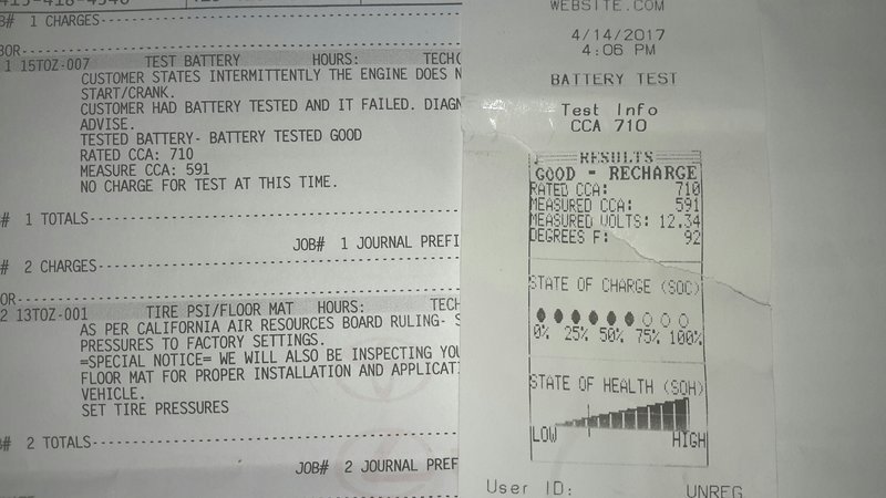

    My battery has been testing consistently low (12.2-12.5v) so I made an appt to see if the dealership would warranty me a new battery. They declined based on the tests they performed. They stated that they left the lights on for 1/2 hr and the voltage was still in the acceptable range. The results of the battery report are below. Naturally I was hoping to get a new battery today, I priced a 27f from the dealer and it was 150$ with battery return. Still considering a new battery, either from the dealer, or from walmart.
    Battery report
    Rated CCA 710
    Measured CCA 591
    Voltage 12.34v
    State of charge: 62% ? (Chart shows to be between 50-75%
    State of health: High (I disagree, would call it acceptable, barely )
    ChadsPride likes this.

    Have you checked out Interstate Battery on Industrial?
    Their alkaline batteries are shit, but I've ran their auto batteries for almost 20 years and never had an issue.
    ChadsPride and IronPeak[OP] like this.

    Yes I called them and left a message late in the day. The service manager at freeman hinted that that was my best bet. Was hoping to save a few bucks at Costco, they do interstate batteries exclusively now but they don't carry the 27f.

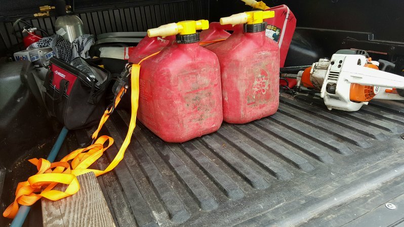

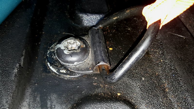

    Probably the best reason to add d-rings to the bed bolts. Stock tacomas don't come with good tie-down locations for gas cans.

    I found your post by using the search tool, do you know of dealers warranty batteries? I've got 29k miles and a year and half with my 3rd gen and I had to get a jump yesterday and haven't driven it since.

    My dealer offered to warranty my battery if I was under 3yr/36k. However it passed their tests, if barely. I would suggest calling your dealership and asking.
