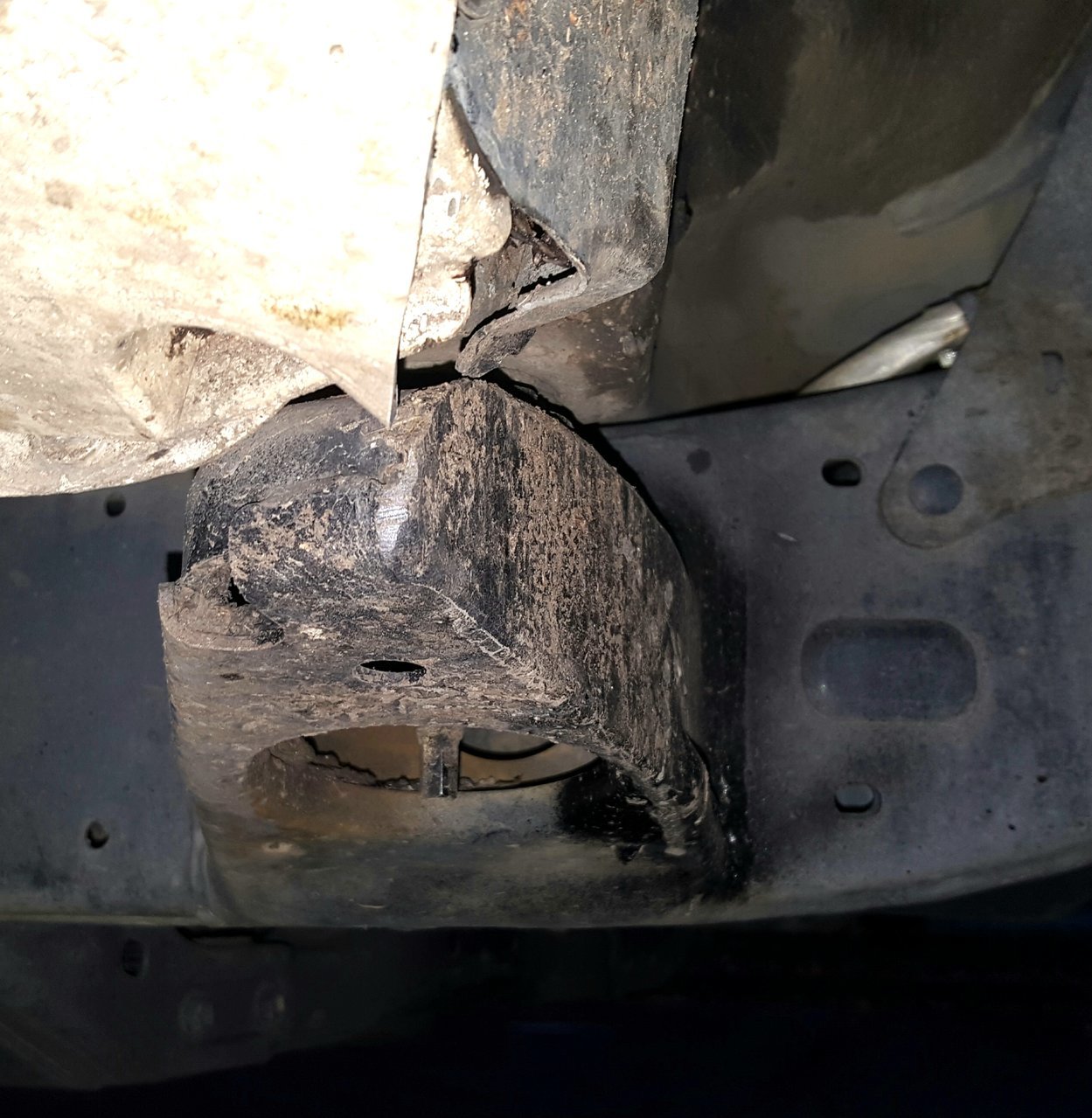

    What type of ucas do you have? are they still oem?

    Light Racing, keep the greased but they could very well be source of this annoying noise... planning a trip and am hoping to knock down this squeak, because squeak= metal on metal don't want a failure in the woods

    Are the light racing greasable? Meaning do they have a zerk fitting?

    Yep they do im going to give them a few pumps and see if that squashes the squeak might as well anyway
    Edit greasable ball joint, but not bushings

    K take tension off the bolt clean the area then push new grease in until you hear it pop or the grease starts to come out. Normally you will hear a pop sound and see the bushings start to move. Then re torque the through bolt and wipe away excess grease

    Shoot I edited my above post too late the light racing UCAs have a zerk for the ball joint but not for the bushings
    Just gave them 5 pumps, the boot swelled slightly so grease is getting in, no change in squeak

    Are they poly bushings on the light racing or rubber? If they are Polly they most definitely should be greased or else the squeak will continue

    Then your only option is disassembly to grease them.

    Poly and when installed were greased, I can see a ring of escaping grease at the edge of the bushings, and they were squeak free for 10k miles... maybe I should pull them and regrease

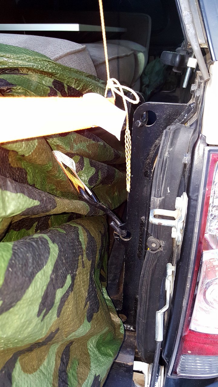

    Bed stiffeners being put to work moving-

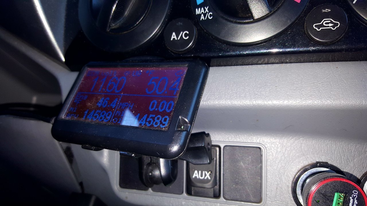

    Moved my UltraGauge over to a blank spot below hvac controls, need to route wire better
