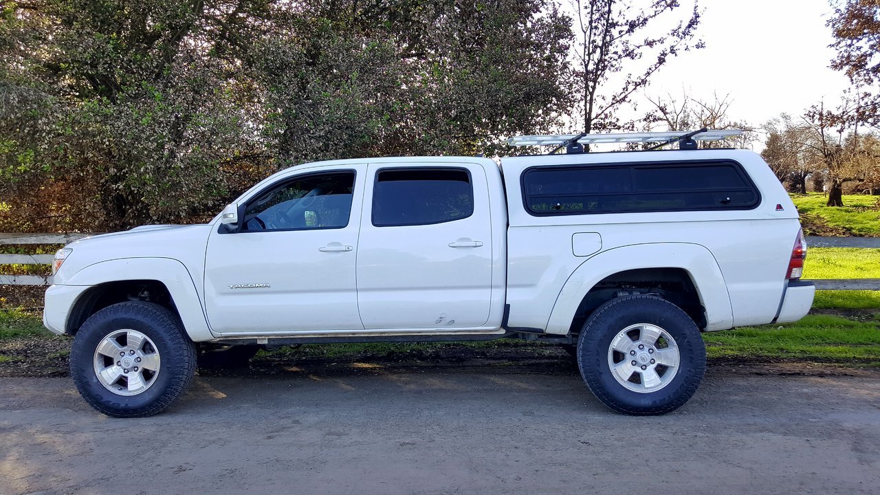

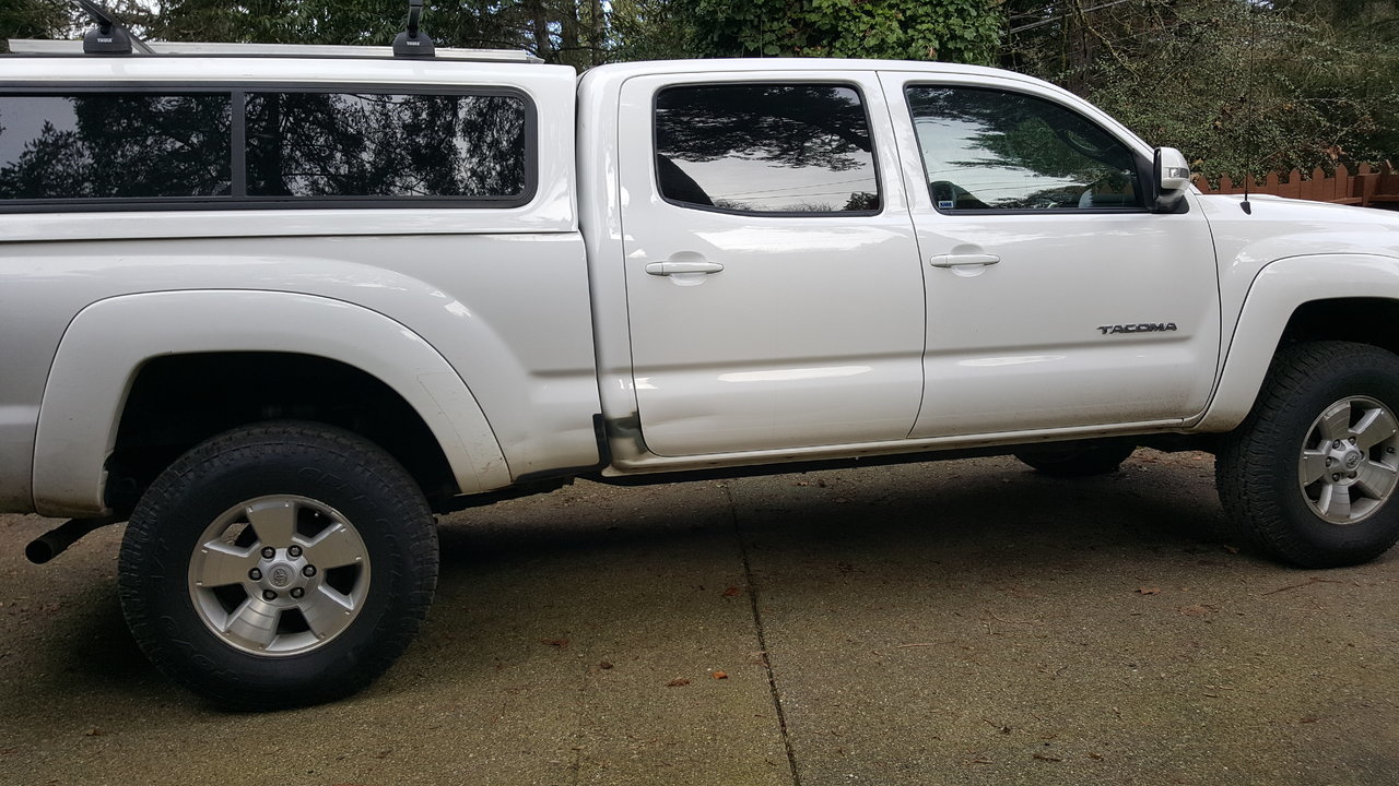

    Looks so right with this size, eases the trail limo look with the proportions. Plus added an inch clearance under. 20180130_153308.jpg

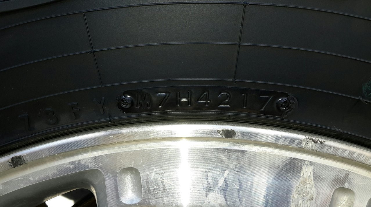

    Was pleased to note the tires were manufactured just 14 weeks before they were installed. I forgot to look at the shop before I had them put on and was relieved to discover they weren't a year old already or something. The first number refers to the week (42nd), then the year.

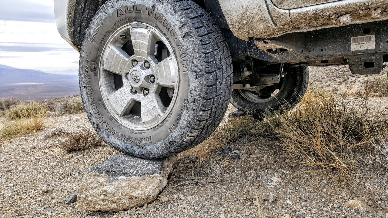

    Looks like I connected my bumpstops with my frame on the Death Valley trip, I don't remember feeling anything but the evidence is there.

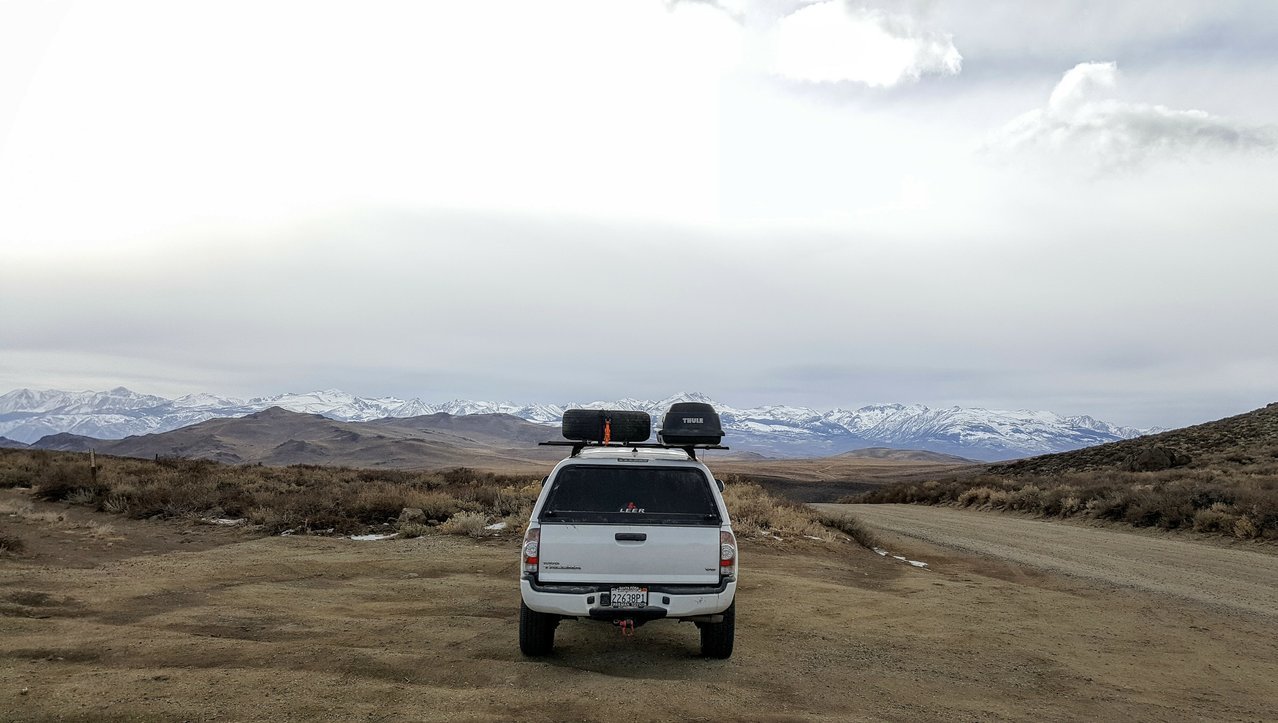

    Near the ghost town of Bodie, CA

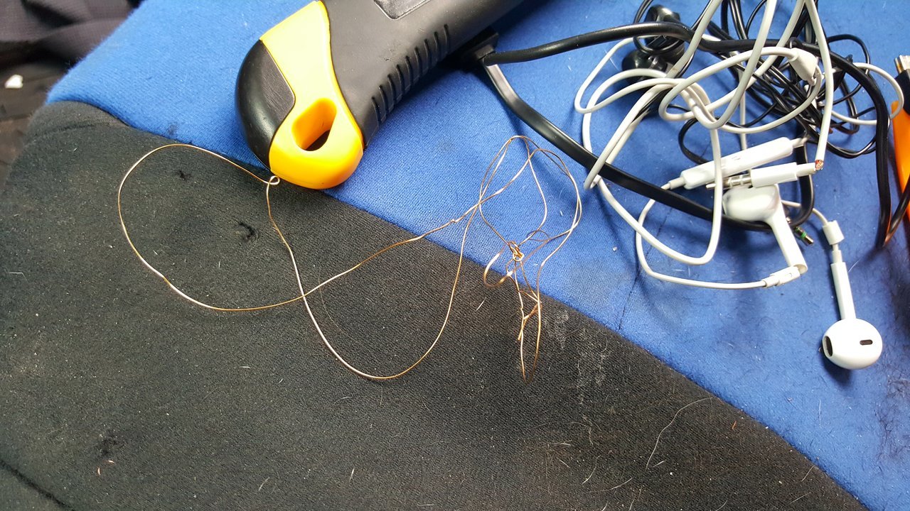

    Calibrating VSC . Using twist tie, couldn't find paper clip.... guess thing of past in this household, sign of the times....20180211_092921.jpg
    https://youtu.be/xbKEE9QlvUI
    Ez, took all of 5 mins. Thanks, @Crom !!!!!

    Ended up using some Xmas decoration wire laying around my ex wife hpuse. Recommend paperclip or solid core maybe 14ga wire as will hold shape better and stick in slots more securely. 20180211_105956.jpg

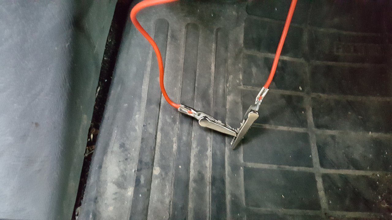

    So my VSC light remained on after the reset procedure. So I went through the steps again, this time very carefully. I used a test jumper wire with alligator clips. I cut it in half and stripped a half inch off, then taped the ends into the slots to make sure they didn't lose contact during the process. This made it easier to observe the dashboard. Now the VSC light is no longer on. Success!! I think before I jostled the truck or it wasn't perfectly level, or one of my connections at the OBD wasnt good. Either way, it appears to have worked this time.
    EDIT : feb 14 VSC still kicking in in certain turns. Will try a third time, the truck wasn't perfectly level before.

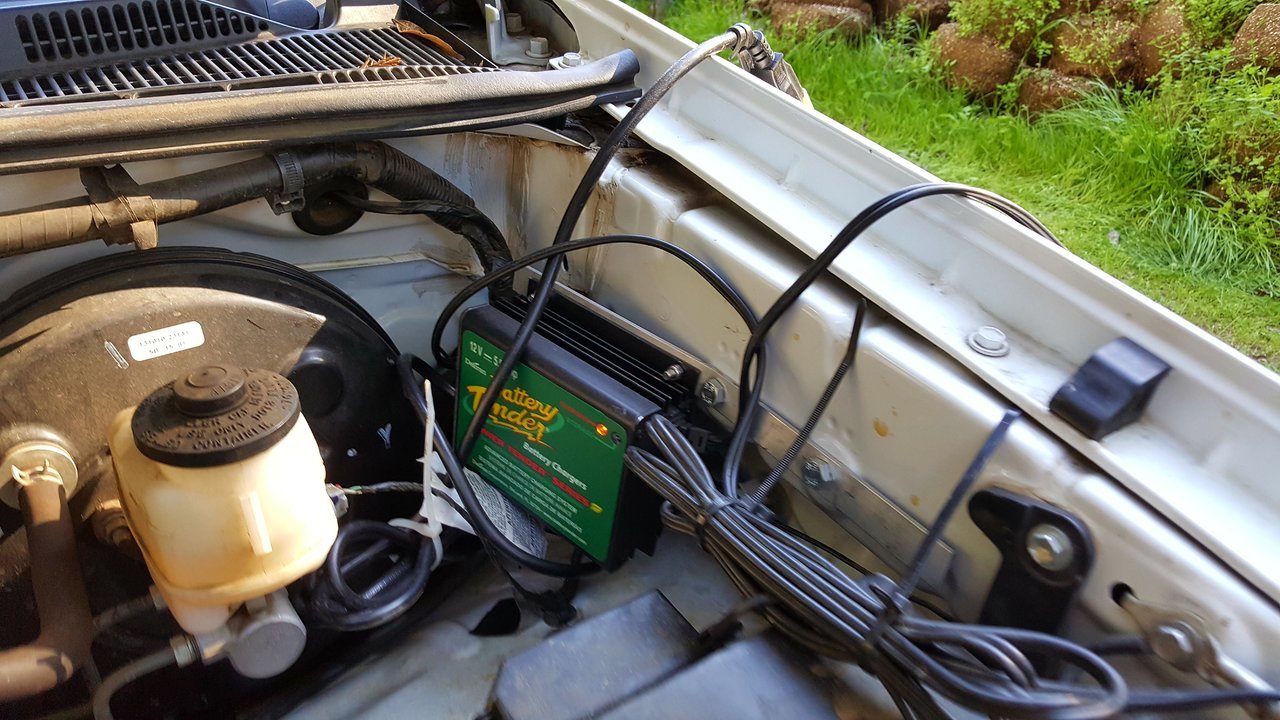

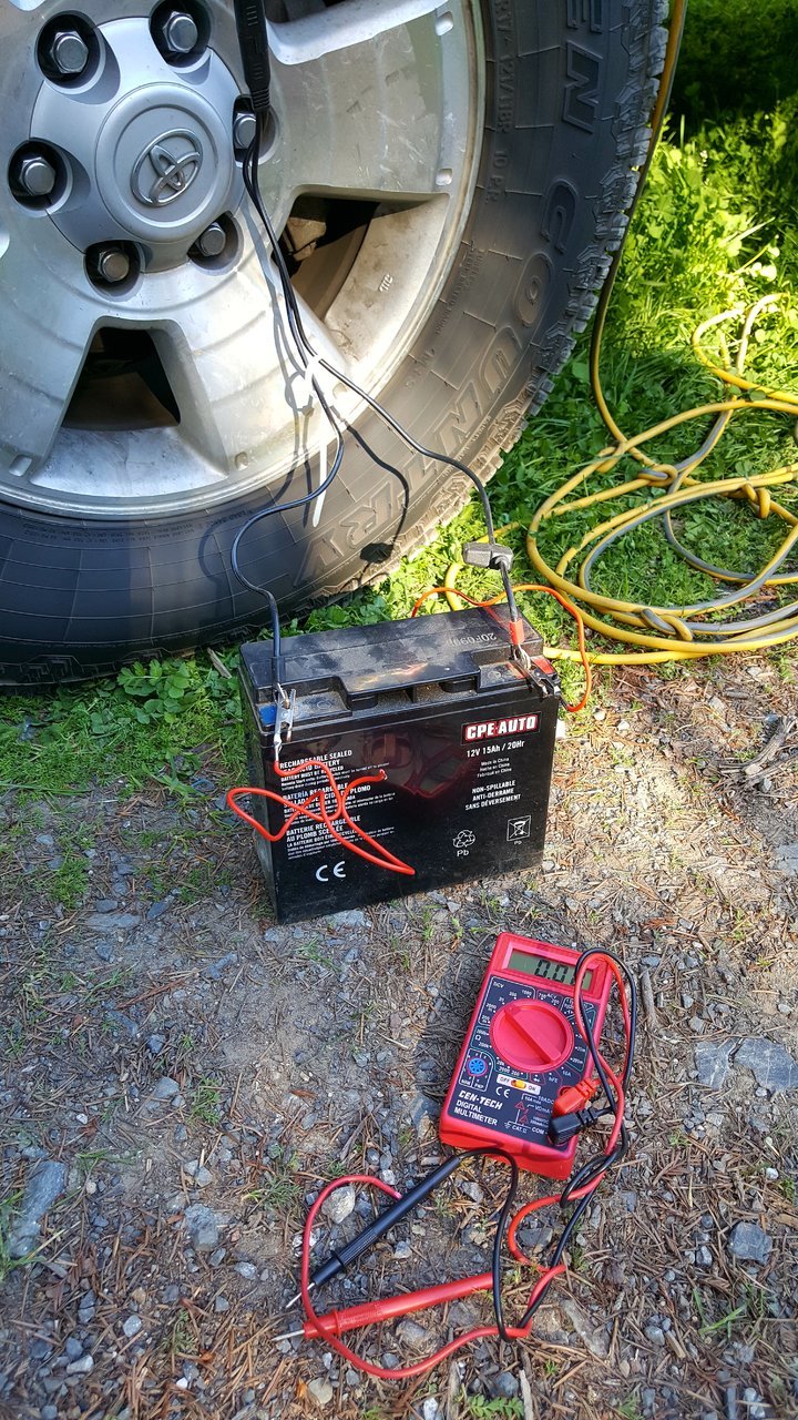

    I bet a friend lunch I wouldn't ever use the 110v outlet, lost today. Way off the grid, charging a generator battery with the 5A tender I mounted.

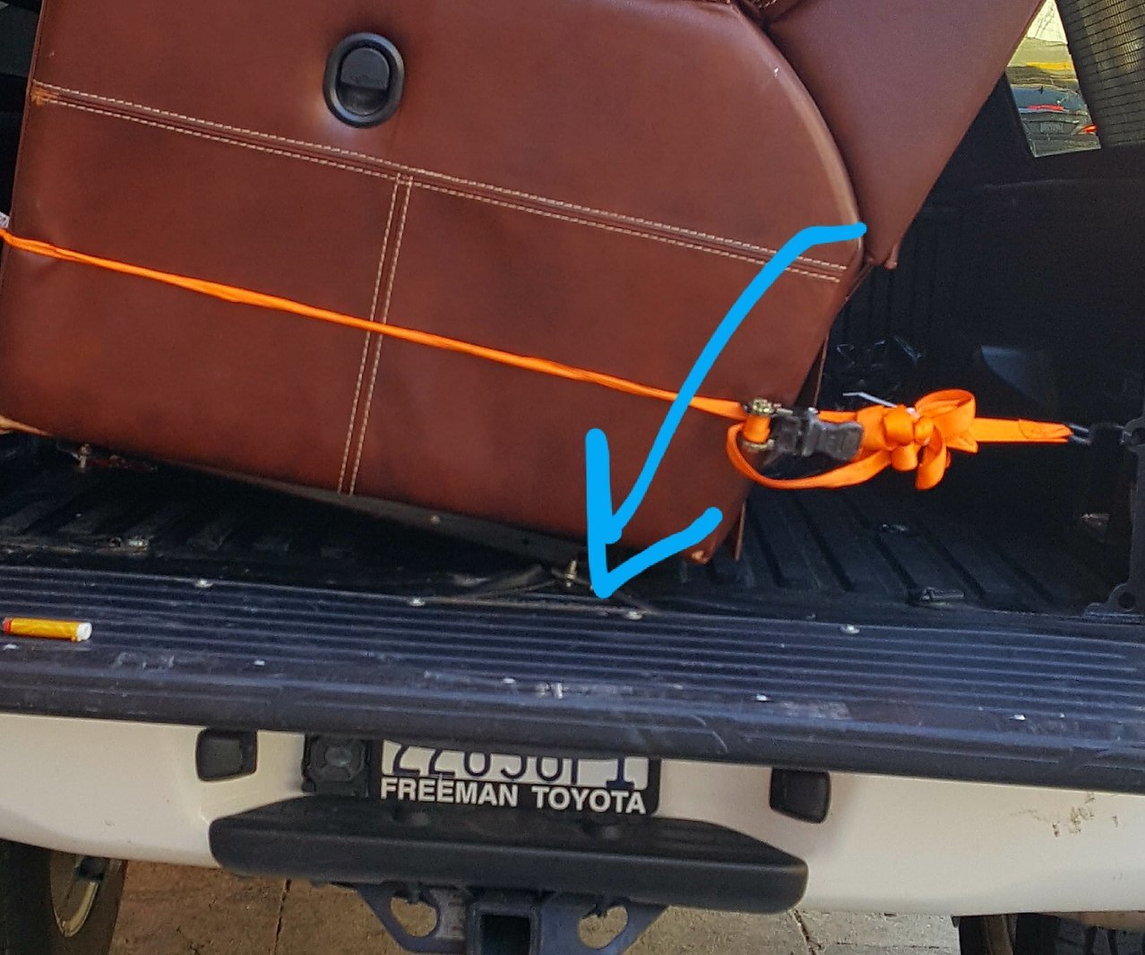

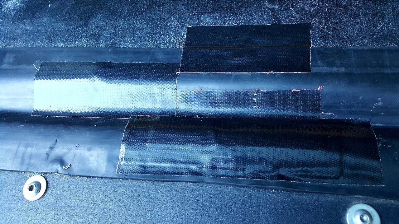

    No good deed... bed seal took a beating during move help session. Nuttin' a lil gorilla tape can't fix...

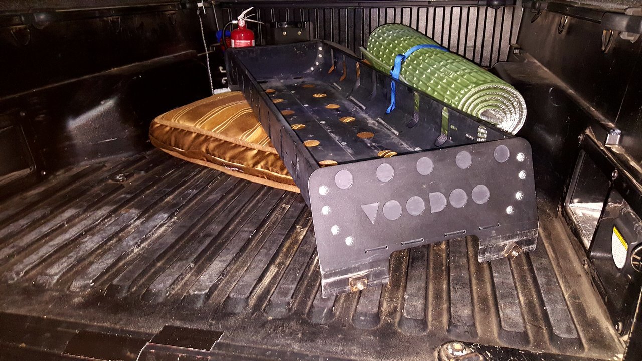

    Had the pleasure of meeting @zerotimeouts briefly today and picked up my new @KB Voodoo basket via @EDDO now to see if it fits, haha. Looks like it might have to go aft of the shell mounting point but we will see. Might turn back up on the for sale thread. Gotta love Tee Dub!!!! Thanks guys.
