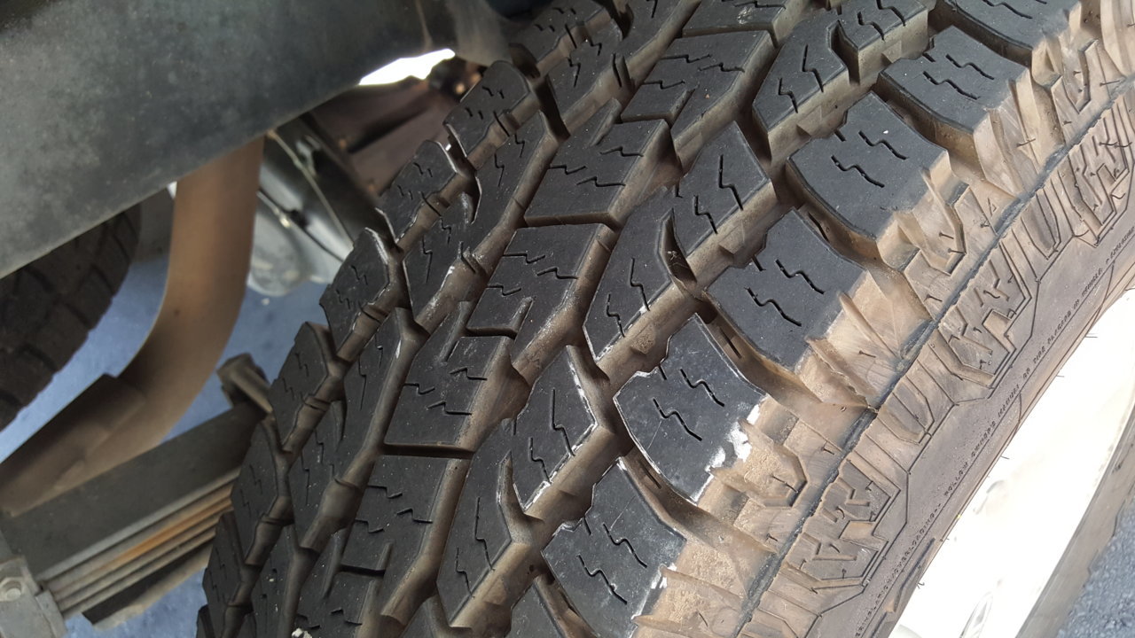

    Toyos seem to pack up with mud pretty easily/ retain it. Caused some ass puckering slippage on a trail today. Turning the steering wheel and getting no response from the front of the truck next to a 20ft dropout on my side was, well, interesting.

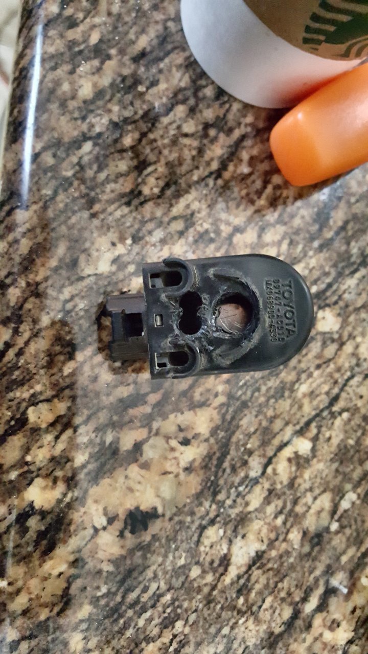

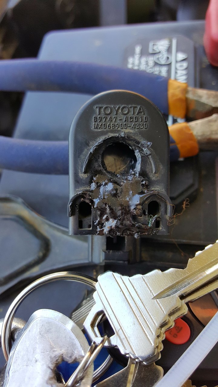

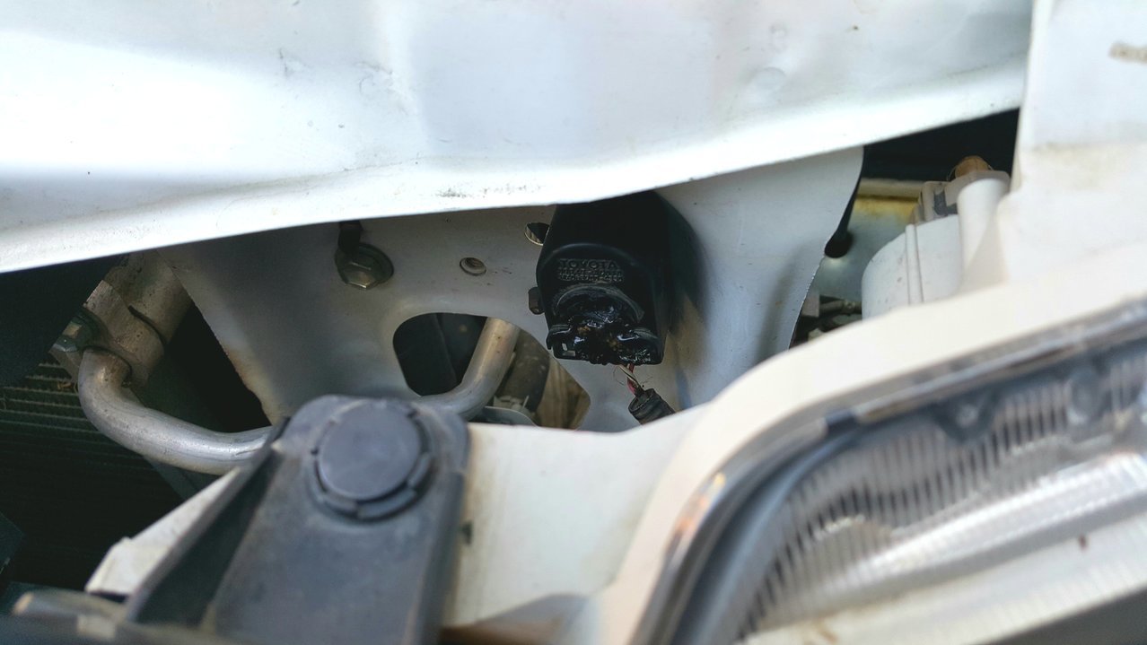

    Moved away from outside a bedroom window and to the city. Time to hear my truck lock and unlock again! Removing the earplug from the door unlock beeper was harder than I thought, ended up having to dig it out. It had hardened up. Hey, while I'm at it let's make it louder! Duh, of course Toyota had engineered this thing to be as loud as possible in stock form to save materials. So, I melted some plastic off an old dog leash i had around to fill the dum-dum holes I drilled, and ended up mounting it outboard instead of pointing towards the battery/engine compartment. See pics of my adventure below. I want my 20 minutes back but have only myself to blame.

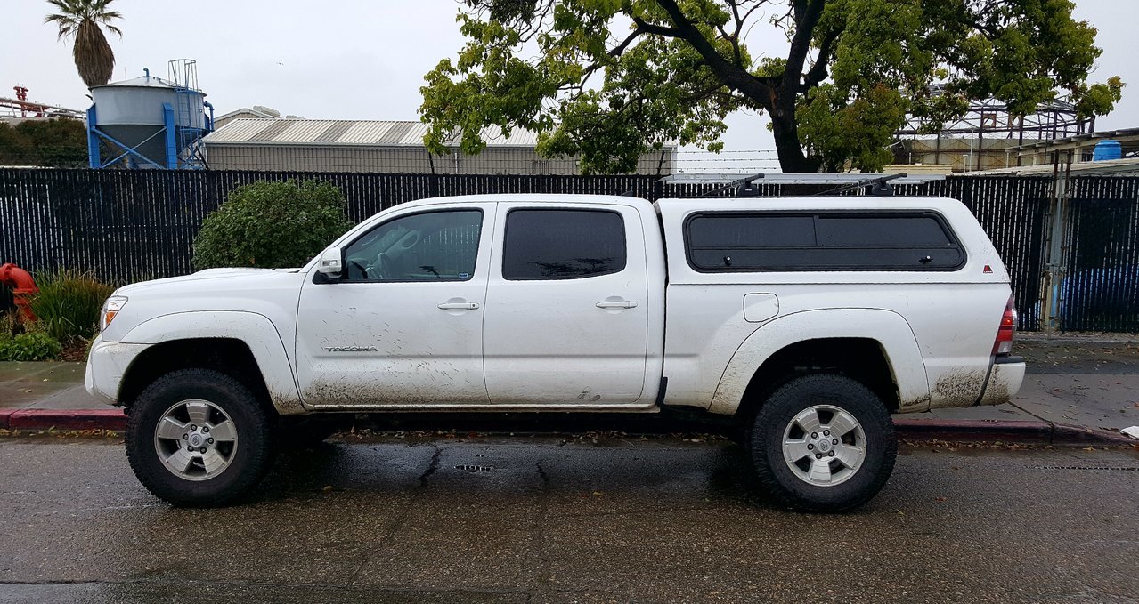

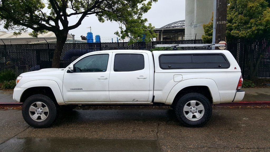

    Purchased some dxl29 extra leaves for my Dakar pack from @SUMOTNK , delivered via TW express by @BudMan . I am fixing up an older property and have been hauling quite a bit of construction junk, and even just my tools and/or camping gear have been pushing my regular Dakar pack to its weight capacity limits. Here's pics with around 800#, and without. Shows the negative rake with a load I commonly haul. Need to get these installed soon.

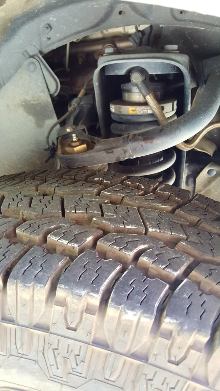

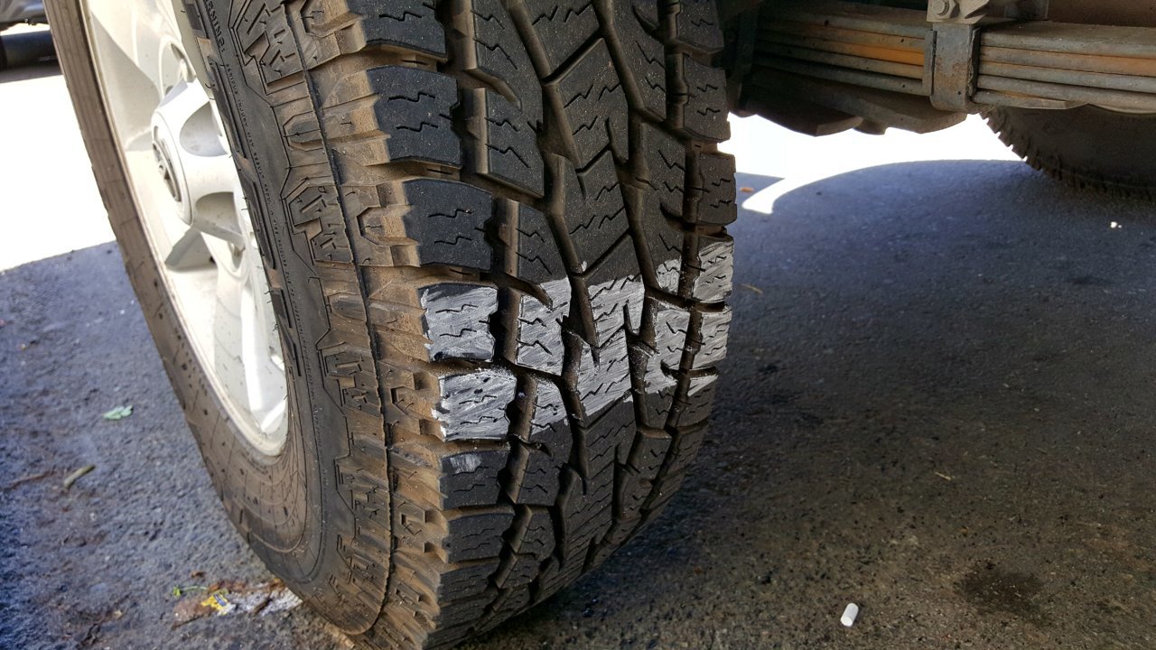

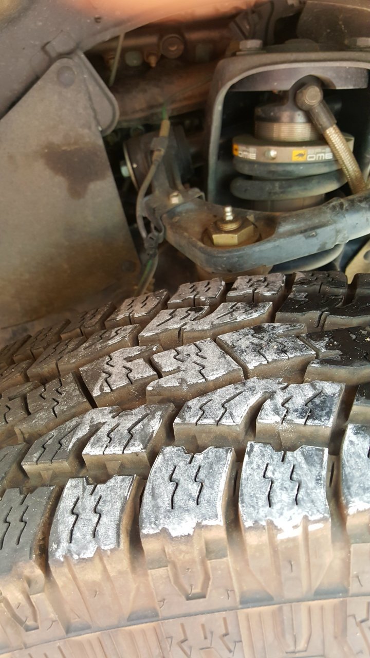

    Chalk test commencing, 30lbs.

    100 yards later kinda inconclusive, going to try again and drive a shorter distance

    Try #2, re-checked I'm at 36lbs hot tires, looks ok. No noticeable gaps in ground contact patch.

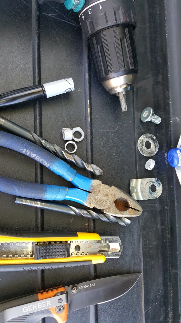

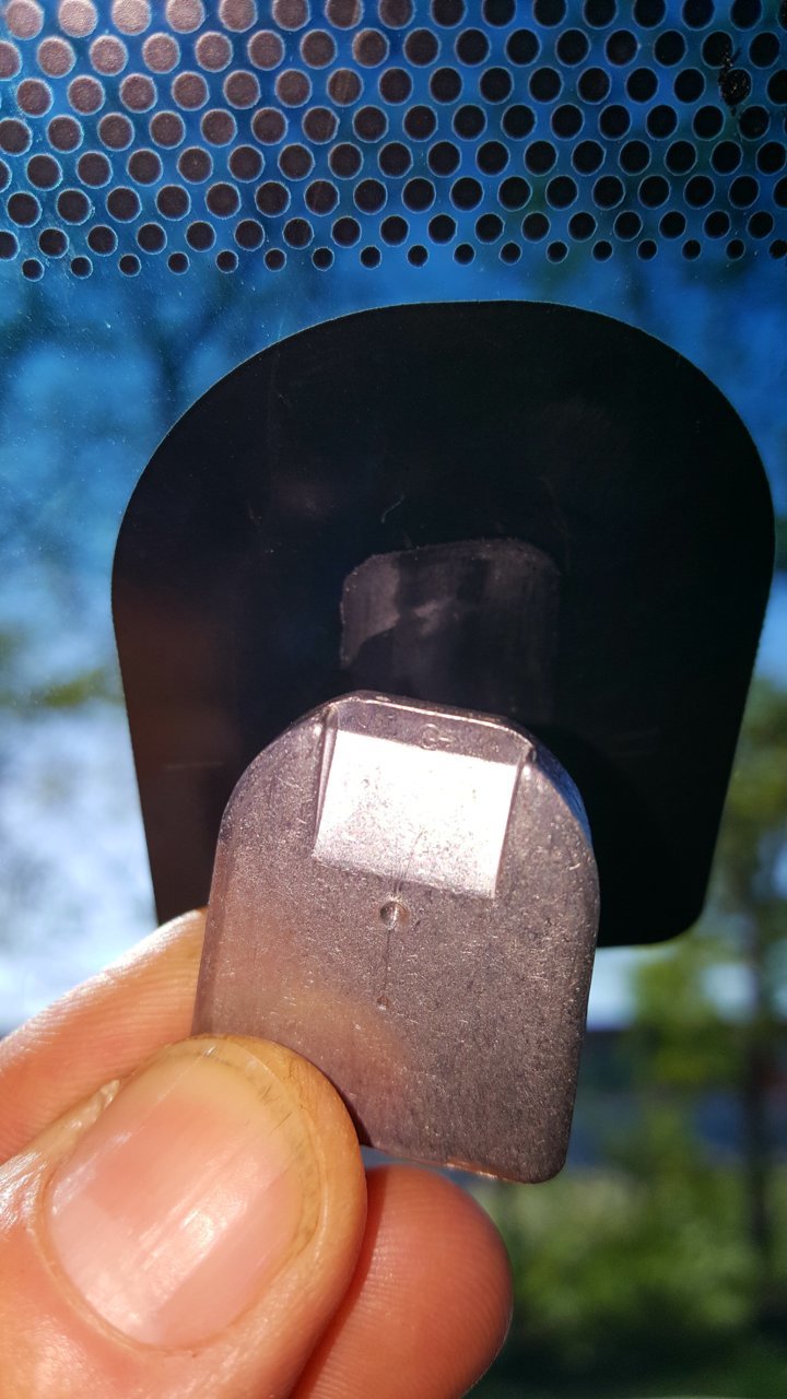

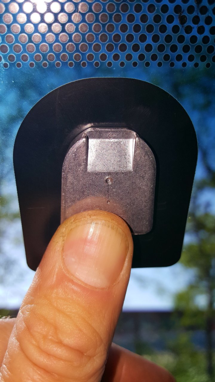

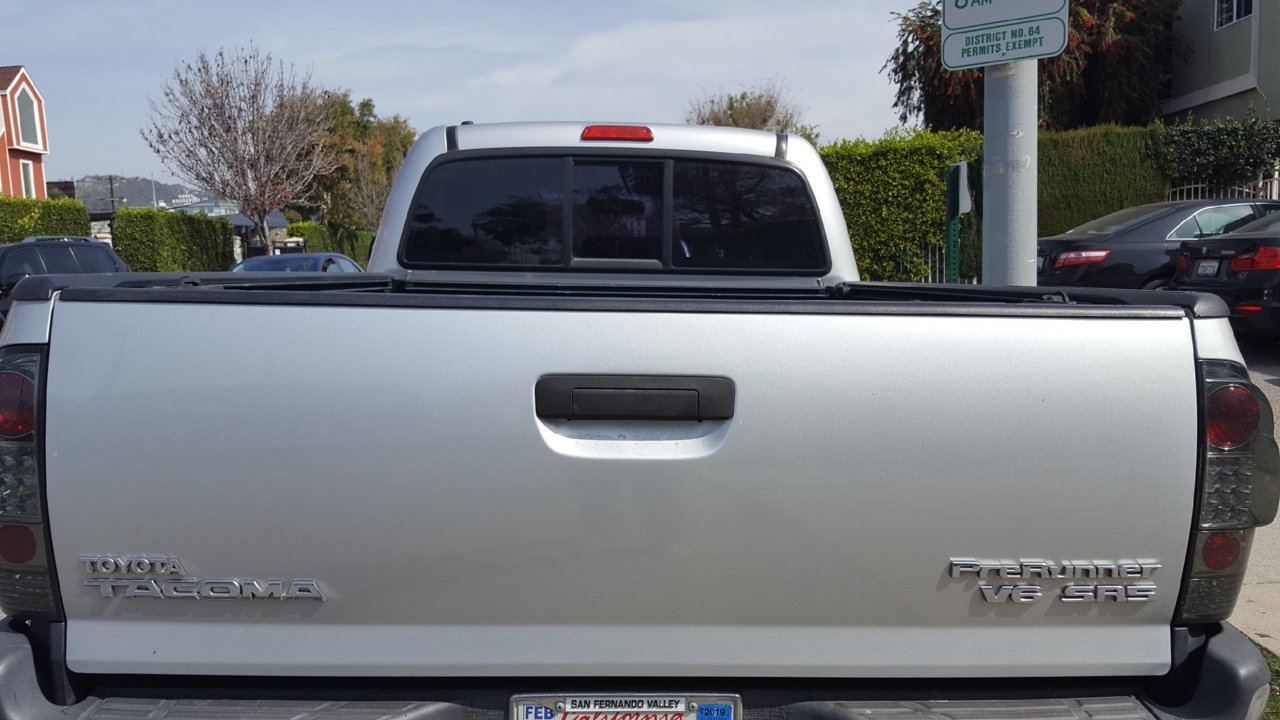

    A friend had his tailgate stolen while he was at a FUNERAL in Sacramento yesterday so I decided to upgrade my weak security (screw clamp faced up) today. Added some thread locker because there was some thread engagement lost with my washer/piece of a sharpie pen spacer. Might fill the torx bolt with epoxy or something at some point.screengrab-1522778452815.jpg 20180403_154953.jpg 20180403_155237.jpg
    EDDO and Drainbung like this.

    My friend in LA, who had his tailgate jacked at a funeral of all places, gained HP with this new v6 tailgate (his is a 4 banger). Sending him a little kit that I made shown above, to secure his tailgate cable.

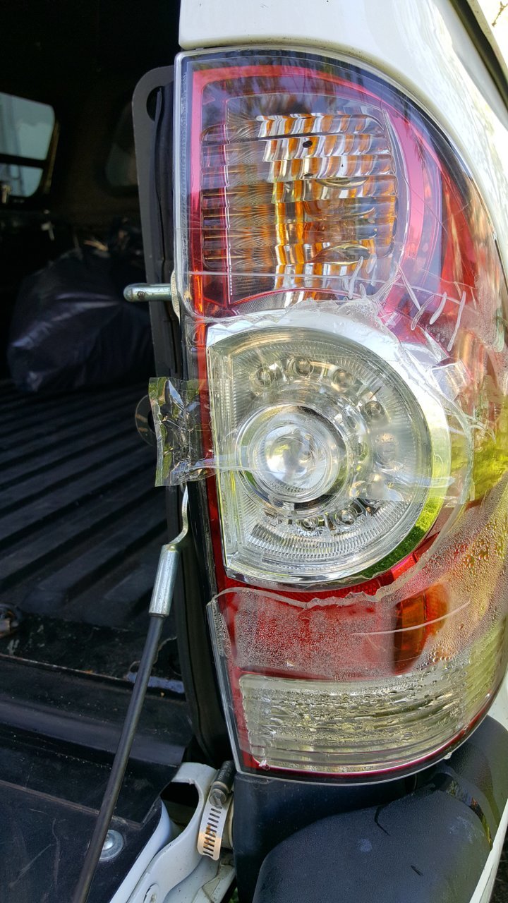

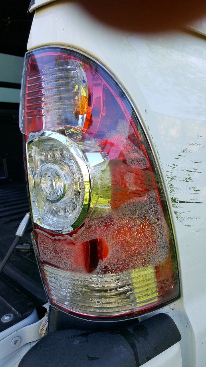

    Some urban carnage this week, looks like I'll be needing a new passenger side taillight. Tried clear packing tape as a bandaid, and it actually looked good, barely noticeable, but the recent storms filled the light with water nonetheless. Drilled a couple of drain holes. My upgrade 12v landscaping GY6.35 reverse bulb hasn't shattered yet despite being submerged completely for the last week or so. Also my new windshield dropped my rearview in my lap, going to have to stop in to have it re-glued.
