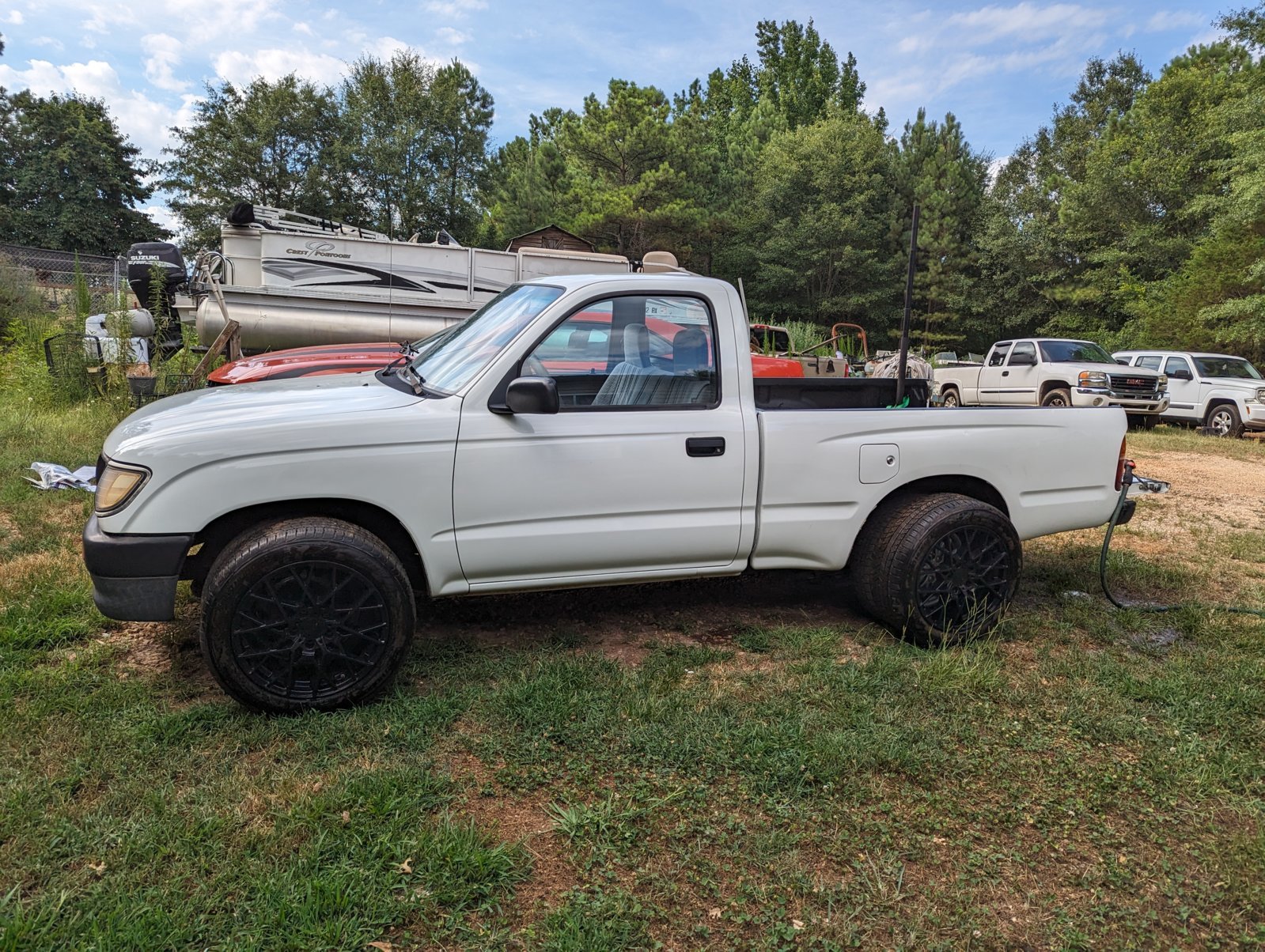

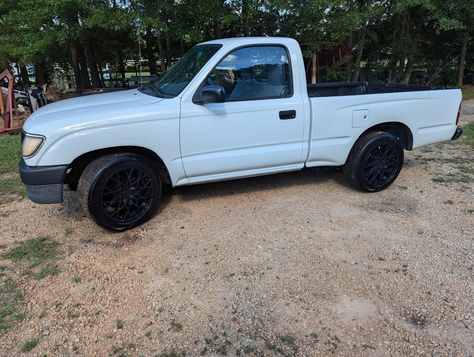

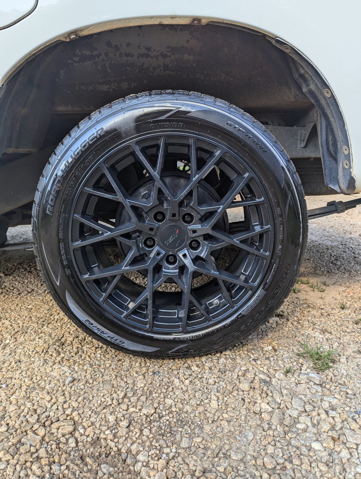

    Had to change all the wheel studs to to longer ones to get these wheels on ...wasn't to hard ...just time consuming PXL_20240709_212830500.MP.jpg PXL_20240709_212842271.MP.jpg

    Sick wheels. Gonna look even better when that fender gap shrinks ;)

    Very cool! Definitely make a build page when you get started. Needs slammed on its nuts and wrapped in a cool color!
