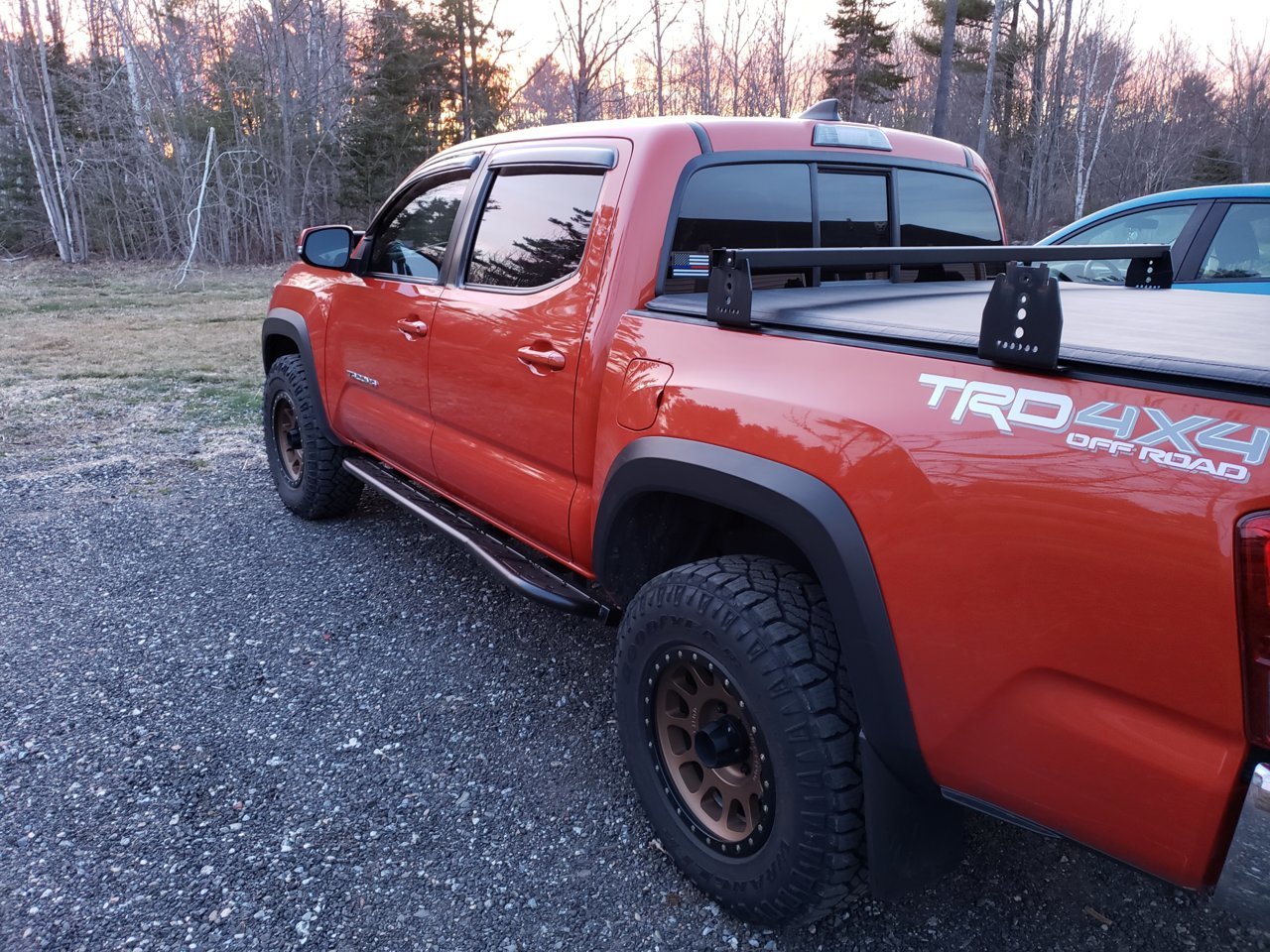

    pic of my rig as it sits currently....
