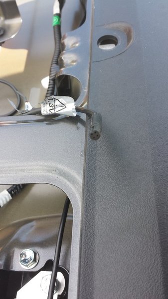

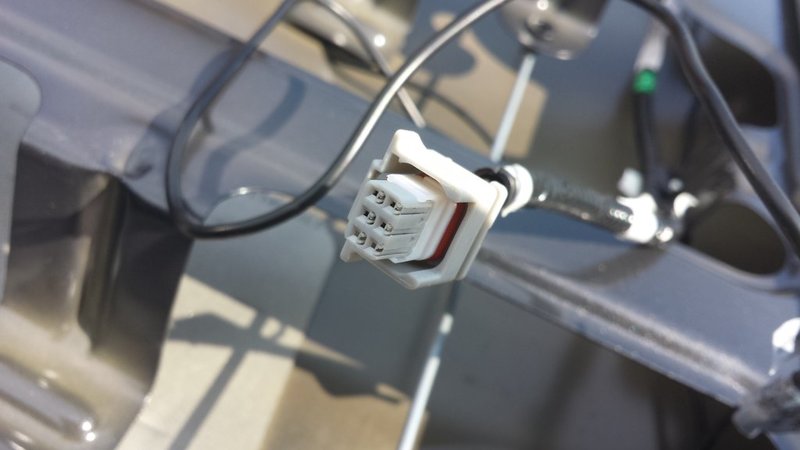

    20150521_172331[1].jpg 20150521_172209[1].jpg I recently purchased a 2015 Pre-Runner Crew Cab 4cyl. It is pre-wired for the camera and I purchased an after market camera that was advertised a to fit 2014/2015 Tacoma's.Only problem is the connectors are different from the factory wiring. Is there an adapter I can get to complete the install?
