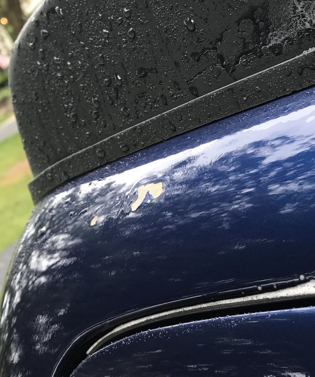

    My 07 indigo ink pearl is pealing. Here’s a picture when it just started and it’s worse now956E8ACE-1347-4CA4-BDA5-6F2ADEFE3AC2.jpg

    Definitely the earlier year 2nd Gens with darker colors, like the red, dark blue, and black had the paint issues. Most of them in my town looked messed up. The hood and roof are full rusted or peeling bad. I have a 14' dark blue (BRM) and so far it's been good. What probably helps me is I ceramic coated my truck when I bought it. The hood and roof are in top shape.
    The ceramic coat also helped our 03' Super White Tacoma. The hood was starting to get chalky. I ceramic coated it and it's like a clear coat went on. No chalky-ness. For those with no paint issues yet, consider it. I wish everyone else the best the getting their paint resolved with or without Toyota's help.

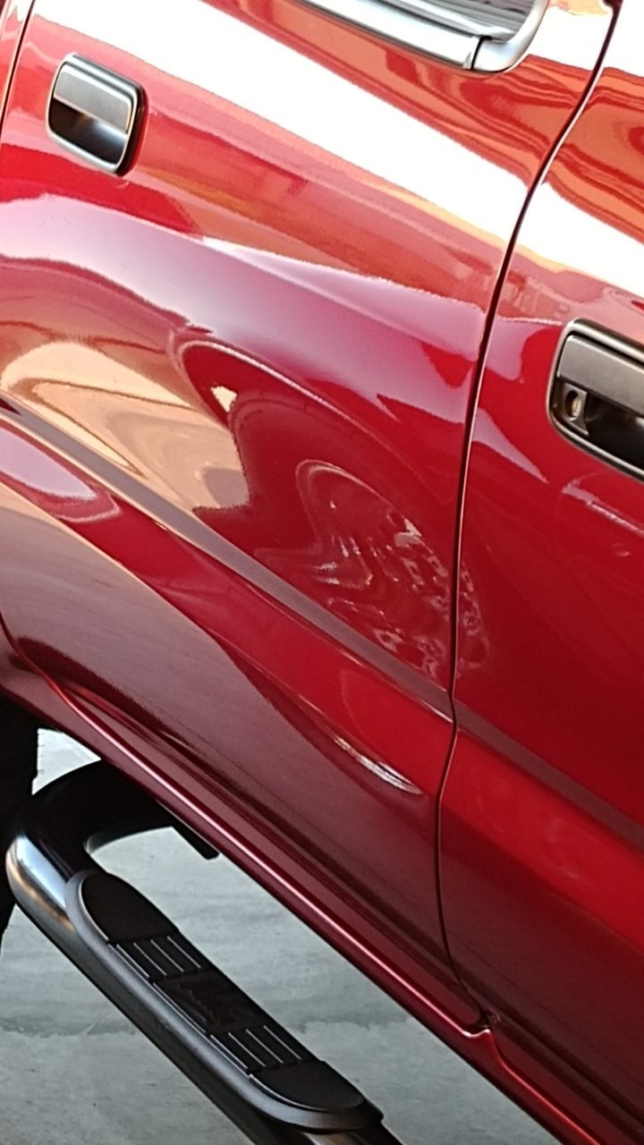

    My 05 still looks fine. hasn't seen wax or a garage its whole life, you guys closer to the sun down there or something?

    No issues on my 02 Pre Runner paint looks awesome for a 73k mile 17 yr old truck

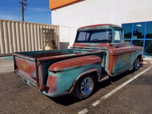

    Conversely, the original patina vehicles are highly sought after.

    beautiful
    late 50’s Chevy paint still looks better than early y2k paints lol
    imagine what our paint will look like in 70 years. Think it'll look that good? I vote no lol
