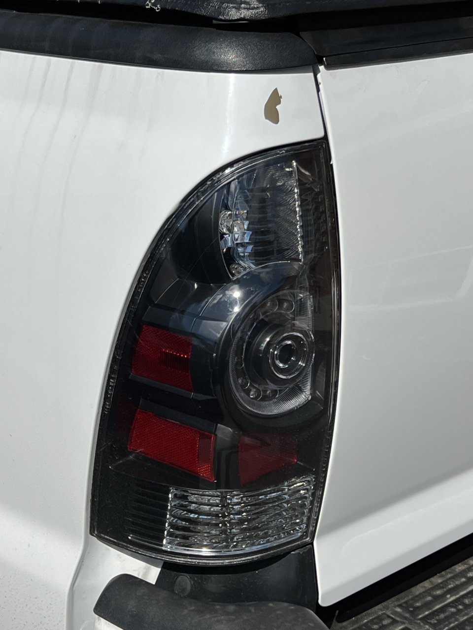

    Most likely. I believe 040 was a color option on every available 2nd gen model year. Other colors were only available select model years. There’s a chart on here somewhere that shows all colors and years available. Can’t remember if other colors were also available for every model year.
    Also probably doesn’t help that white doesn’t have clear so rock chips and paint dings break through the paint easier.
    Both of my problem areas started this year coincidentally where rock chips originally were. The chips were both extremely extremely small and were touched up a couple years ago. Don’t know if the impact breaks the bond between paint and primer or if it’s exposure to environment. Guessing it’s more of the latter. Either way that’s my theory.
    Im lucky both of my spots are on the front doors in the exact same spot. Forward facing b pillar. I intend on wrapping the pillar similar to what the 3rd gens look like in an attempt to contain the issue. No way I’m spending the amount of money it cost to repaint the truck. I fully intend on upgrading to either a less problematic colored 2nd gen or 3rd or 4th gen in the next couple years. If the hood, front fenders and roof goes before then I’m SOL I guess.

    I don't buy the "paint chip" theory as the factor that starts this failure. I have a 2014 that has the usual nicks on the surfaces facing the front (leading section of the hood, windshield pillars and leading area of the roof. There is no indication of any peeling issues. The pics posted here are (IMO) showing problems in completely random areas, including some in places where rock chips aren't a big problem: like the sides of doors, under-hood fender edges and door pillars and near the rear tail lamps. And don't forget: Toyota is shelling out for for a repaint on their other (every?) models that are having this problem. AND: it's happening on other colors too!
    My theory is surface contamination, faulty surface preparation and/or primer application. The paint holds on for a while and then after normal aging just starts to let go. I don't have any hint of paint failure on my [040]: YET. And I shouldn't have to worry about the truck having this issue either, until it is at least 15 years old. My son's 2005/247k has some clear-coat failure going on with the roof (that only started about two years ago), but the original black metallic paint is still holding on tight to the sheet metal underneath. YMMV

    The paint guy I saw said what you are seeing is the environmental coat (tan color). The E-coat didn't bond with the primer coat. If you look at the back of a paint chip you will see the primer and not white paint.

    No offense, but I believe your paint guy was blowing smoke up your skirt. In all my years in the metal finishing business, I've never heard of an "environmental coat." The "E-coat" you are referring to is electrodeposition primer. This is the process where the body goes through a "river of paint" if I gloriously oversimplify it. (There are numerous preparation steps prior to the actual primer application.) Most modern vehicles get three coats of "paint." The first is an E-coat primer followed by a sprayed-on color coat followed by a clear topcoat. Toyota Super White however is a single stage white and has no clearcoat.
    Is there a bonding issue between paint layers? It sure looks like it. It is between the environmental coat and the primer? Nope.
