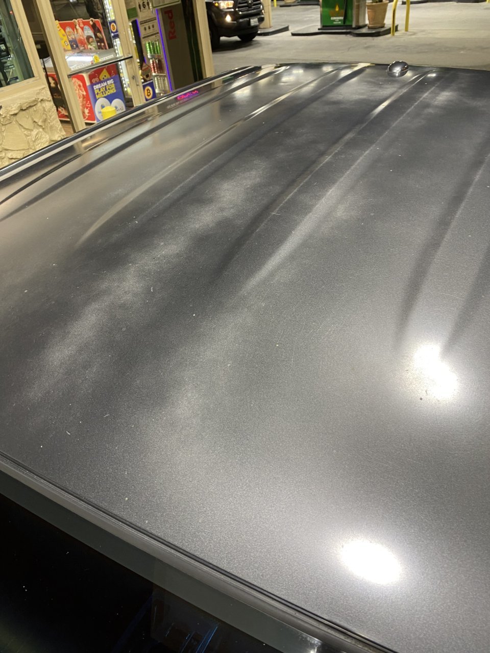

    MGM here, I just repainted roof, Hood and top of fenders.. Now the sides of the roof and A pilars are cracking already ...

    Is this after repaint because that looks like the clear coat is already failing.

    That was before

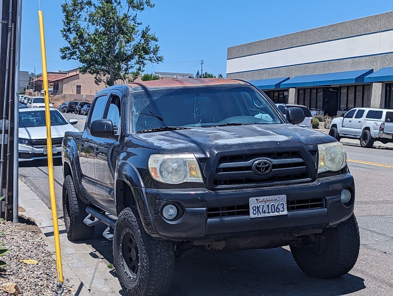

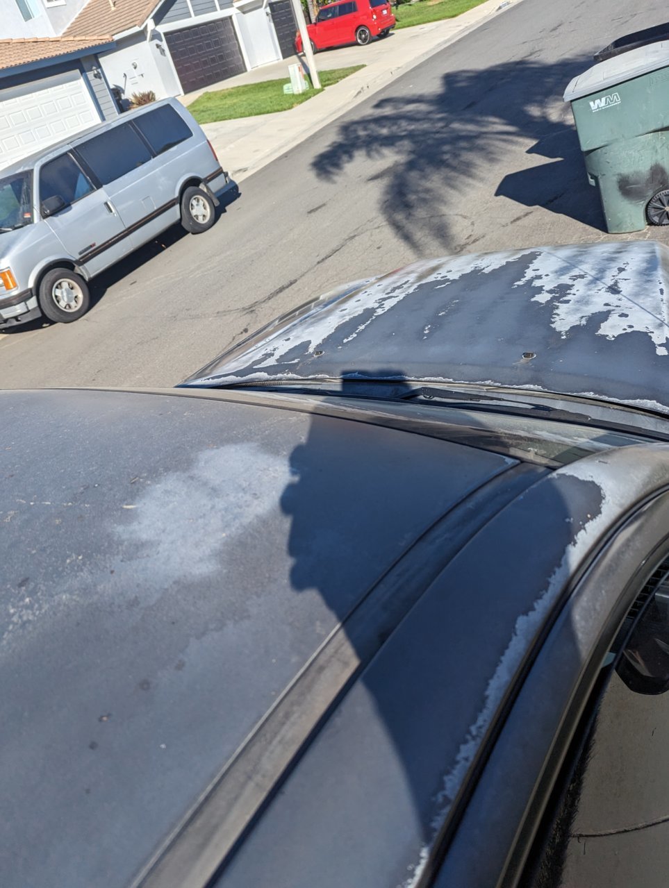

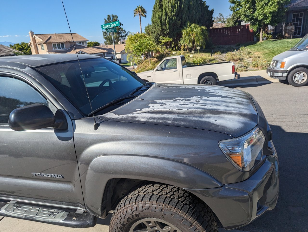

    2015 MGM checking in. I'm the 2nd owner and bought it at 30K in 2019. Faded within a year of me owning it. Obviously past the warranty period.
    July 2023 update: Stage 5 paint cancer progression:
    • Hood (CC failing on entire hood)
    • Roof (CC mostly gone with color layer exposed)
    • Sills CC failing and mostly gone
    • Doors (CC failing, can't tell from the picture, but there's progression right above and below the windows.
    And just to show that I actually do take care of my truck and still wash and wax regularly ("That's just neglect, bro"). She still cleans up nice, but my wife doesn't want to take my truck anywhere "nice", so it's been demoted to "beater" status because of the paint.
    Estimate to re-paint is $4.5K for just the hood and Cab (bed seems OK) or $6.5K for the whole truck. Or $7.5K if I want to change to Cement. Then I was told by the shop I went to that "If you do nothing at all, just make sure to paint at least the roof. He then walked me over to show me my future, which was the below truck in his shop. Told me my girl had the risk of getting as bad as this black truck in about a year or two, even in California.
    I'd like to also add that my wife's 2012 Touareg diesel has pristine paint after sitting outside in a stadium parking lot in Phoenix for 2.5 years waiting for the diesel fix and has been sitting in the same parking spot as my Tacoma for 3 years. That said, it's out of warranty now and I am scared.

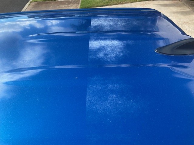

    I have a 2018 TRD Sport, with about 38k that is having issues with clear coat loss and paint fade on the cab. The blue is turning white, but it's not just weather, but definitely a factor defect of some sort, due to the exact square pattern of paint loss.
    Took it into Servco Waipahu, and all they could due was give me the number for the local Toyota quality complaint line, due to being out of warranty. The service rep, did tell me that they've been seeing this issue come up lately, especially in a lot of the grey colors.
    It'll be a shame if Toyota won't do a recall of some type on these trucks, since its obviously a defect.
    I'm curious if anyone else has seen this issue in their 2018's, and if so, hopefully you file a complaint.IMG_4994.jpg

    Somebody - somewhere along the line - repainted a section of that roof. And if you (the OP) have owned the truck since new and never had any paint work done, don't rule out a dealer or factory repair job before you bought it. They happen more often than you might think.

    I purchased the truck brand new in Nov 2018, so must have been done at factory. The service rep, told me that he's seen several others that looked the same way. Yet, since out of warranty there's nothing they will do about it, unless it becomes a recall issue.

    Looks to me like that occurred while the shipping protection was on it. That's too square to be any paint repair, they wouldn't do tape lines in the middle of a panel.

    Hmmm, interesting observation! I've removed that protective film from more new Toyotas than I can count. The only problem I ever saw with it was on current generation Highlanders where a styling depression in the center of the hoods allowed the film to "flutter" during shipment causing marring in the paint. Of course, this looks like the film actually prevented UV damage to the roof quite some time down the road. Very odd since that's not what the film is designed to do.
