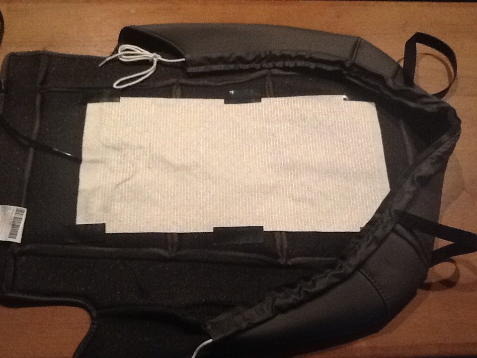

    The factory heated seat warmers are held on with little plastic ties like you see holding tags on clothing...on a retrofit you just use spray glue to hold the warmers to the foam if your gonna take the seat upholstery off probably should do leather while you’re at it but yeah it’s a lot of work and sore finger tips.

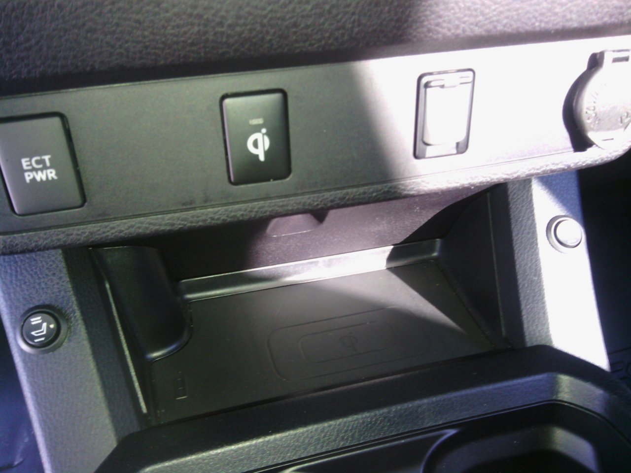

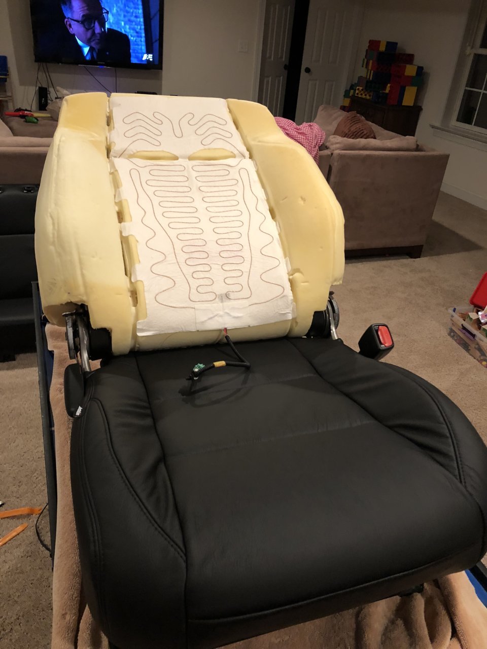

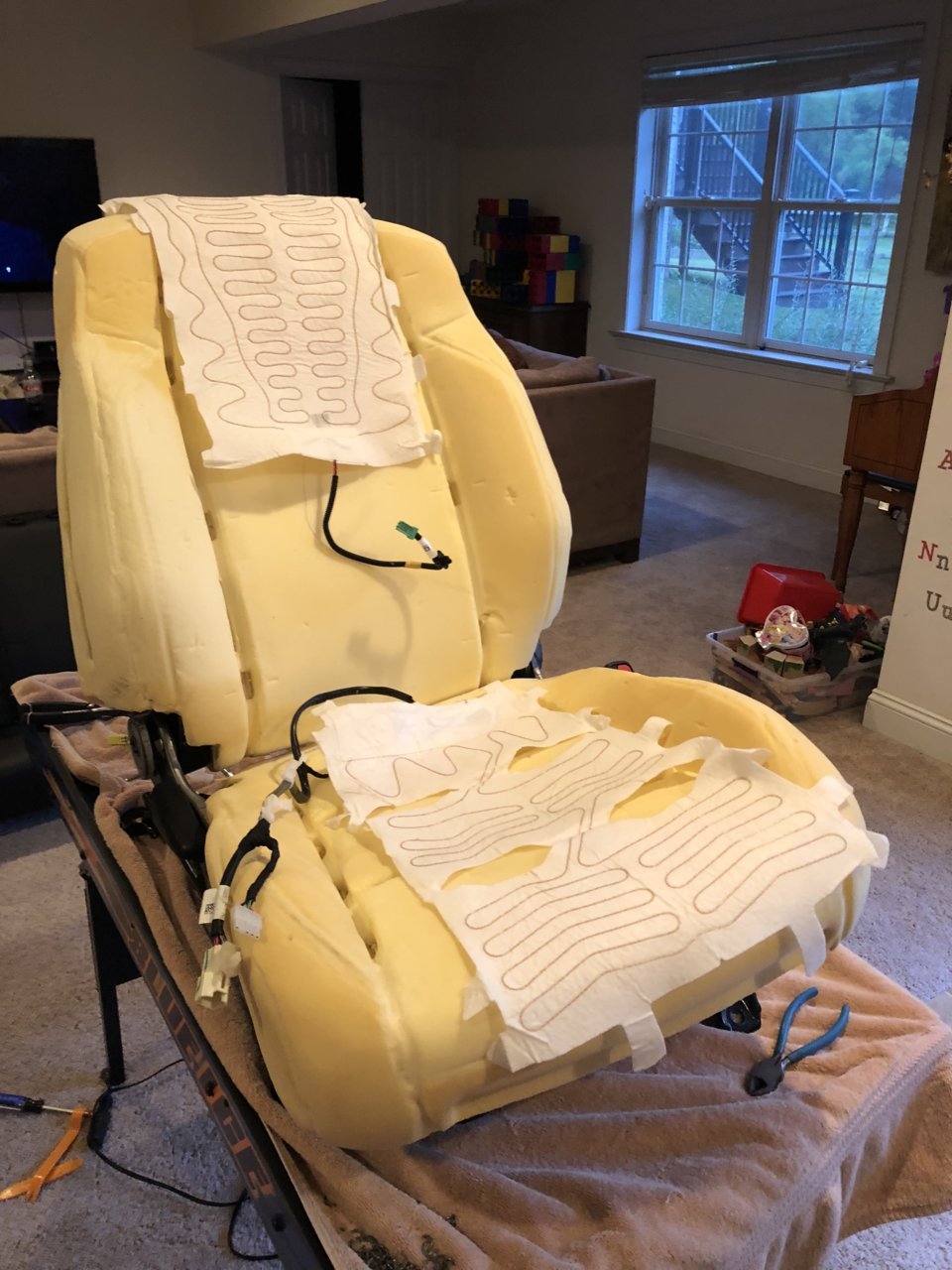

    I didn't think it was too bad. Just get you some hog nose ring pliers and a good aftermarket set and go to work. I had the most trouble unplugging the air bag connector. It is a goofy connector and took me a bit to figure out the trick to it.
    Putting the aftermarket heaters under seat covers is an even easier way of doing it.
    https://www.amazon.com/Besond-heate...TK3QFNYEAFY&psc=1&refRID=BF8JJRPR1TK3QFNYEAFY
    https://www.amazon.com/Pliers-Galva...keywords=hog+nose+rings&qid=1576680192&sr=8-4
    I did replace the 3 switch blank in my truck with an OEM 5 panel blank for the factory looking switches, and that added like $140 to cost, but I wanted a factory look. The switches on my kit are exactly the same as in my wifes Rav4.
    It is 100% worth it.

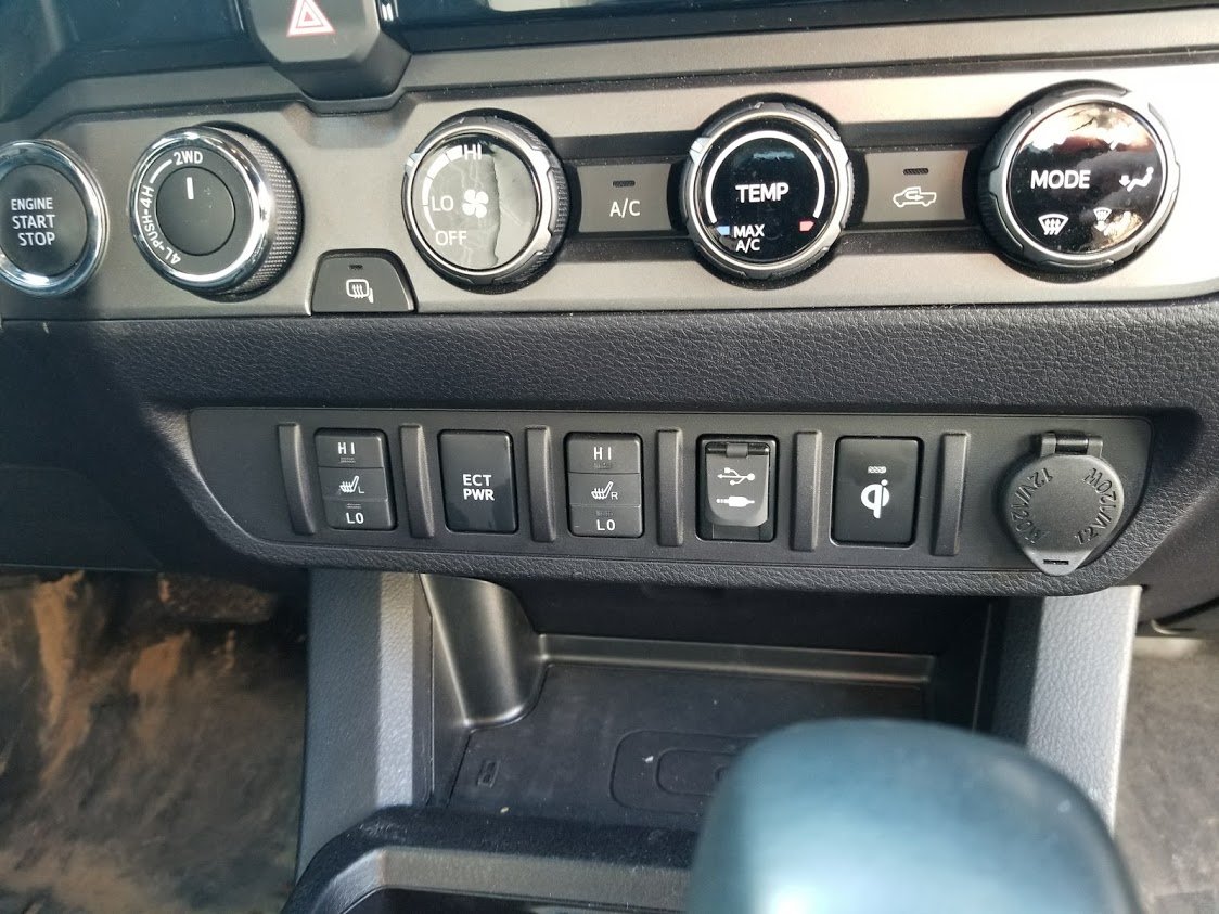

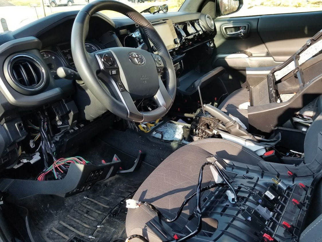

    I did the heaters under the clazzio seat covers. Easy to wire this way,didn’t have to take dash apart.87E2AE24-0621-48C1-846C-A6CDE9AED902.jpg9CC17D40-D667-47C4-B39F-CBBAD9F3EDBC.jpg
