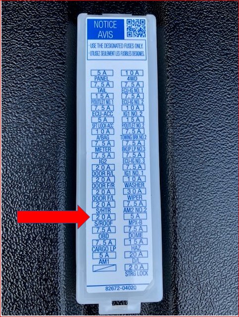

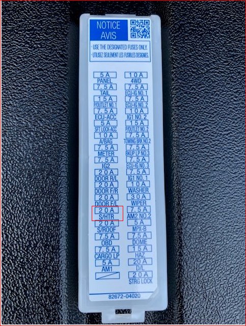

    Short answer to the OP: Yes. Especially if you're installing them on the cloth seats. But if you're installing seat covers, they're way easier.
    As far as running power... your TACO does have a fuse for heated seats. Of course not all TACOs come with heated seats, but the fuse is still there. I used an add-a-fuse right to that same fuse. You'll also need an ACC line (has 12V when truck is on)... and I just tapped into the socket in the middle console.

    Thanks for the info, Going to be doing trying this again sometime next week. So the power for the seat goes to that slot on the fuse panel, and the switch is to the ACC line?

    Depends on which seat heaters you go with. I went with the Besond car seat heaters (link in the "Product Discuss in" below).
    RED wire (+12V 20A circuit) I hooked up to the S/HTR [add-a-] fuse.
    RED/YELLOW Stripe (+12V 5A circuit) wire I tapped into the 12V socket in the middle console.
    YELLOW (+12V 5A circuit) wire I hooked up to the TAIL [add-a-] fuse (2nd one from the top, left column). So when you turn your lights on, the switch lights up with the rest of the dash.
    BLACK (GND) wire I hooked up to a ground screw under the middle console.
    Besond will email you their instructions, but you have to request it.
    Good luck with the install... pretty straight forward. Post on here if you have any questions.
