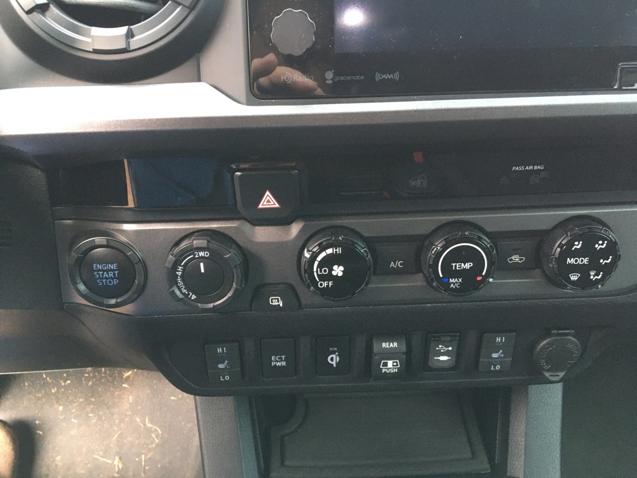

    I spent a lot of time looking for a switch I liked that should work. I’ll have it in hand by the end of the week. Hoping it’ll blend in. I wanted 2 separate dial switches but could not find some reasonably priced. The size is supposed to be the same as the planned location.

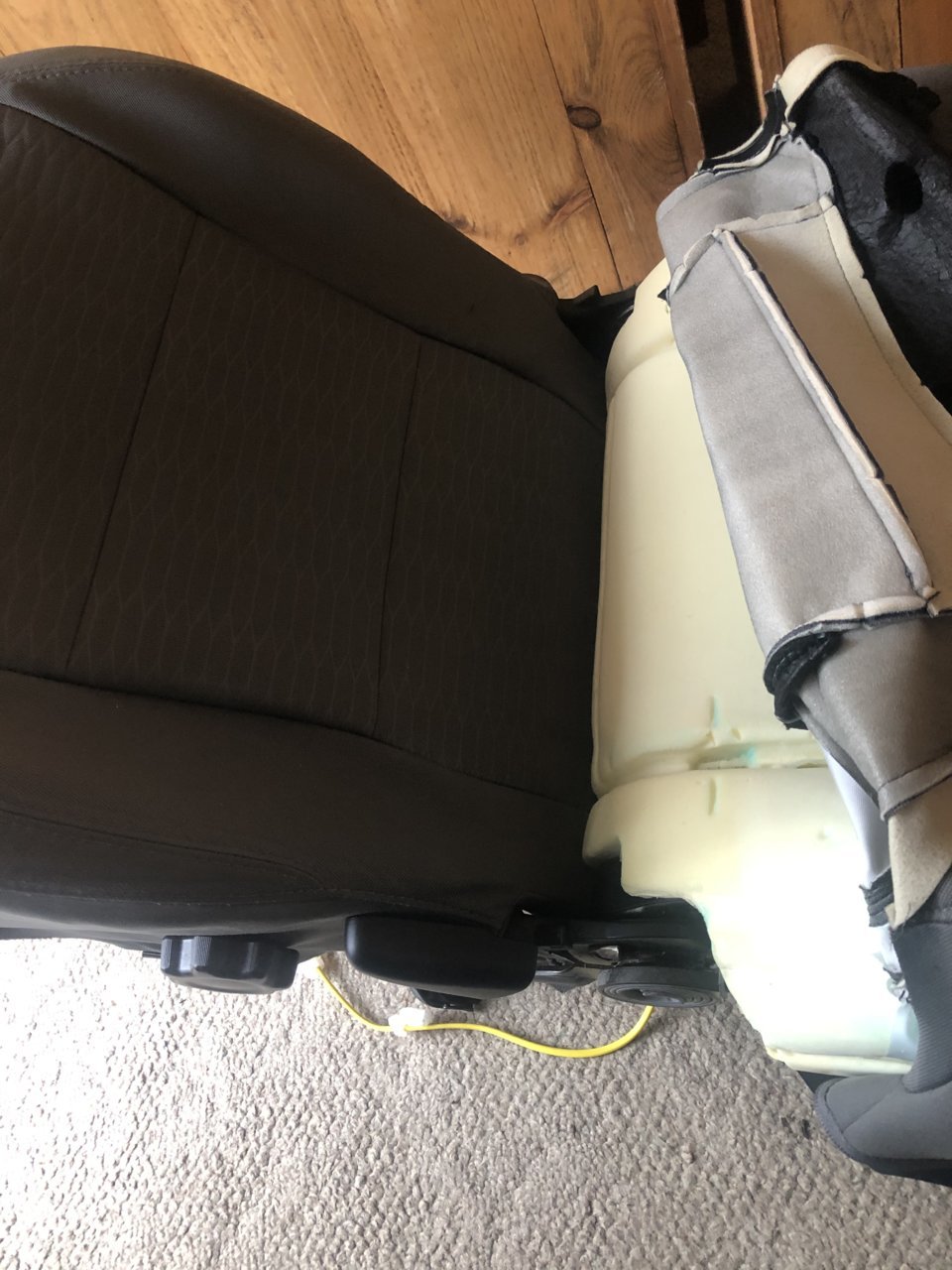

    The trucks in like 10 pieces. Have it all taken apart it started to pour. I have the wires for the drivers side ran. The drivers seat done. Was about to run the passengers side wires but going to put it on hold until the rain stops. Gotta take out the passengers seat too. It's not hard so far just a pain in the butt. Running the wires is pretty tight.

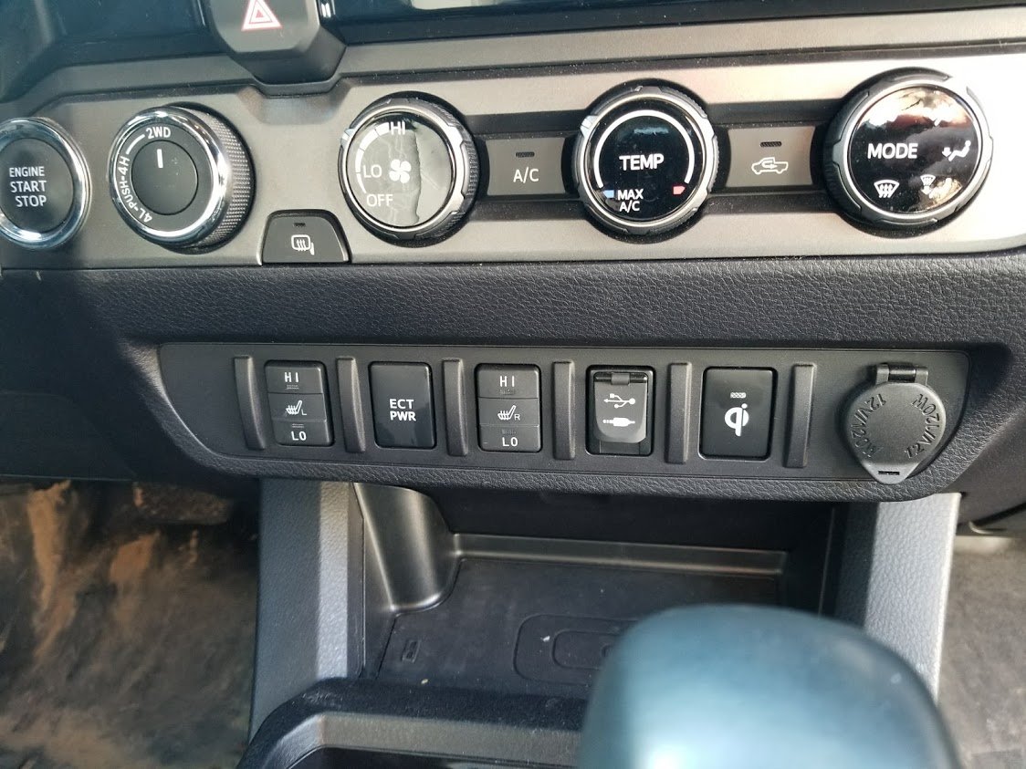

    Oh I agree 100%. That's why I did this,
    As factory looking as you can realistically get with a truck that didn't come with them due to the dual climate setup. They are the exact same switches that my wife's Rav of the same year has. Others moved the passenger switch to the outboard location, but I just put the switches where they fit. If I ever have the inclanation I will move it.
    The wiring I just tucked into preexisting looms.

    Thanks. I bounced between the dial switch you have and these. Either option is good, I just went with what I knew.
