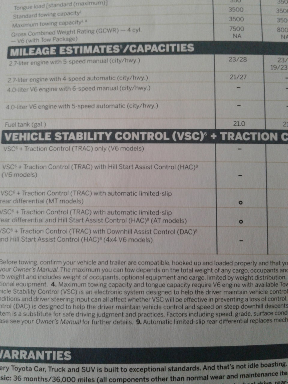

    I had an 08 and it did not have A-TRAC. But VSC + TRAC was available, this is from the 2008 brochure
    henryp likes this.

    Ok, I won't go looking at every car to see if it's got some type of TRAC, but regardless, ATRAC/TRAC is not part of the requirement mandated by the DOT, which is what you were insinuating in your first post. VSC is required. TRAC/ATRAC is NOT. If VSC is a by product of TRAC, ok, that's fine. But the TRAC itself is not a requirement. That is all.
