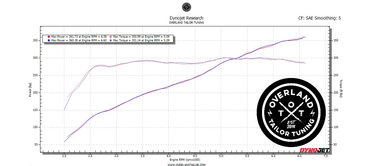

    At 360+ wheel HP on our shop 3G S/C Tacoma, there ZERO gain to be had by intake/filter 'upgrades' over the stock airbox/filter. We've actually tested this on the dyno.
    The below dyno graph is of our Shop 3G S/C Tacoma w/ fully stock intake (filter included) and with the air filter removed, running an open intake straight to the atmosphere.
    Red is w/ the stock airbox and filter
    Blue is with the open intake

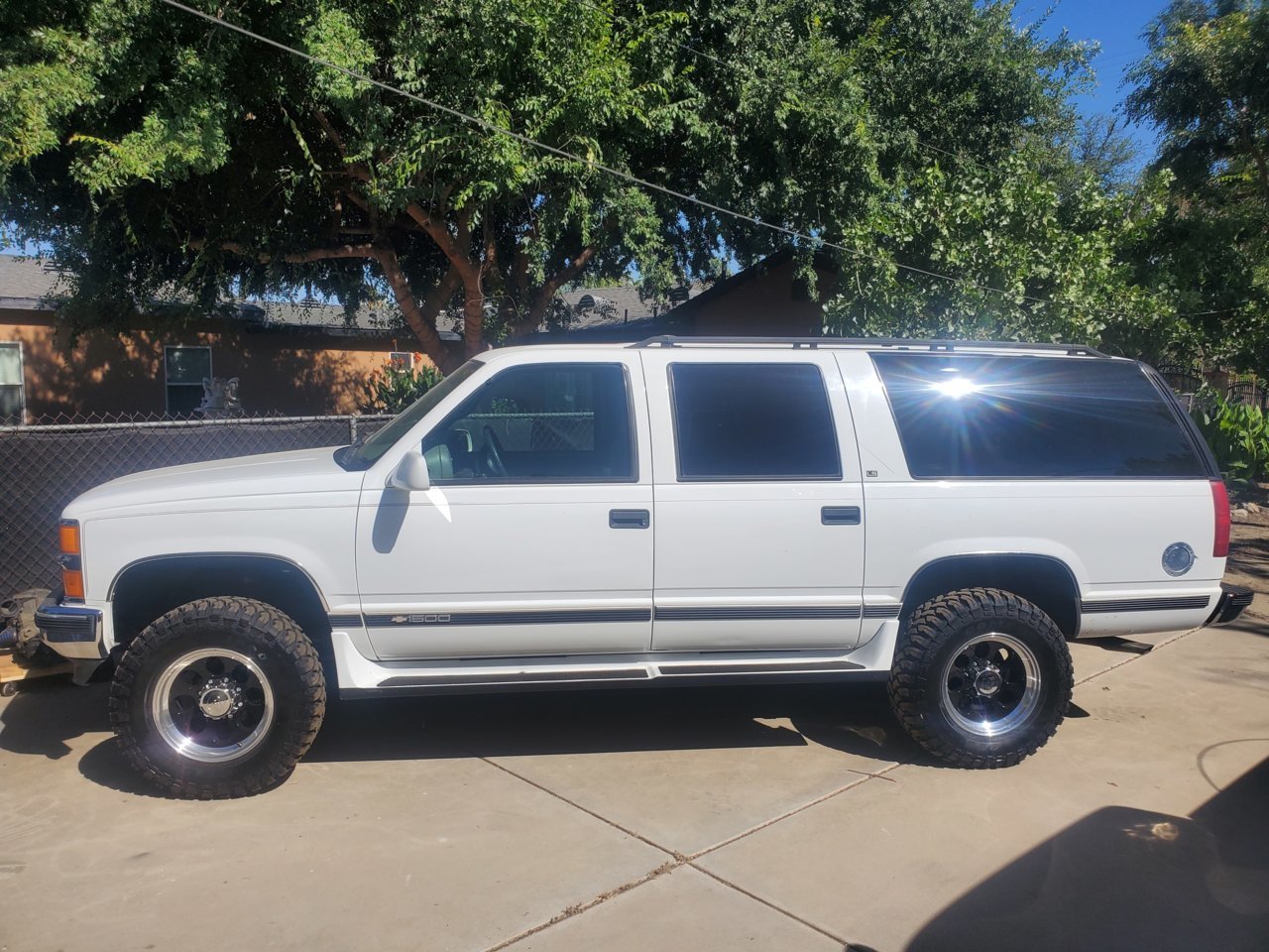

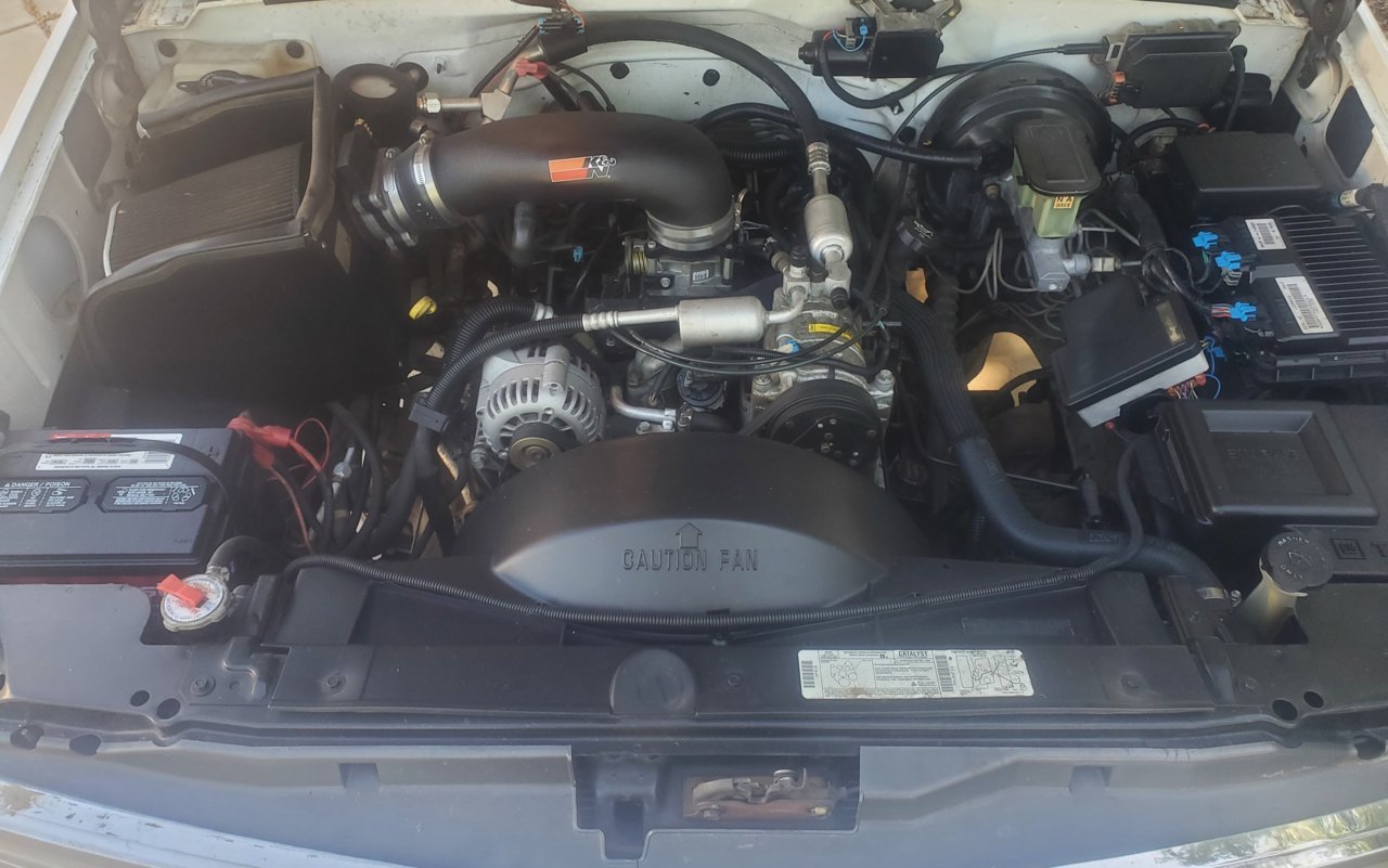

    I ran a K&N filter on a SB Vortex Chevy in the Suburban from the day I brought it home. 52K miles later it developed a rod knock. $7K dollars later and a new motor, lift, 1 ton axles, and new wheels, Burb lives again. Look closely. Lol.
    I would never install a K&N on my Tacoma, it will destroy your motor.
    hiPSI likes this.

    Agreed, and I did install the intake right back onto the new motor, crate engine, all new GM parts, hoses, 100amp alt, new radiator and more. If it blows up again, so be it, maybe it won't. I personally like the way it sounds and looks. The pic is the new motor installed.

    If you're not well above 360+ wheel hp, there will be no actual gain by modifying the intake or filter.

    I can't speak for them, but our testing surprised even me a little. I figured there had be something to gain from removing the filter at our power level, but alas.. None to be had.
    The exhaust on the other hand does show some improvement. More on that to come (we've got some things in the works).
