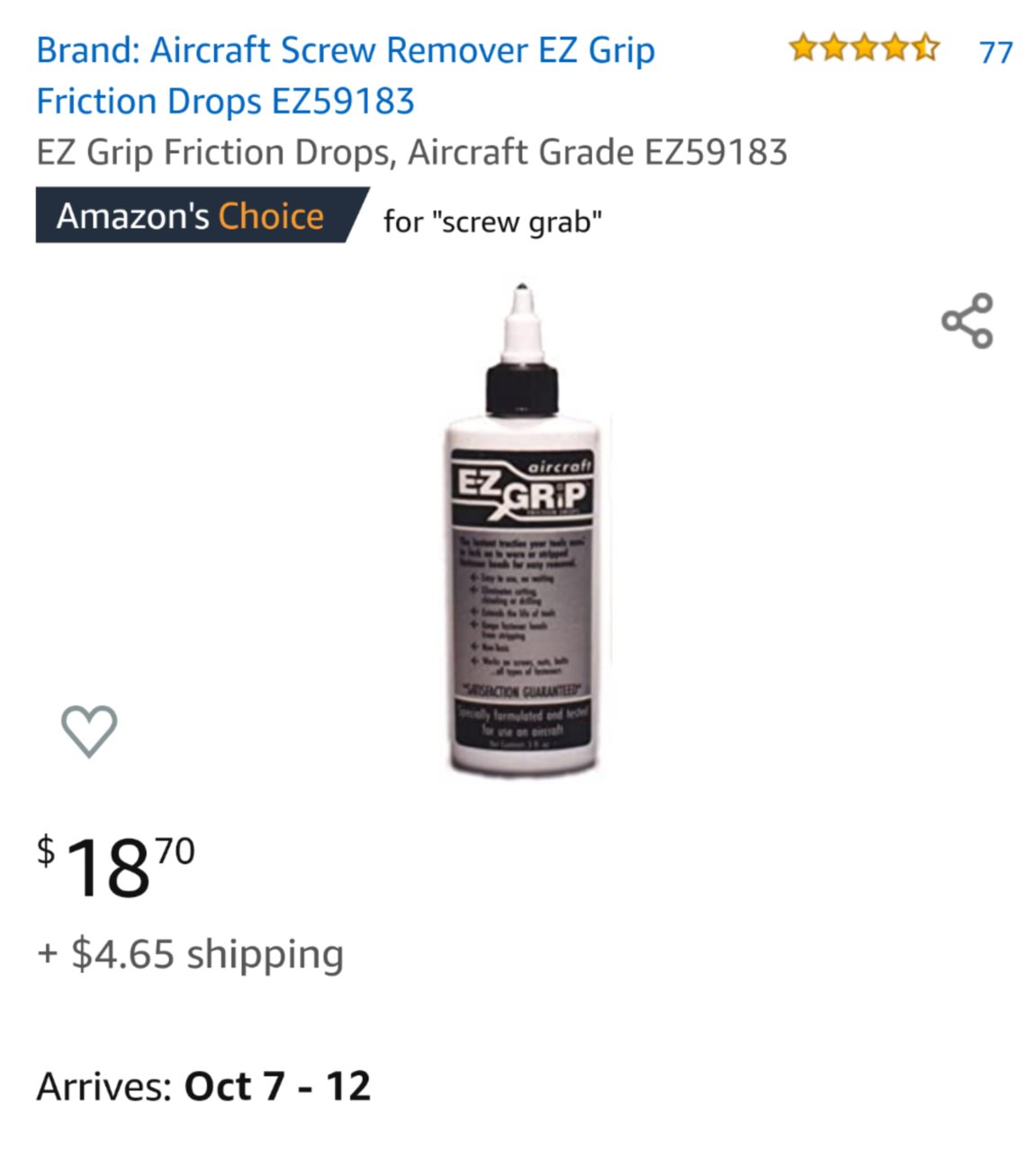

    I've had good luck with EZ Grip on rounded allen head screws..
