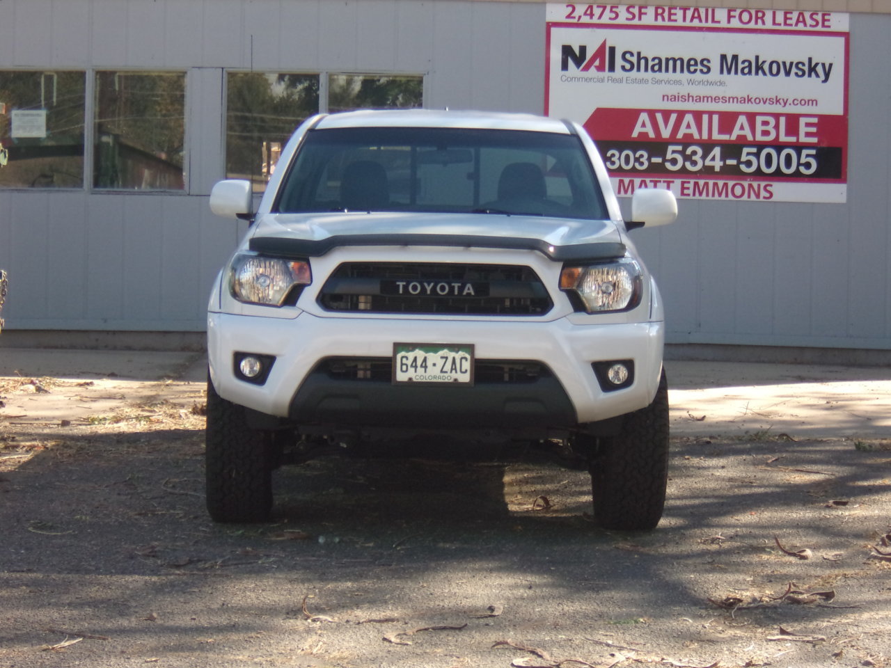

  15. Nov 13, 2019 at 6:26 PM
    #35
    CHMM
    CHMM GTO
    Feb 23, 2015
    #149418
    896
    Gabe
    Castle Rock, Colorado
    2001 TRD Xtra Cab 4x4 Supercharged
    5100s SPC UCAs Energy bushings #70 spring clutch mod Supercharged
    I had the TRD pro suspension on my 2015 with everything else stick except the BFG KO that came with the fake bead lock wheels. It was soft like driving a boat. Just my experience. But those were D not E. Here it is
    mikalcarbine[QUOTED] likes this.
