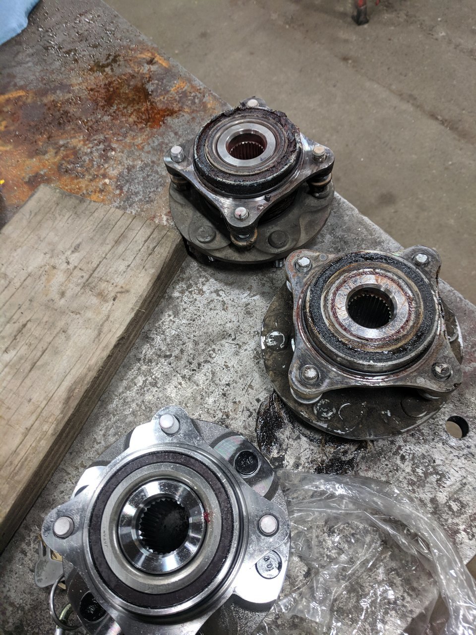

    Just figured this out as I took one side apart thinking it was the bad one, and come to find out it's fine. The other side was the source of my grinding noise. The side I thought was bad was just replaced 25k ago with a bama assembly, but wasn't sure if I torqued it right. Go figure it's the side that I haven't replaced yet and it appears to be OEM. It's the top assembly in the picture that's dry. 176k on the truck.
    :annoyed: :bowdown:. Thanks again @BamaToy1997
