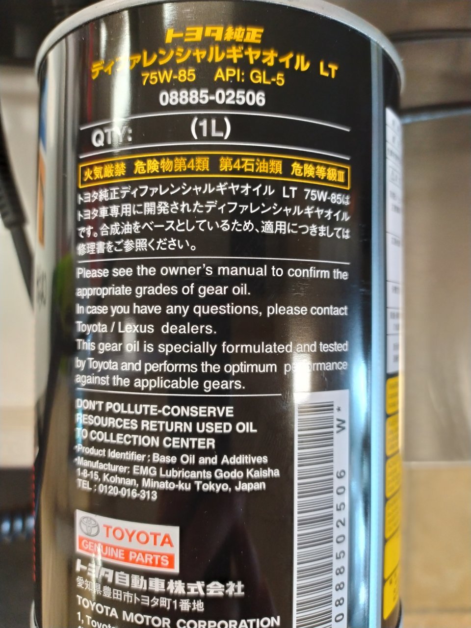

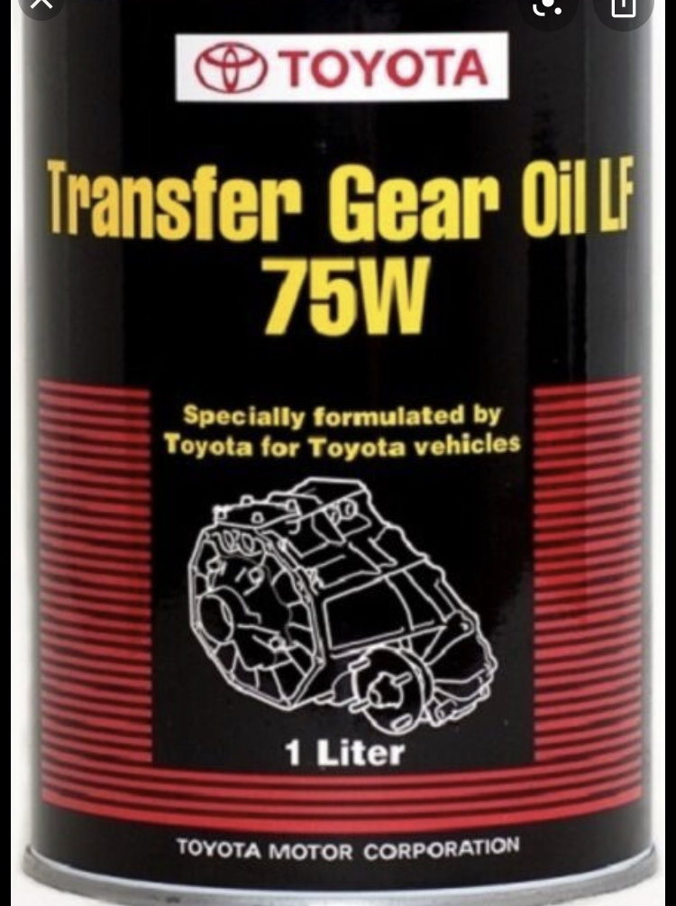

    Was at the dealer today to pick up some LF and they said there was no listing and tried subbing this. I'm holding off for now untill I can get some official answer .

    Yeah. GL5 is supposedly NG.
    If there is a substitution, there would at least be a manufacturer communication on the nhtsa.gov site. It does take a while for them to get posted. I would expect the dealer to have the info on hand.

    They are not the same. Toyota defines what they should be used for right on the can.

    Where are the Canadians buying this stuff? Have called 6 dealerships now and they either say just use regular gear oil or that they can only order in bulk for the shop.

    At my dealer they had to grab it “off the Lexus shelf”.

    The important thing to note about this LF fluid, is Toyota is importing this fluid from Japan to put in an American made Borg Warner transfer case. If they felt good ol’ Lucas or Redline or Yadda yadda was appropriate, they would just use that at the factory.
    The can of oil literally says “made in Japan” on it, and carries no GL rating.
    As mentioned, I was surprised at the problems I caused myself on cold mornings by using the generic synthetic 75/90 that my dealer said was “what we use in the shop”. Within a few months they started stocking the LF fluid, so I assume I’m not the only one who had problems.
    No issues at all since going back to LF fluid.
