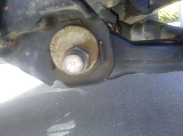

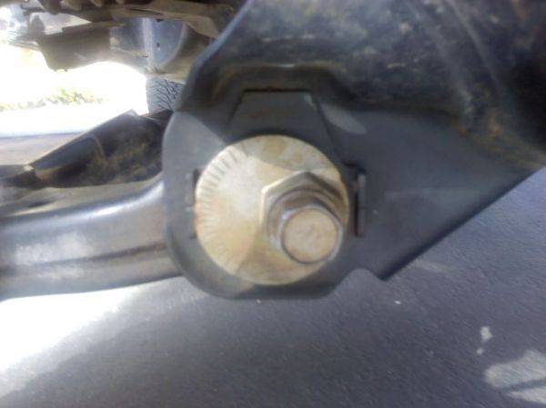

    are these maxed out? this makes no sense, i had a perfect alignment before gorman

    Top one is maxed out. All the way positive.
    Bottom is not. It can go a lot more positive. (talking camber)

    so its impossible for me to get positive camber on the top one?? i have posotive camber on both berfore the last offroading trip

    i think hes say you could get more positive camber out of the one on the bottom

    yeah but that would be way stupid to have one wheel have + camber and one have - camber

    You won't necessarily get positive OR negative. Especially with aftermarket suspension. But more likely, more positive or more negative from where it sits right now. As in the camber will be higher or lower. Keep in mind you've got 2 adjusters on your LCA. They together adjust your camber/caster. Can't touch one without affecting the other.
