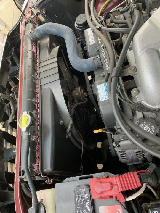

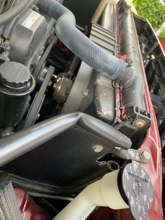

    Opened the hood tonight and noticed this. Checked on parts.toyota and radiators are discontinued? What the heck. p/n 16410-0C032?

    Yup. Good catch. OEM rads are discontinued but lots of reputable rads are available.
    OEM long life coolant is a good idea while you're replacing it. (needs to be mixed)

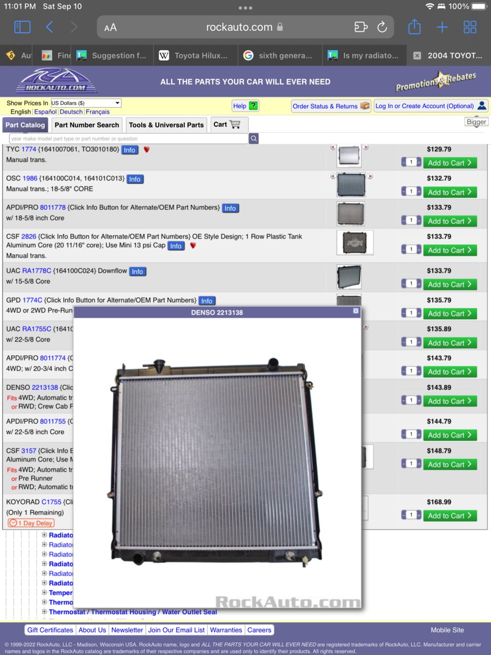

    Denso is who builds them for us.

    Harrison is the original manufacturer but has since discontinued it. I bought a denso and it works great. Don't toss out your original side brackets from the old radiator since it's common that the new bracket doesn't line up so you have to reuse the OE one from the old rad. Get new OE hoses too. I had fitment issues with both gates and dayco.

    Is it worth picking up one of those radiator pressurizer things and testing the radiator?

    Just get a new Denso radiator.
    Easy and affordable DIY job.

    I've always considered radiators a consumable part.
    100k is a good lifetime. Replace it and don't worry about build up and loss of cooling.
    A new radiator is $85 ish. A radiator flush cost $135. It's a no brainer. Toss in a new one (I've used them all, the only issue was packaging, broke drain valve on one). Shipping damage occurs on anything.

    I picked up the radiator today and interestingly it is a Harrison and the Toyota regional warehouse appears to have a bunch of them. Just in time as I now see a puddle of coolant in the driveway. [As an aside, I have noticed recently that a bunch of Toyota dealerships have been bought out and their ecommerce sites are not working the same if at all. They local dealership is now charging MSRP+ and the ecommerce didn't give me the normal discount. That all changed with a phone call.]
