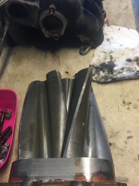

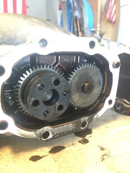

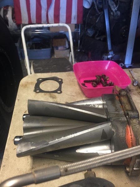

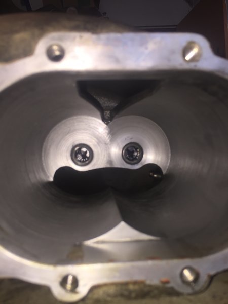

    Seems like the rotor movement wouldn't matter since they are in the rear bearings

  19. May 15, 2016 at 7:24 PM
    #59
    4Running Daily
    4Running Daily Long Live ZS
    Mar 25, 2012
    #75625
    8,702
    Connor
    Tempe/San Diego
    1996 Toyota 4Runner
    Looks good to me! A rebuild should solve all the issues.
