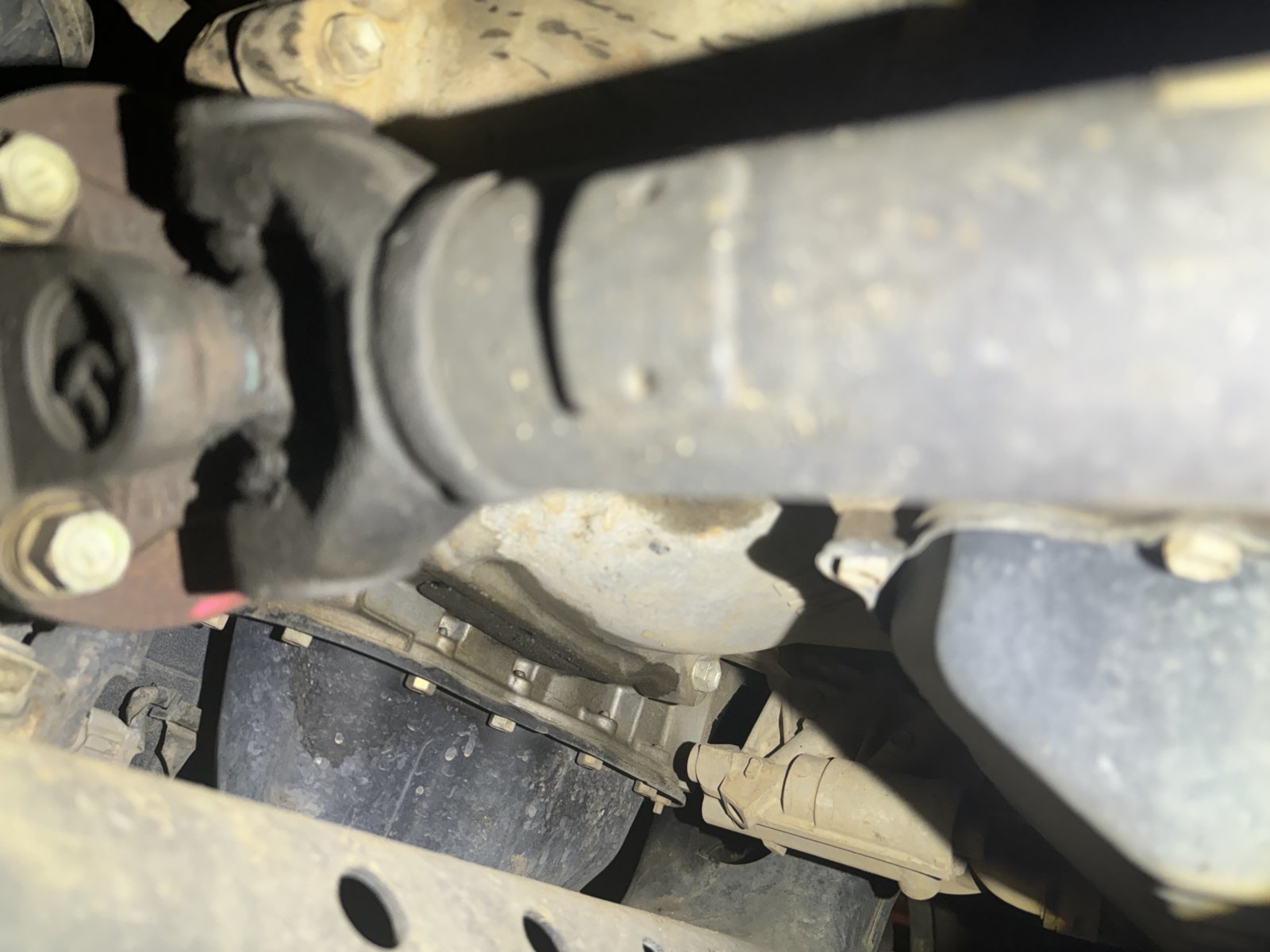

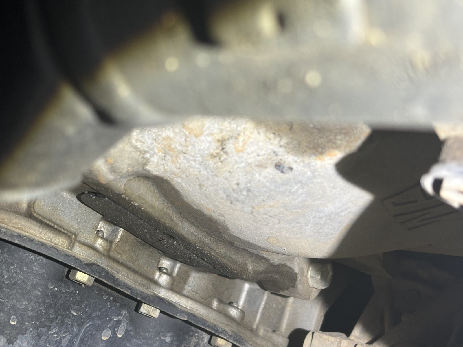

    I’m down here doing a drain and fill.
    I touched it and it’s dry and powdery.
    thanks

    Its probably just starting to seep.....

    I'd say more likely rear main seal vs the trans.

    It's most likely the rear main seal seeping. How many miles? Have you changed your PCV valve? If you haven't, I'd start there. Clean it off and recheck in a few hundred miles.

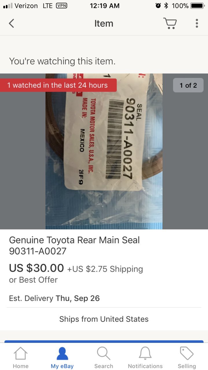

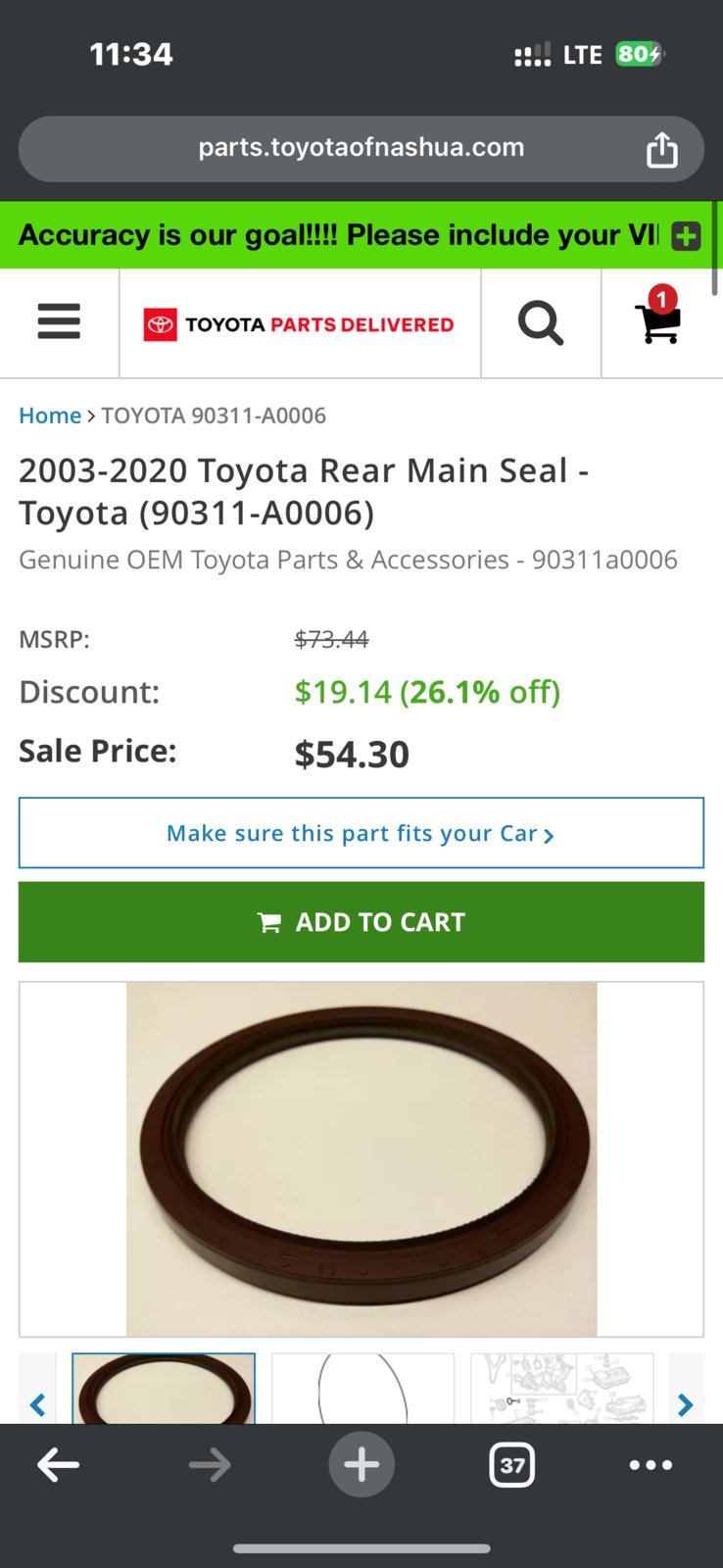

    Which one of these is the right part number for the rear main seal? Did they update it and make a better seal?
    thanks.

    90311-A0027 is what I come up with in the EPC.

    My 4.0 has had that same size dark spot right there for years. Hasn't gotten any worse so I'm not doing anything about it
    If it was a jeep or a Chevy it would be dripping liquid oil
    I'd let it ride. It's not even wet

    Yeah it felt more powdery and dry than wet.
