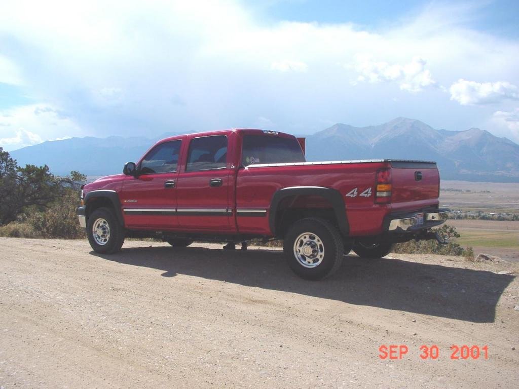

    This Piece of Shit was returned with the Lemon Law
    Lemon Laws vary from state to state but generally they have to be the same "recurring" problem that can not be resolved. In the case of the truck above the suspension was replaced 3 times with no luck. Still had a ungodly squeak / pop that you could actually feel. I towed a 27' travel trailer with it and did not feel safe at any time towing it. It took quite a while and had to go to arbitration but it was eventually bought back.
