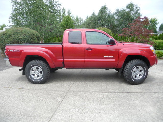

    5100's and a three lief pack work better than the single AAL.
    Fronts set at 2.5
    Tires are 255/85/16
    Yes, it works.

    2012 TRD Off Road V6 6 Speed
    Yes, I bought everything from Wheelers. Very helpful people and they steered my right.
